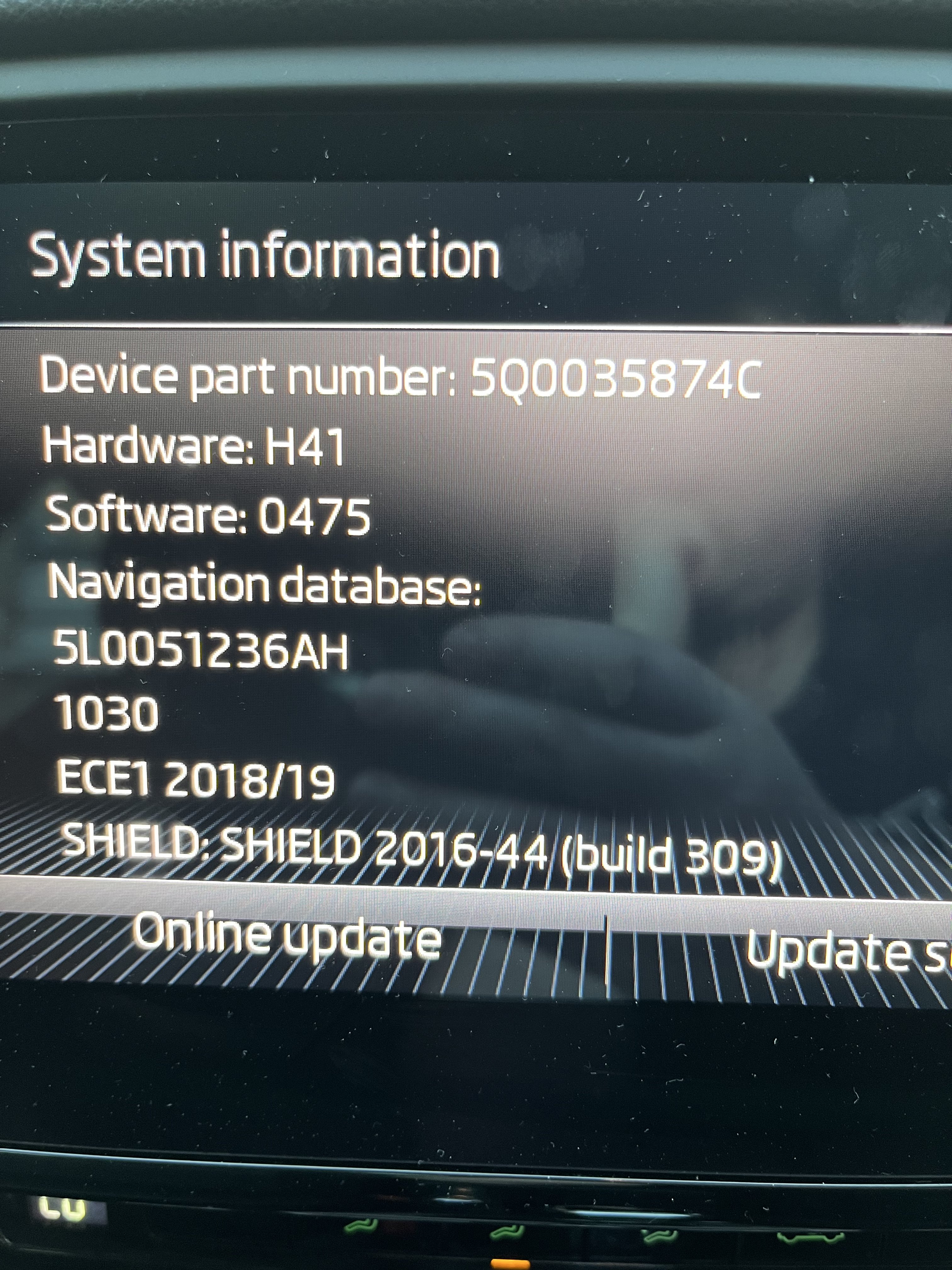

  2. Hi all, I’ve recently been having some strange issues with my infotainment system in my 2019 Mk3 Octavia. I pretty much only ever use it with CarPlay running Waze and some form of music/podcast app but recently the screen has been going blank and seemingly rebooting itself (though the Skoda logo doesn’t appear on screen) and once it has rebooted it fails to recognise my phone that is still connected. I end up having to disconnect the cable from both the usb port and phone before attempting to reconnect in the hope that it recognises the phone again. This works 8 time out of 10 but the other 2 times usually require me to turn off the ignition and remove the key. Sometimes this happens once in a 2 hour drive, other times within 5 mins of driving. Sometimes it doesn’t happen at all. For some context, I am using a iPhone 13, always up to date as its a work phone. No “dodgy” apps are used. Just the normal stuff like Spotify, Pocketcasts, Waze etc. The info from the infotainment system is shown below. Has anyone else had similar issues?

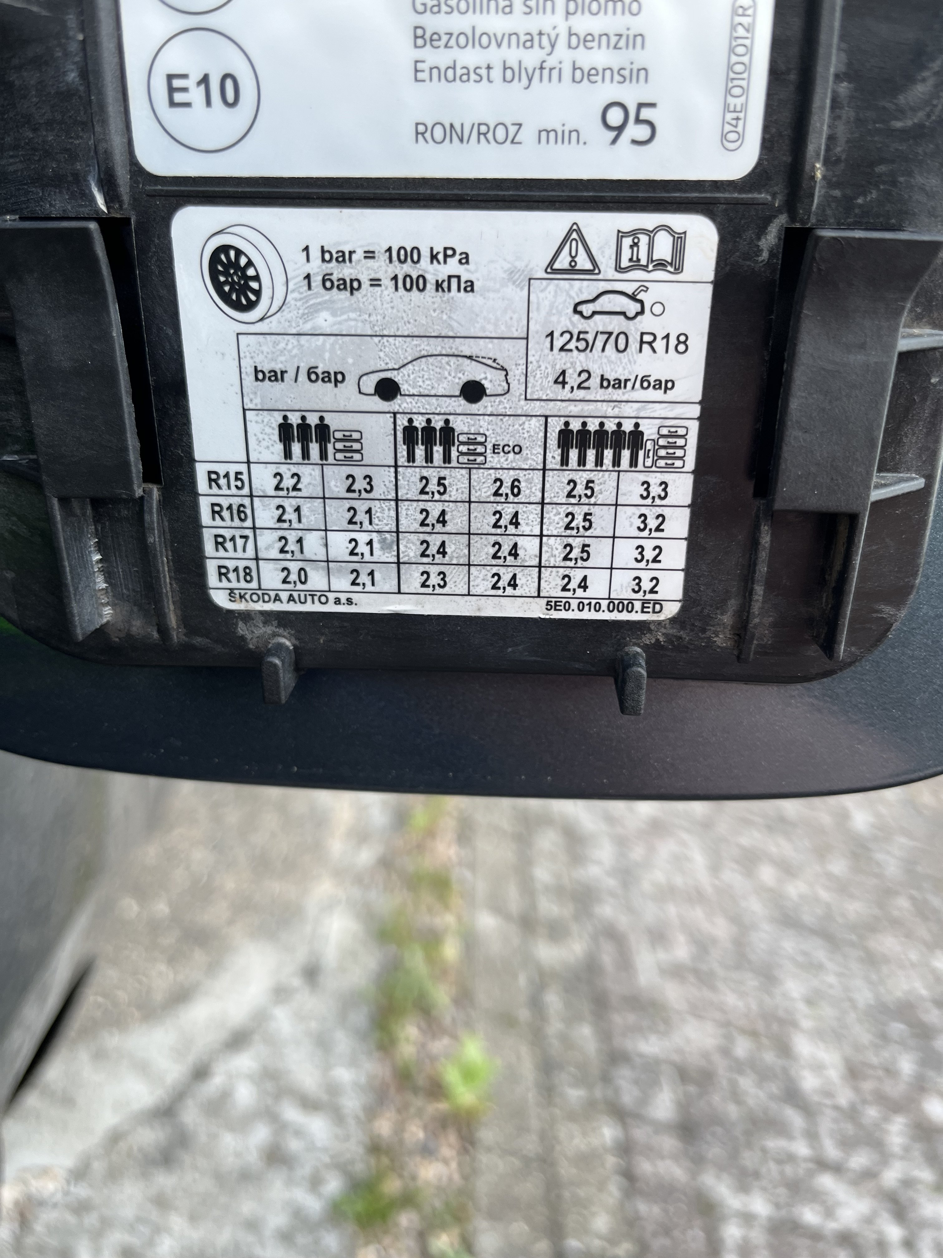

  5. Just wanted to update the thread. Went to a new local garage and had a chat with them. Ended up fitting 4 new Bridgestone Turanza A005’s. Ride quality and noise levels have improved slightly but not as much as I was hoping. Though I will say that I checked what pressure they put into the tyres. They for some reason have some 37 psi in the fronts and 35psi in the rear. Is this normal? Seems strange to me. Filler cap shows 2.1 bar (30psi) to 2.4 bar (34psi).

  8. Hi, what do you mean by 32psi (read 35psi)?
