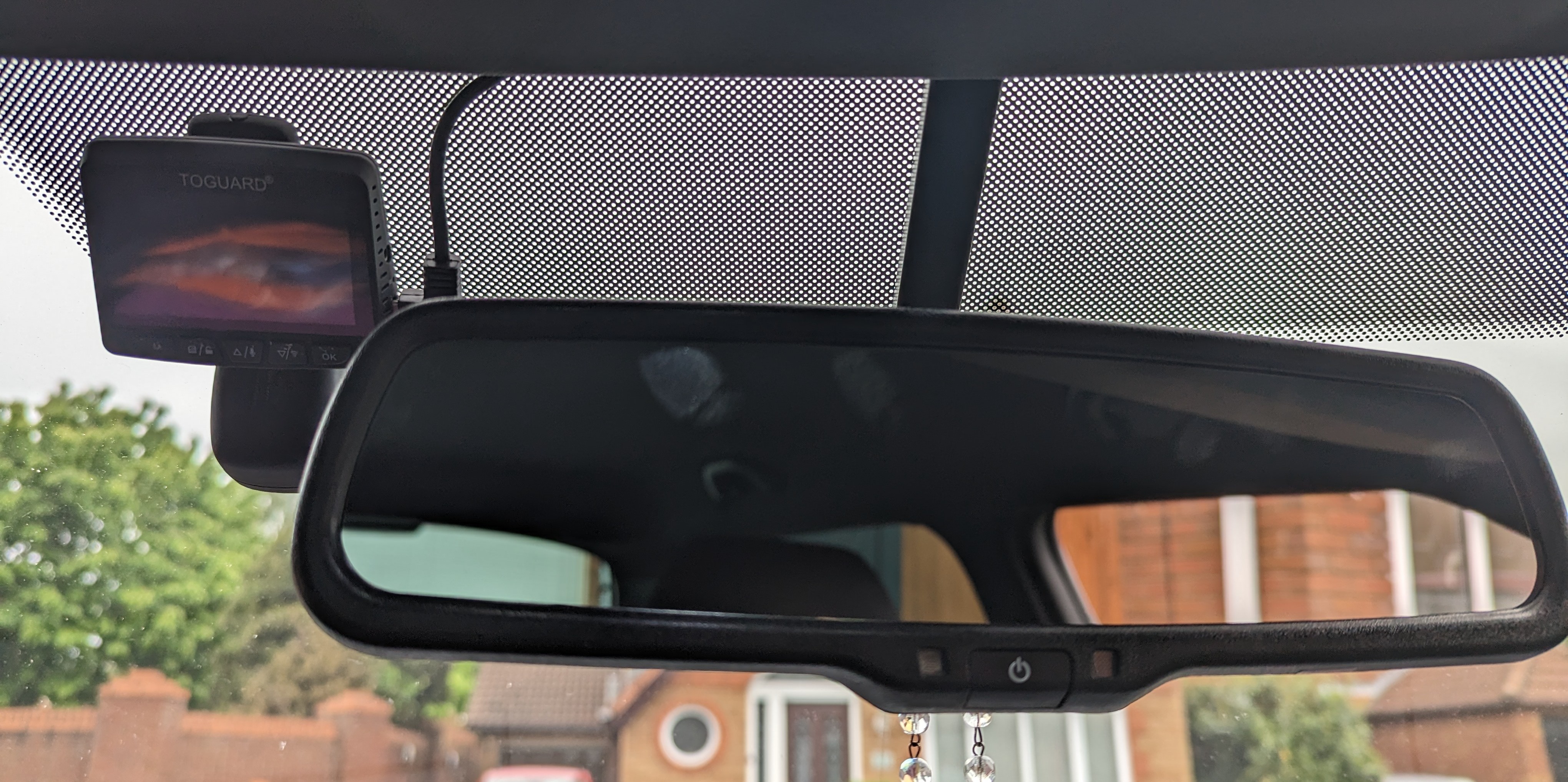

  15. Happy to report back I've successfully managed to fit the rear view mirror with thanks to all the advices provided by you all here 🙇‍♂️ Basically wired it to rear windscreen wipers piggy backing off the dash cam installation Bought the mirror here which came with all the bits (no need for the bracket adaptor)
