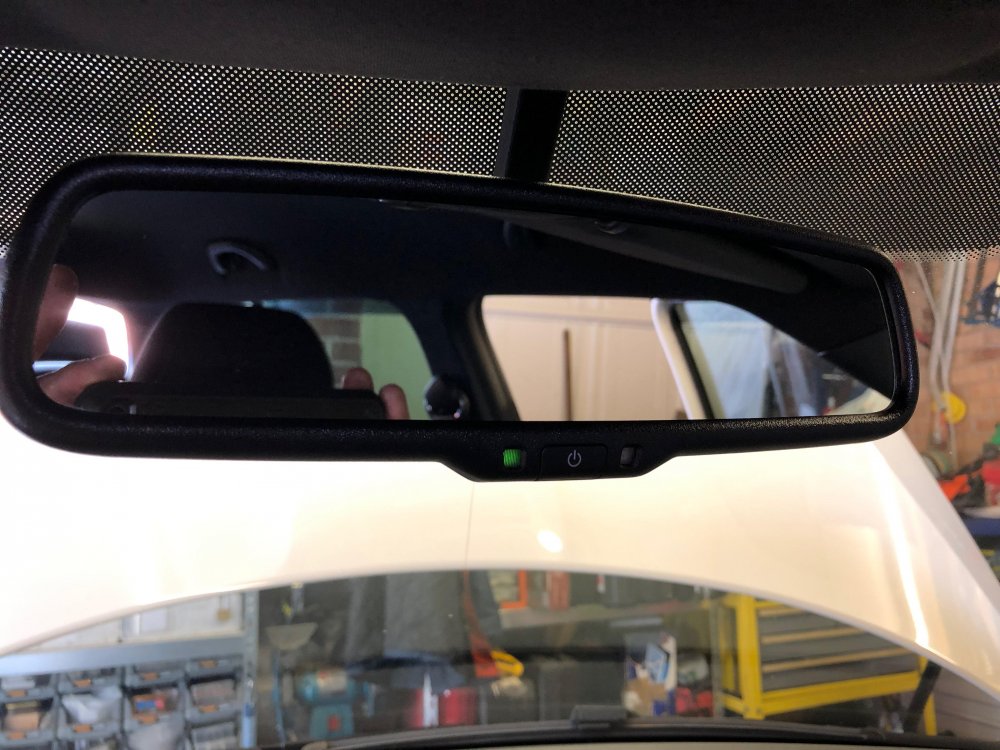

Todays little Mod -- Auto dimming rear view mirror
Don't know about you guys, but once you have had a vehicle with a self dipping mirror you tend to miss it.......and it's always annoyed me the fabia don't have one,
now there is one listed in the parts catolouge and I did think of gettting one of those, however I would not have had the loom in the vehicle, so would have had to purchase that + it most probably is quite expensive..............
If your not aware 99% of oem mirrors are made by Gentex, so bought one of those and a simple 2 wire installation and its all done, looks completely factory, you have to also buy the adpater to fit the VAG screen mirror mount and I wanted to hide the wire so bought the loom cover to.......................very pleased 😁 total about £90 ish...
The thing I do like is it has a button to turn itoff if you so desire.

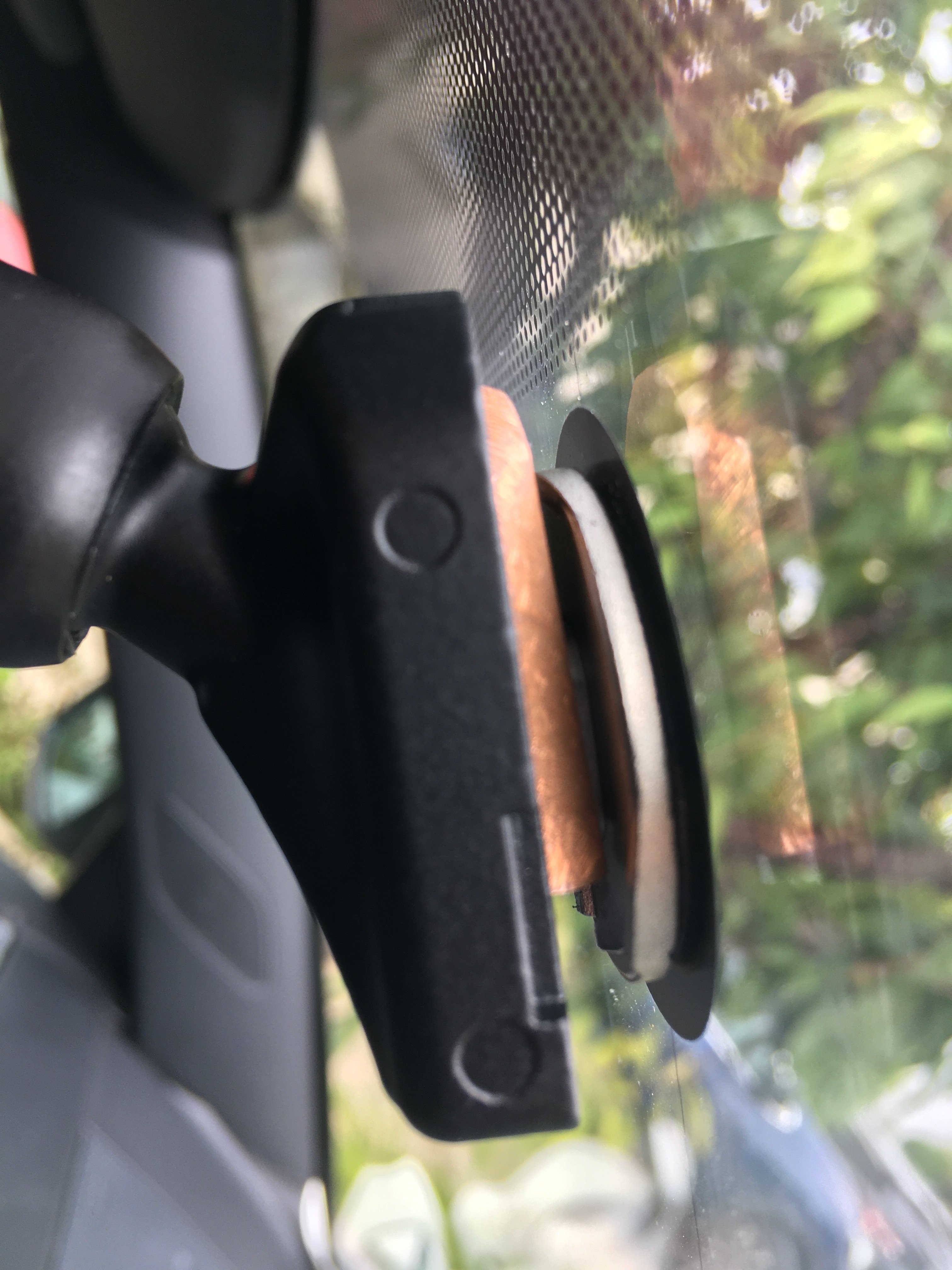

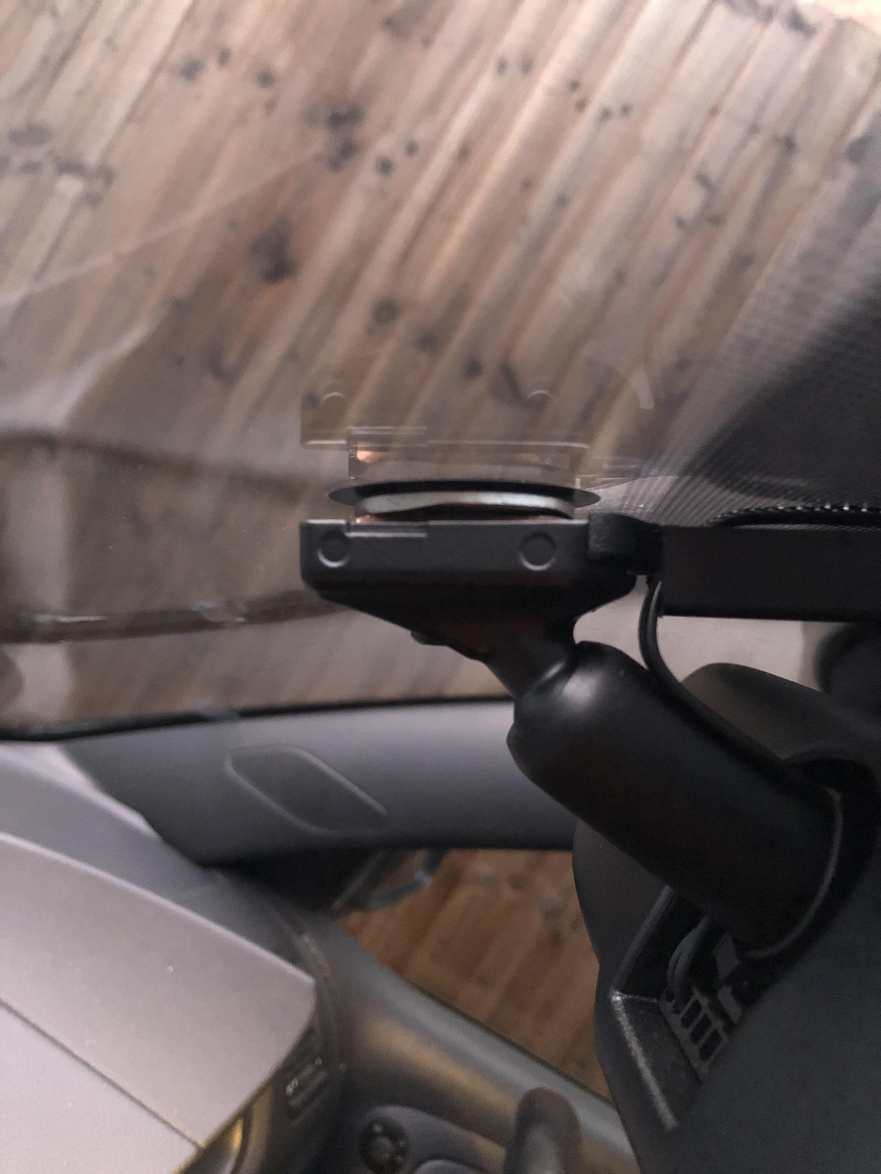

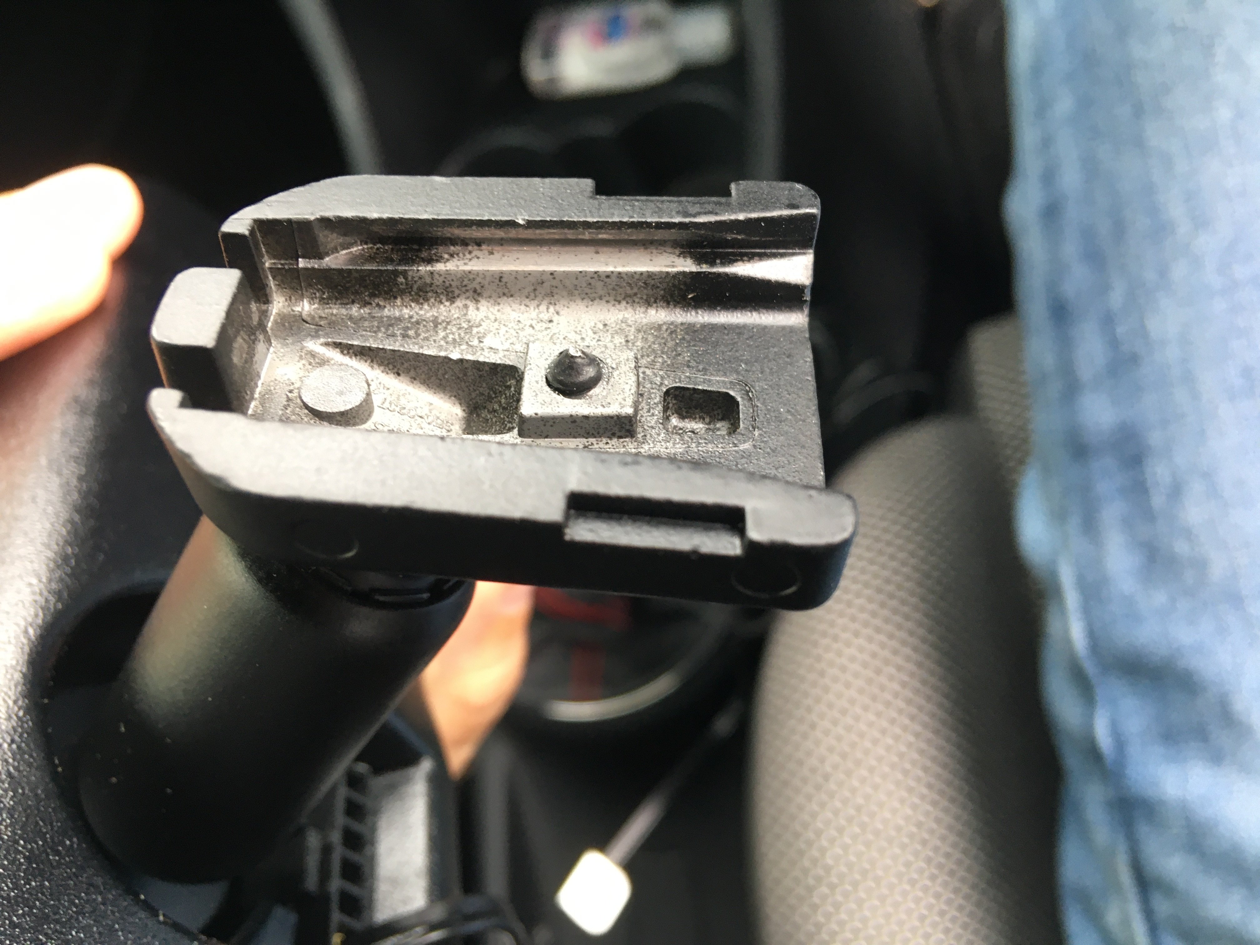

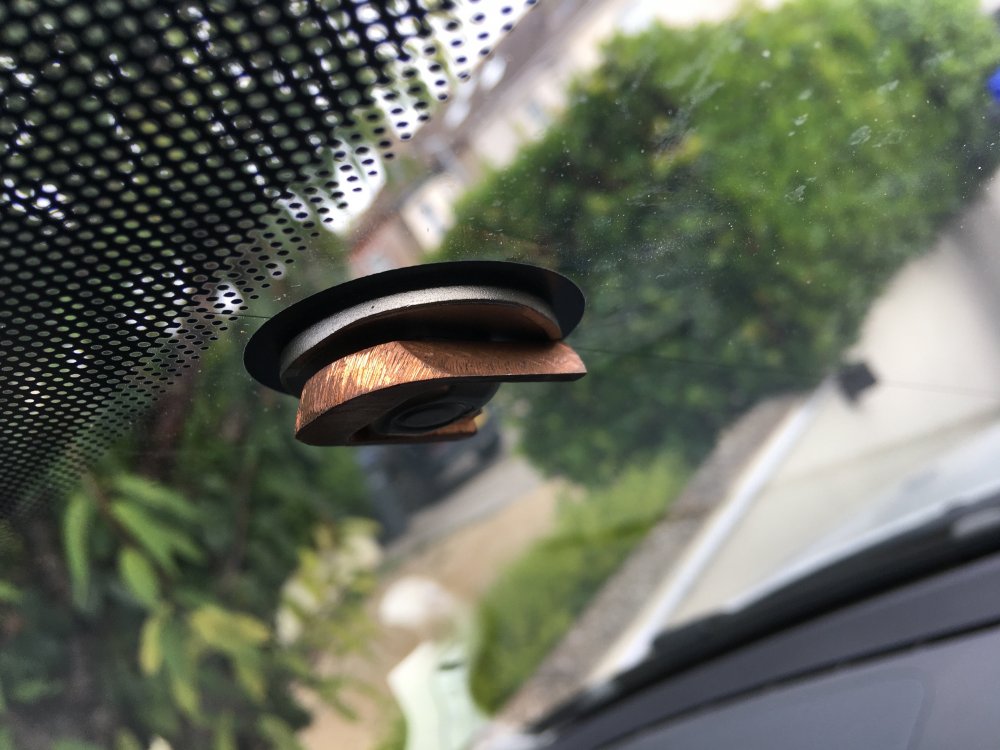

Is there any chance of a photo of you fitting the bracket?  Mine doesn’t seem to tighten at all, as if the torx screw is too short and it just dangles in the wind...  photo shows screw tightened up maximum when off.  The only way I can get it tight on windscreen bracket is by putting the mirror bracket half on so the torx screw tightens against the centre of the raised part of the Windscreen bracket, but it doesn’t seem secure.
Yes I only put it on halfway for now so that the torx screw has something to tighten against.  Looks like I need to get the file out on the brass bracket from that photo and make it thinner, I seem to remember greenstripe saying something similar.
i did wonder about one of the brackets from the USA, but will give filing a whirl first.
Edited by globalste
its def the fact the brass adapter is not "on" far enough........(see your edited image below)
look at the distance here where I have marked and compare to my image where you can see the brass adapter is much further onto the original mount.
It def does work no probs once the adapter is on. Take a good look and see which bit needs filing, its not much at all I would think, also when its "close" you can tap it on with a nylon or rubber hammer.

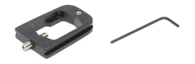

I fitted a Gentex auto dimming mirror.  None of the brackets fit the Fabia though so I then had to order an adaptor plate which actually came from the US via Amazon, I also needed to buy some stainless grub screws.
the Gentex ones aren’t really sold on Amazon uk anymore, but they make the VAG ones.  The mirror was £60 and the adaptor plate was £15. Then I got some windscreen cable shrouds for £5 off eBay to hide the wires from the roof to the mirror.
All in all, it looks good and was fun to do but was a bit of a waste of time mod in the Fabia.  Also, I had to faff a lot to get the thing tight and then use loctite on the grub screws.

Thanks @globalste, is it possible you can share what the adaptor plate looks like?

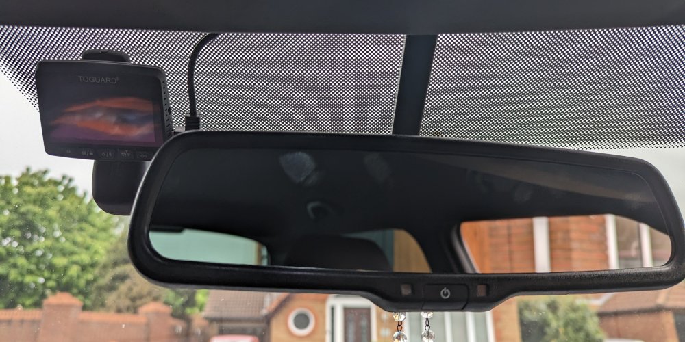

Happy to report back I've successfully managed to fit the rear view mirror with thanks to all the advices provided by you all here 🙇‍♂️
Basically wired it to rear windscreen wipers piggy backing off the dash cam installation
Bought the mirror here which came with all the bits (no need for the bracket adaptor)
