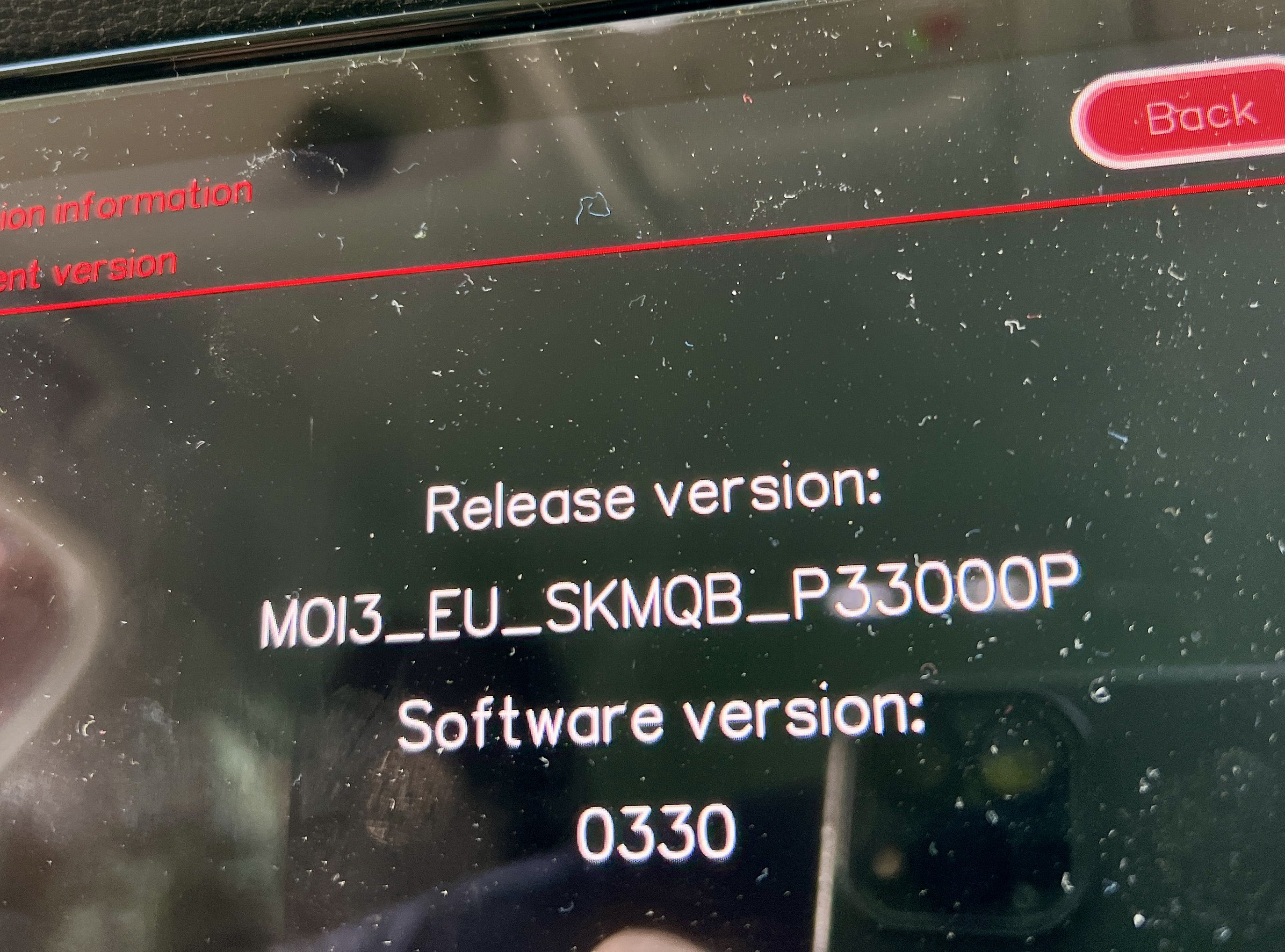

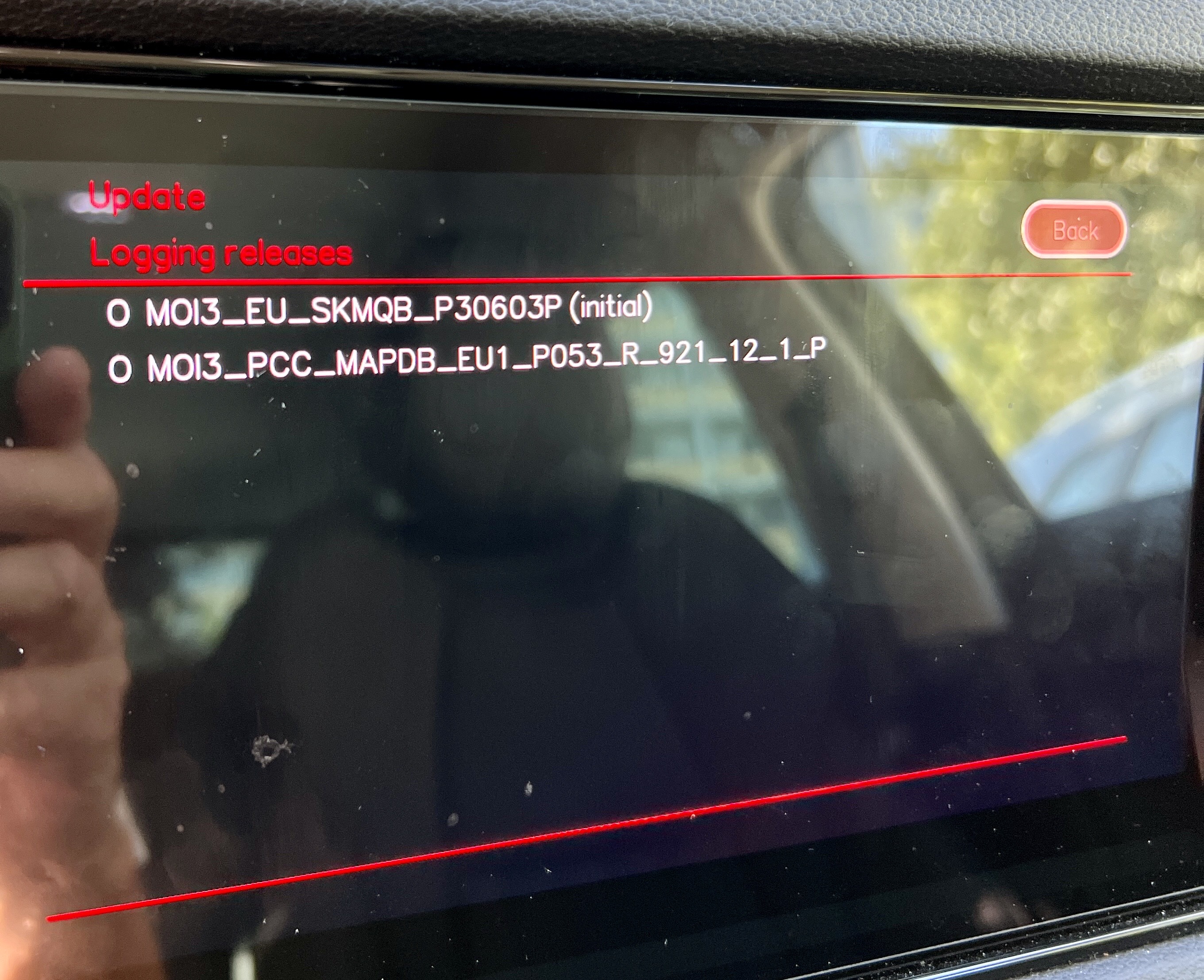

  3. That’s fine! Please check in the update menue if all in status are „legal“. Otherwise the OTA to 330 won‘t be possible…

  7. @anthony82 and @AlexB7: yes, you have to do that first. Otherwise you will have troubles in the OCU or you can’t install further relations of the software
  8. In addition: Mostly the new installation of the 330 starts few hours later automatically after having fully installation the 306 or 308 version
  9. @DaniC: Be carefully, first install the 306. Do not jump directly to 330 by installation
  10. OTA requires 306 in the minimum (normally only possible by a dealer from Skoda with an official transmission to the main server in the VW plant). This version is urgently needed for OTA following.
  11. In case the 306 or 308 is already installed in the system, the new 330 will archive automatically by OTA. 🙂
