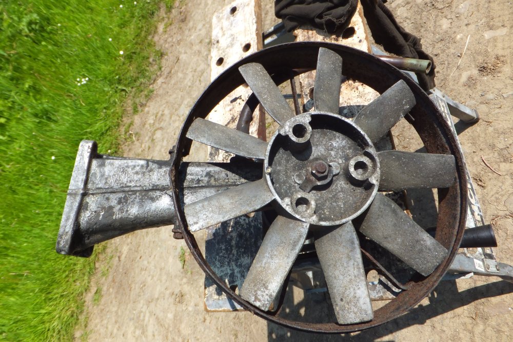

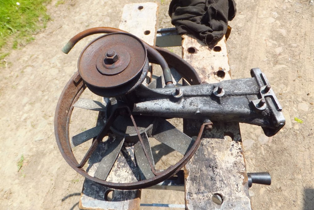

Does anyone recognise/want this fan which looks part of water system as it is hollow with feed pipe. Looks like the SKODA logo on the casting web.

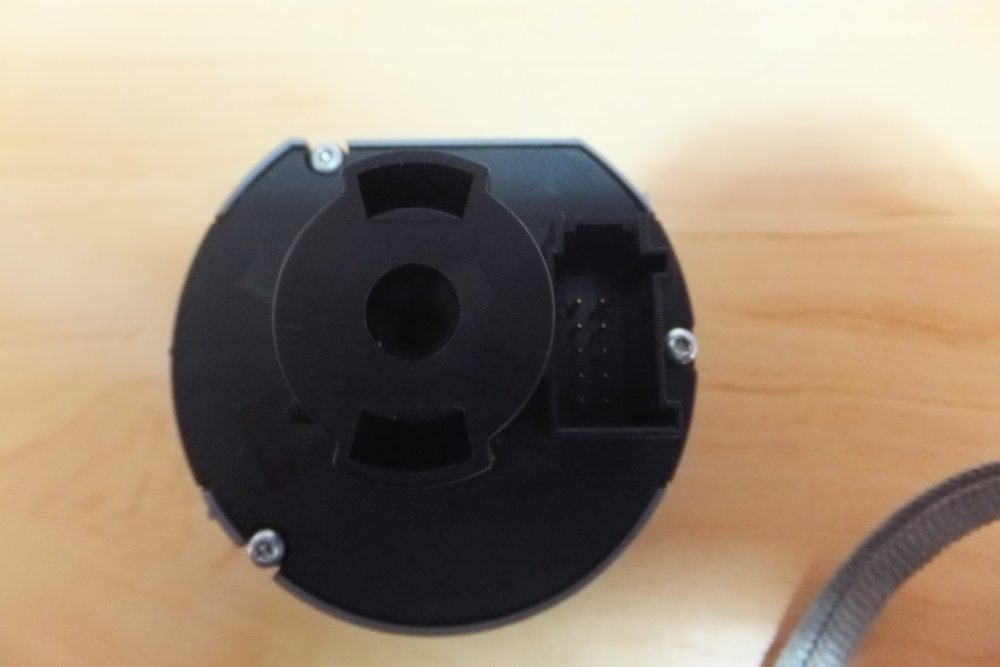

Thanks for your photos and being good enough to open up your switch again. My swich is 5LO 941 431 G. The problem I have is that having taken out the 3 screws in the base the base does not come off. It seems to be still attached to something and when you try to pull it off it still seems to be attached by a spring to the main body.....pull the base out a bit and it springs back when released. Is there anything else to be prodded once the 3 screws are removed to get the base off?? Looking down the 2 slots in the turret that sticks out the bottom (turret part of switch base) I can see that there is a fairly strong spring coiled round the inner part of the turret. That must be the spring you push against with switch in off position to then twist to release the 2 tags to remove the switch from the dashboard. Dennis

Frenchtone You say 3 bottom screws out and bottom just comes off. As you can see from my above remarks my one seems held in place by a spring.......are/were you able to see why that might be when you had yours in bits? Did it take much force to remove the bottom plate? Any photos of innards? Anyone any photos of innards? Dennis

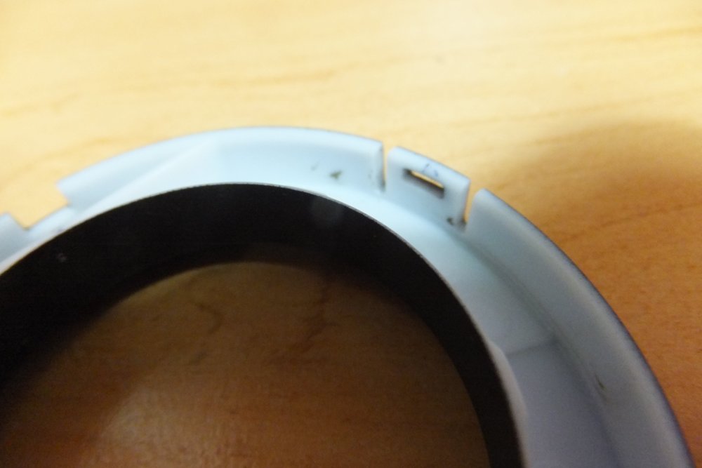

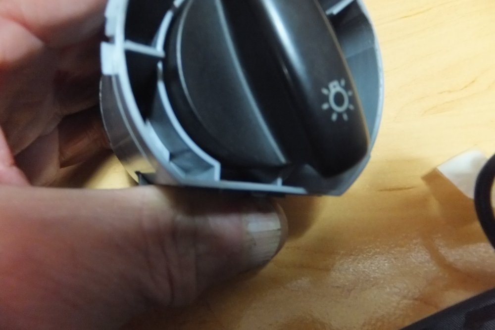

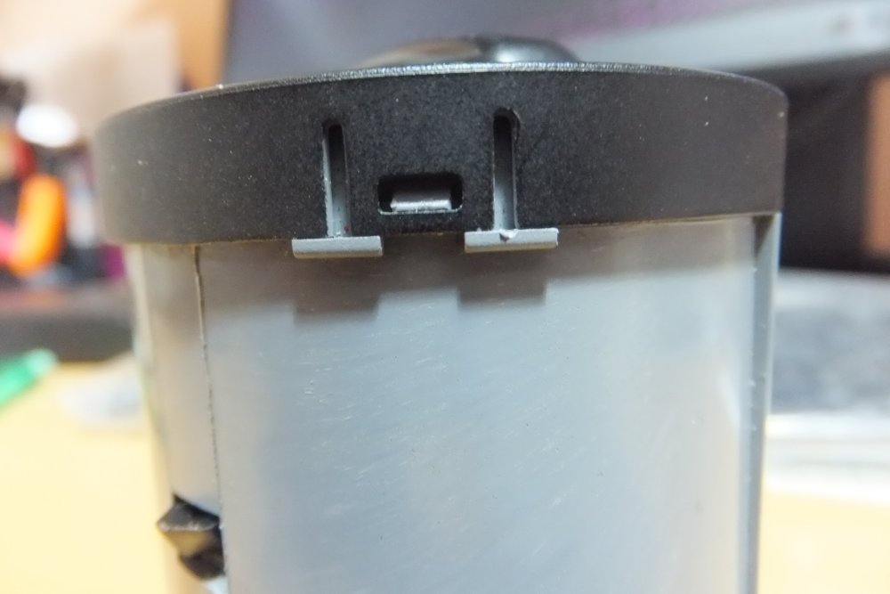

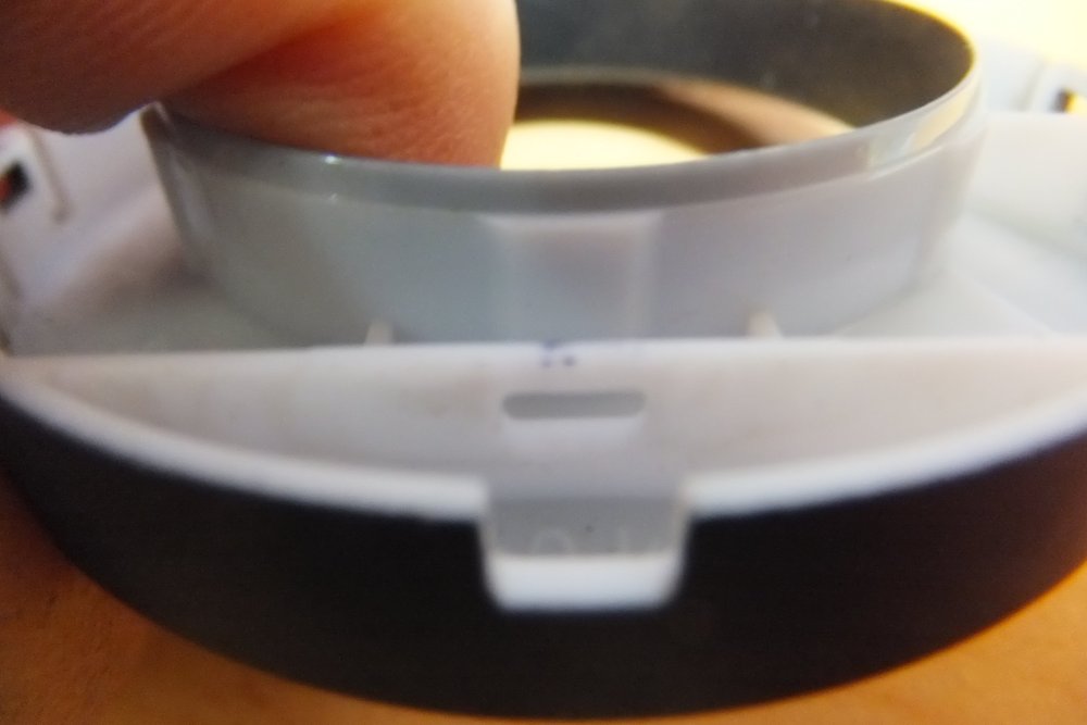

Now managed to get time to have another look at switch. 1. The 3 screws on the bottom of the switch removed with T6 screw driver. The bottom does not just come off to reveal the circuit boards as someone previously suggested. Pulling on the bottom bit pulls it out a little bit but it is spring loaded and springs back. That is with switch turned to off position. Turned to side or head the bottom bit does not spring out even a little bit. 2. Became bolder and with small flat screwdriver I prised under and twisted at the 3 small tags + 1 round the bezel (photo 2). You have to prize under the light grey part of the bezel, not just try to lift the black rim. Also where the flat is on the body there is another tag that needs to be levered up then the bezel can be lifted off. But still none the wiser how to get any further. 3. looking into the top I can see that the switch would have to be in the sidelight position for the overhanging switch knob to pass down through a cut out channel in the body. (still no pull out function possible for fog). So where to go from here???

I thought the TORX went down in size by a factor of 5. Hence thought next size down from 10 was T5 which is why I ordered T5 bits. But when received they were far too small. Found tables that give specification sizes for TORX (alternative name is STAR) , distance across points being one measurement but my poor old eyes found it too difficult to get a good measure but around 2mm. Ordered a set of 6 cheap screwdrivers - T5, T6, T7, T8, T9, T10 - arrived today and it turns out T6 seems to be the size that fits (not T7 that I thought my point to point measurement indicated). Can anyone else confirm T6? Would still like to know order of dismantling to get at innards to see what may be causing the stiffness in turning the switch. Does the top rim have to come off....3 little tags in photo 2....don't seem to have enough hands to hold all 3 in at same time......or can you just pry the very flimsy looking black lip on each over the grey tag and it will stay clear so escutcheon can be lifted off over the switch knob? . Does that bit even have to come off to get at bits that might be causing lack of rotation. By the way WD40 Water Dispersent formula 40 will leave an insulating residue on switch contacts (bad experience on a ship when a junior sprayed inside several boxes containing many largish relays causing much malfunctioning of communications system such that very very many relay contacts had to be individually cleaned. Dennis

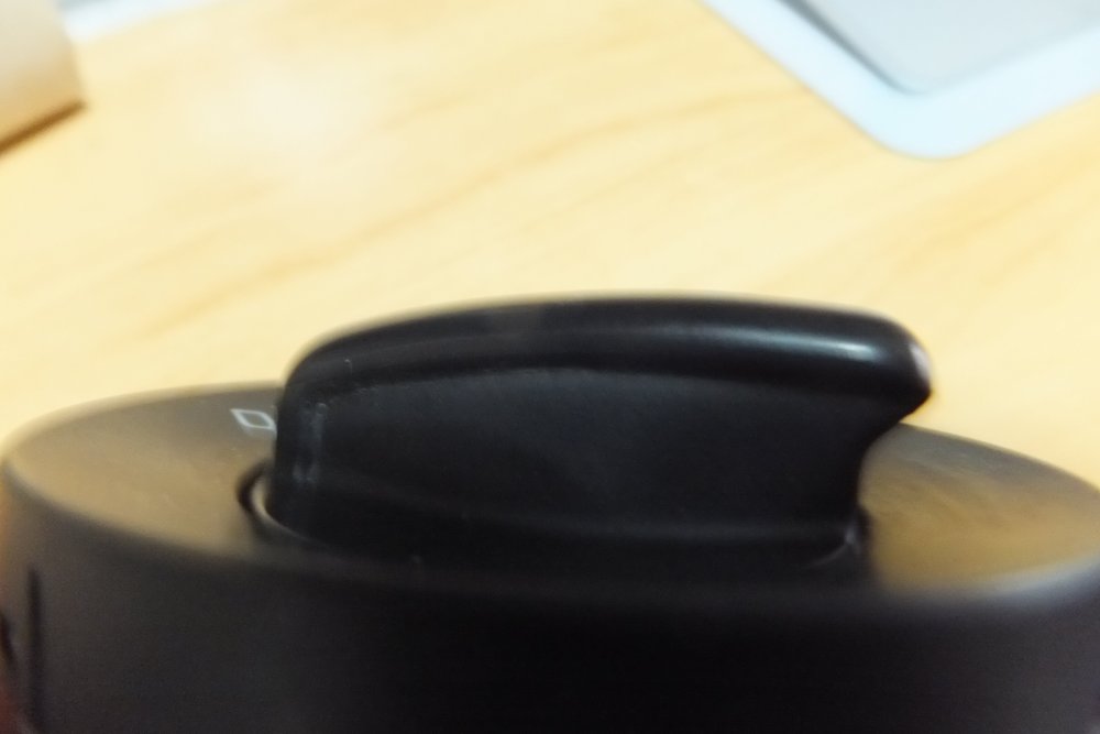

New switch (second hand) received and fitted and all lights working again. Removing switch from dashboard was a bit touch and go as push in and twist in off position proved rather stiff! Now I would like to dismantle switch to see if can free it up, so questions:- 1. 3 small Allan key screws on base - what size key? I have many but can't find one that seems to fit well. 1/16 inch too big, 1.5mm too small 2mm too big. (Using calliper to measure across flats and readings on allan key pack holder) 2. Once undone does whole innards just slide out and will there be any bits falling off (springs/ball bearings etc)? (will dismantle inside a plastic bag to catch any bits) 3. 3 little tags around side of top rim - does rim have to come off first (can see knob slightly sticks out over rim so may prevent innards with knob from just sliding out the back once 3 screws removed?) Does black rim just prise over the grey tag? (spudger poised) 4 What exactly is the order of opening up and striping down? Once achieved will do write up with details and photos. Would be really good if someone who has done it could give details and maybe pictures to help me achieve fixing without wrecking switch. Dennis
