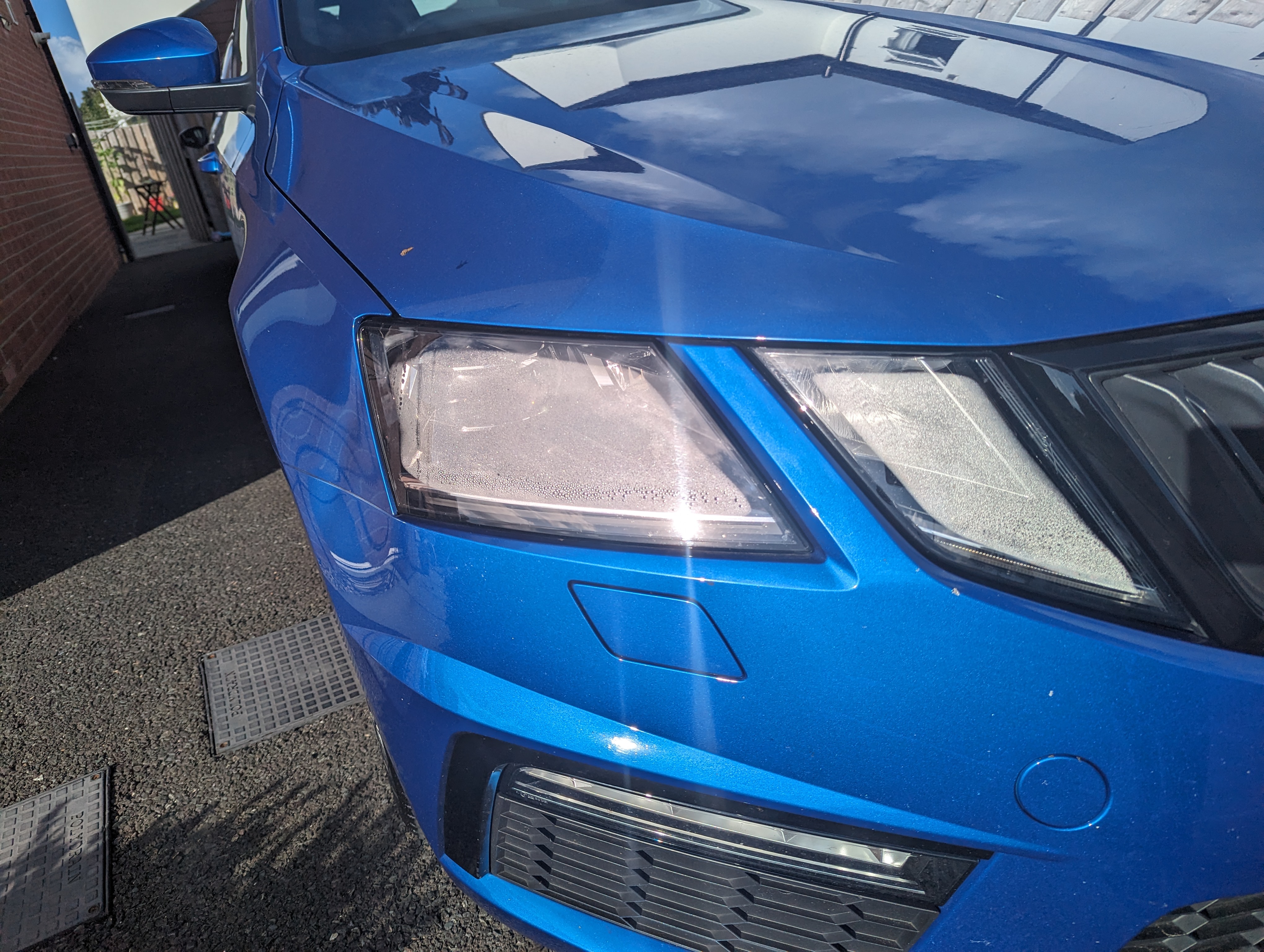

  8. No it still fogs up after a heavy shower or after I wash it, nowhere near as bad as what it was though. Been meaning to get the bumper off and remove the light for a closer inspection but haven't got round to it yet

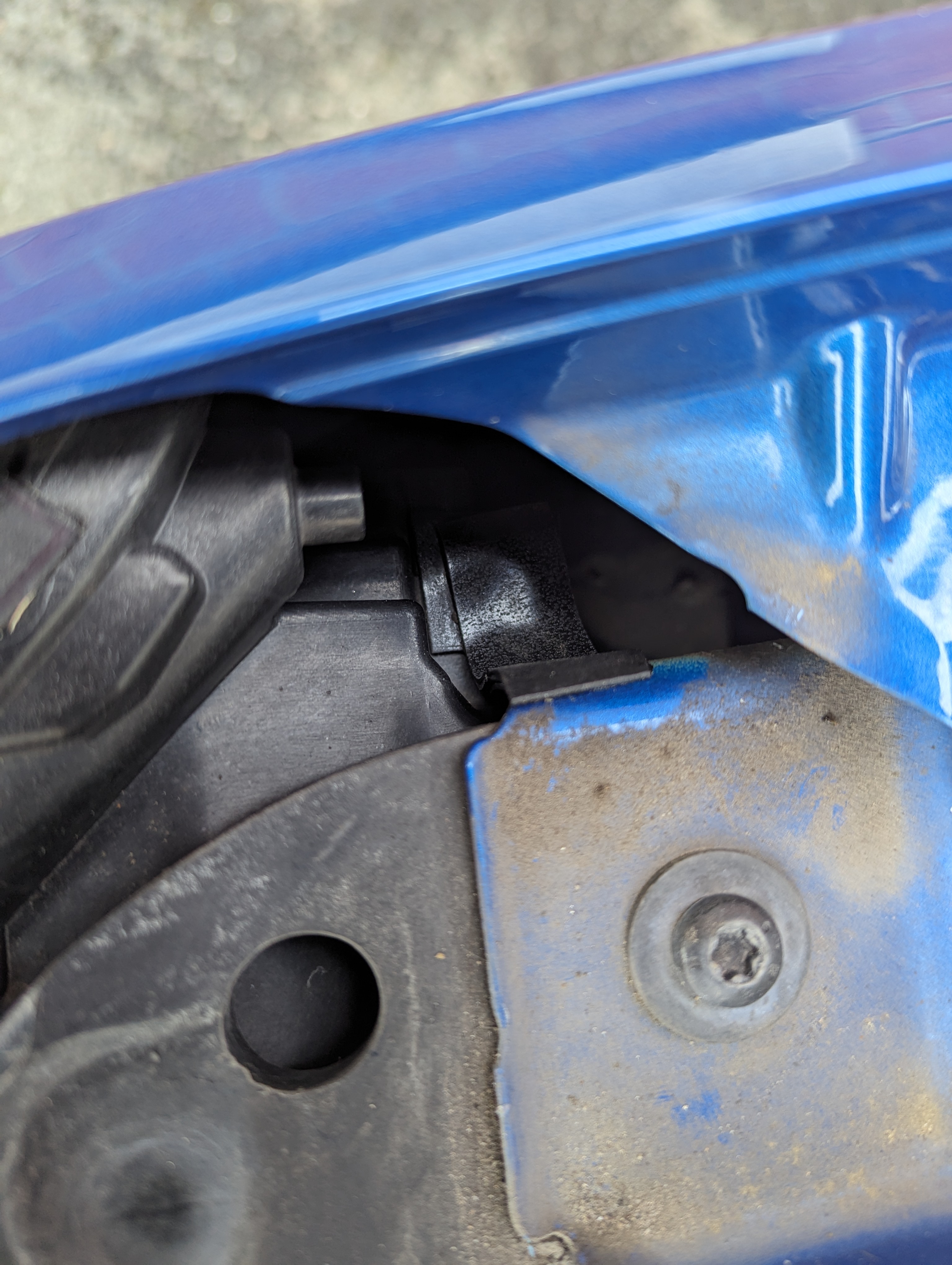

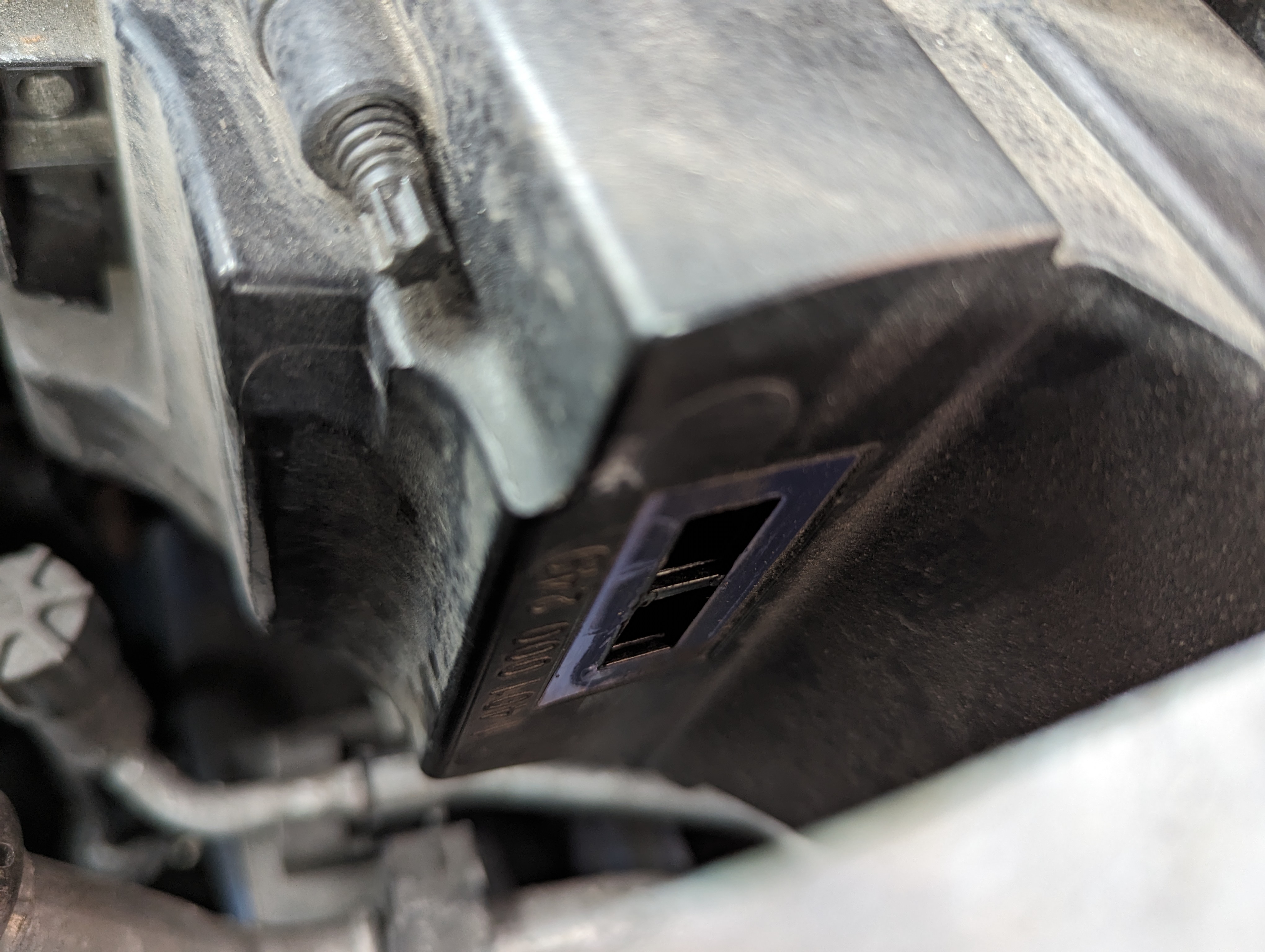

  9. Just to add an update to this, I was told about a little black sticker in the back of headlights you can remove that opens up 2 square holes in the back of the lights to allow air in and moisture out. I also noticed that there was some water lying on white hex screw adjuster on the light directly below the gap on the wing and bonnet. Applied a little bit of rubber mastic tape over it to try and divert the water. Not sure how much of a difference that made. But so far so good. There's been some heavy rain showers here since and not a drop of condensation in the light since. I'll add a bit of tape back over the holes and see how that goes.
  10. Hi folks, anyone ever found a cure or cause for water getting into the headlights? From reading up on previous posts, I can only see that it was a warranty issue and was replaced by dealers. My driver's side one is deadly for it after washing or heavy rain showers Many thanks 🙏
