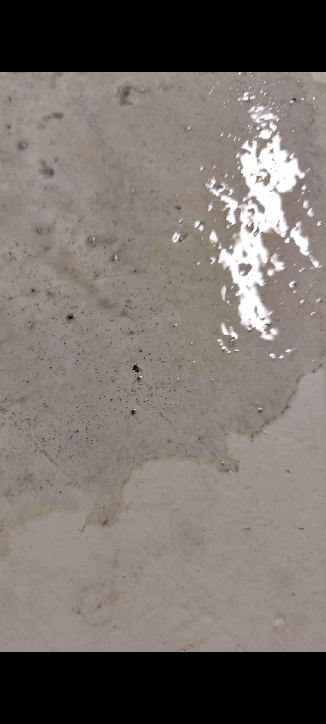

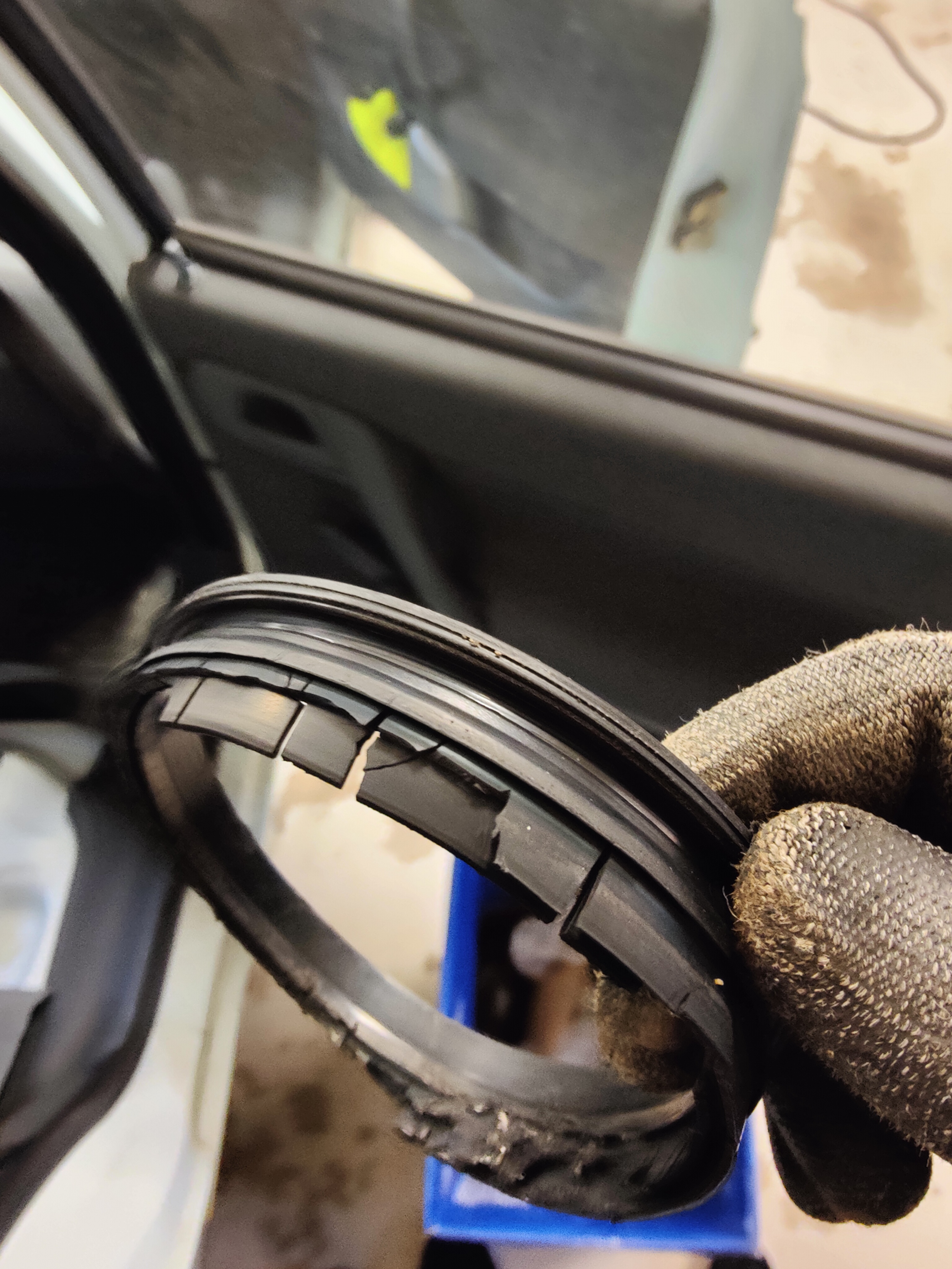

rustfreefelly replied to rustfreefelly's topic in Skoda Favorit, Skoda Felicia, Skoda Fun and Skoda FormanHi everyone! I finally managed to get my felly to run again! Fuel tank sealant was in really ruff condition. There was parts of the sealant in the tank and the hose to the fuel filter was full of ****. There was some parts that wears off with time, and they seemed to be original, so i changed them too. I changed the tank sealant, fuel filter, distributor cap, rotor and plug wires. Also found a whole injector unit with all the parts pretty cheap and really good condition, so i bought it and changed that part too, because earlier i couldnt find even a spare injector for my felly π. I think the main problem was the **** in the fuel hose, and fuel pump couldnt keep up the needed pressure. Anyways, im pretty happy i got the car running at last π Thanks to all of you guys for help and tips for the car! Here is a photo where u can see how dirty the fuel was before fuel filter. And the condition of the sealant.

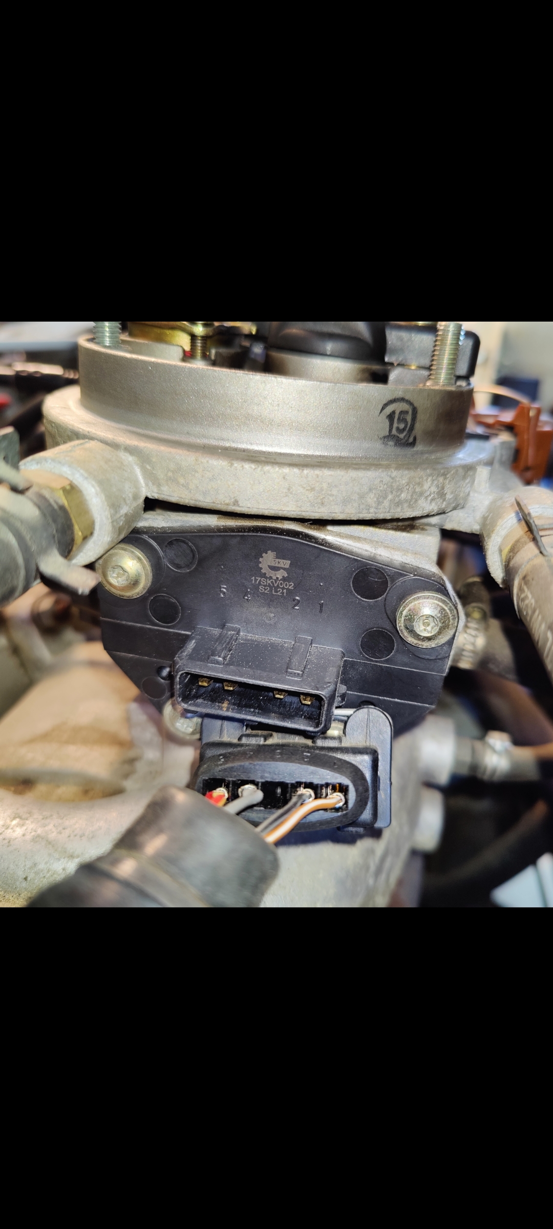

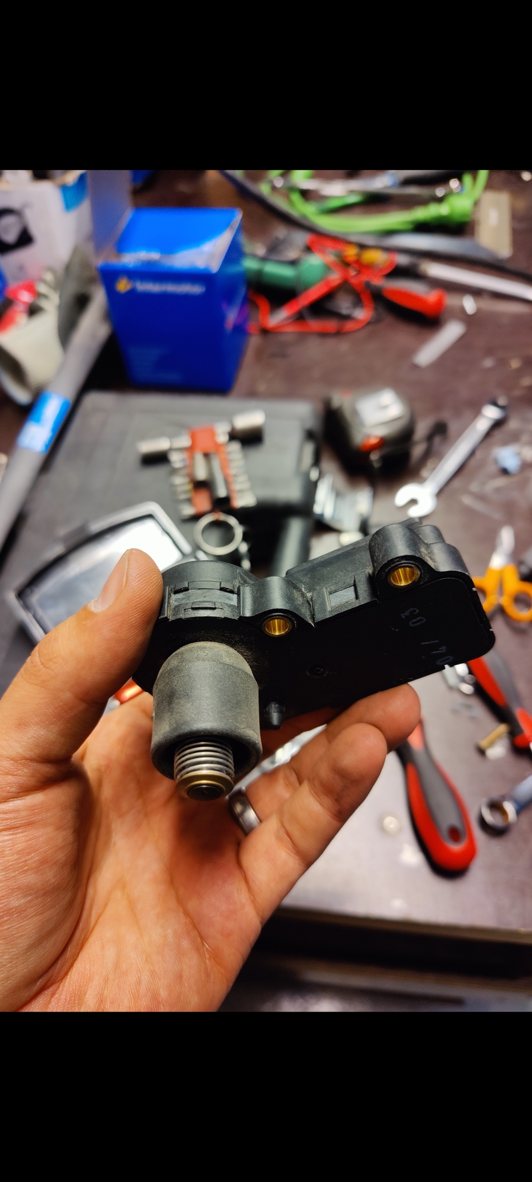

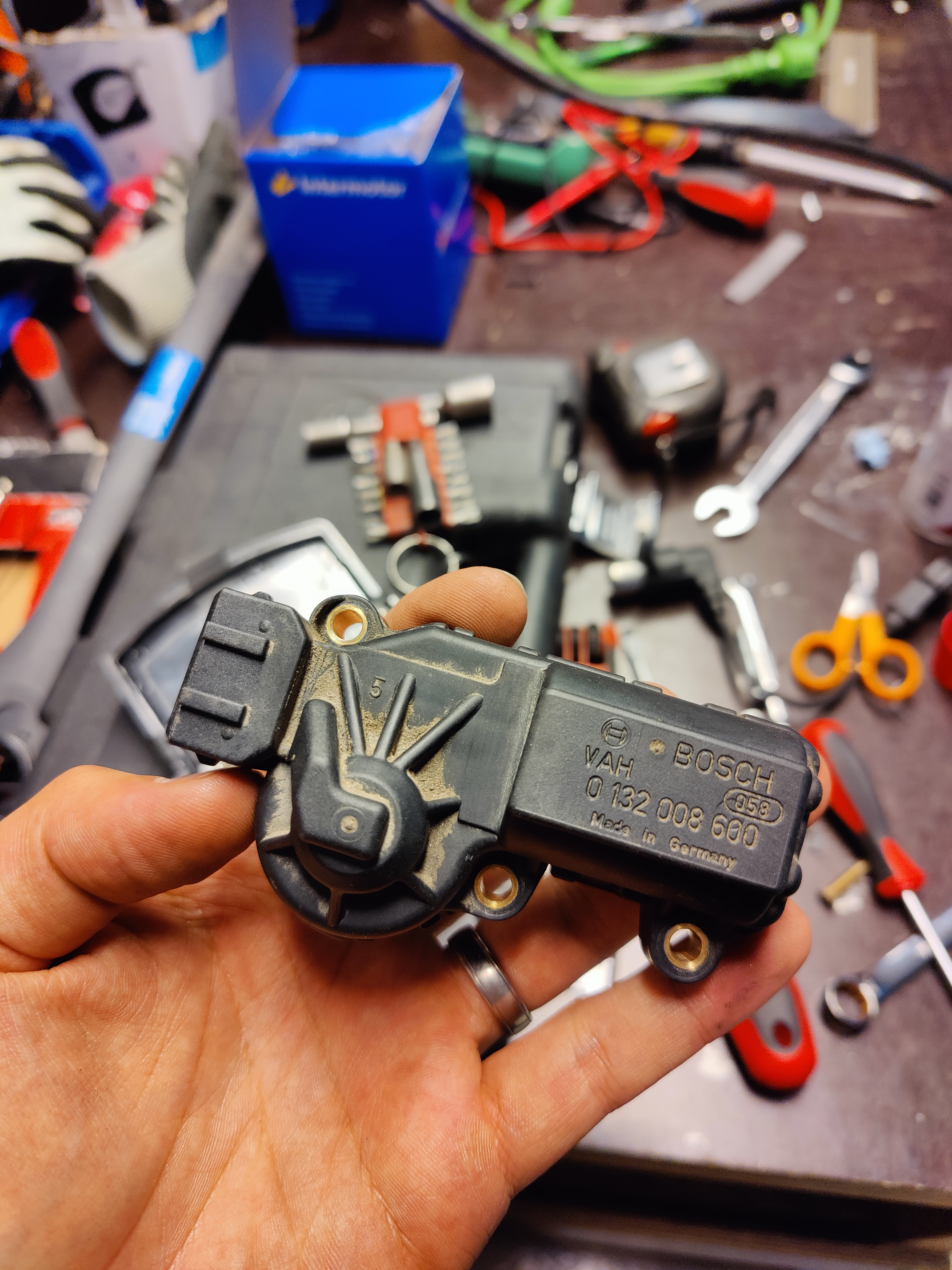

rustfreefelly replied to rustfreefelly's topic in Skoda Favorit, Skoda Felicia, Skoda Fun and Skoda FormanHi, I have this older throttle body on my felicia. I have these two parts attached in my TB. The first one have been replaced in the repair shop. And maybe one stupid question once again, but should vcds work on my felicia? or should i use the old vag-com?

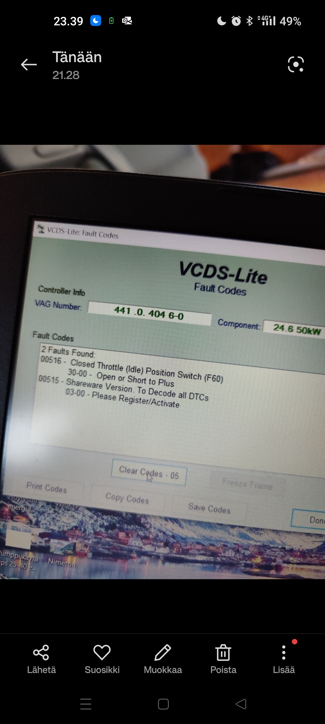

rustfreefelly replied to rustfreefelly's topic in Skoda Favorit, Skoda Felicia, Skoda Fun and Skoda FormanYeah.. i can tell that you are totally right. Now i feel really stupid, because i have been fighting with that code + trying to find functioning vcds. BUT also the mechanics at the repair shop didnt know how that fault code works π Anyways, i have now checked more parts, i did get a new ignition coil, because the old one was cracked. Also i bought new temperature sensor. I changed the parts, started the car, but same problems occurs. But now i got a new fault code! 00516 - closed throttle idle position switch F60, 30-00 Open or short to plus. Tomorrow i have to start figure out where this position switch F60 is π i just hope that i am not breaking the car more while im trying to fix it, because i get new fault codes.

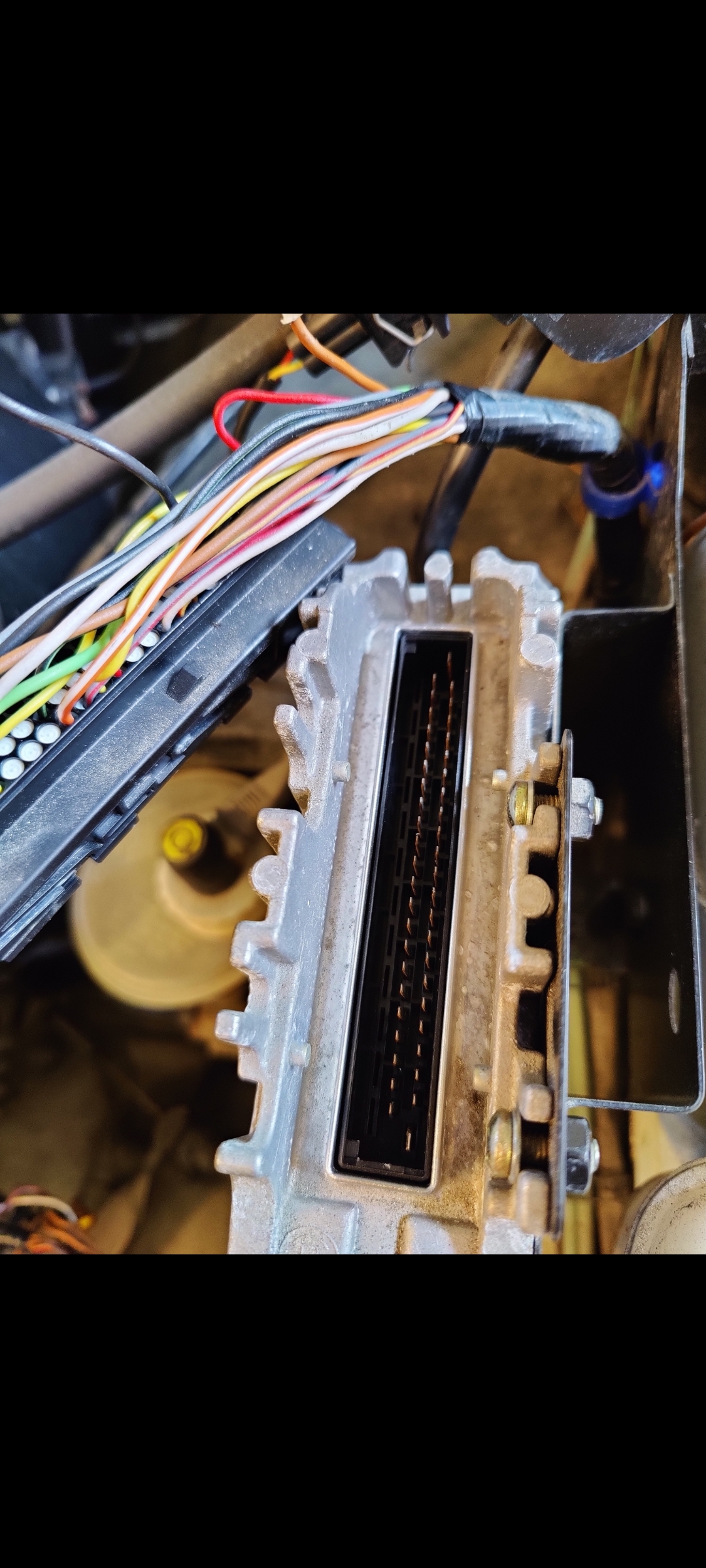

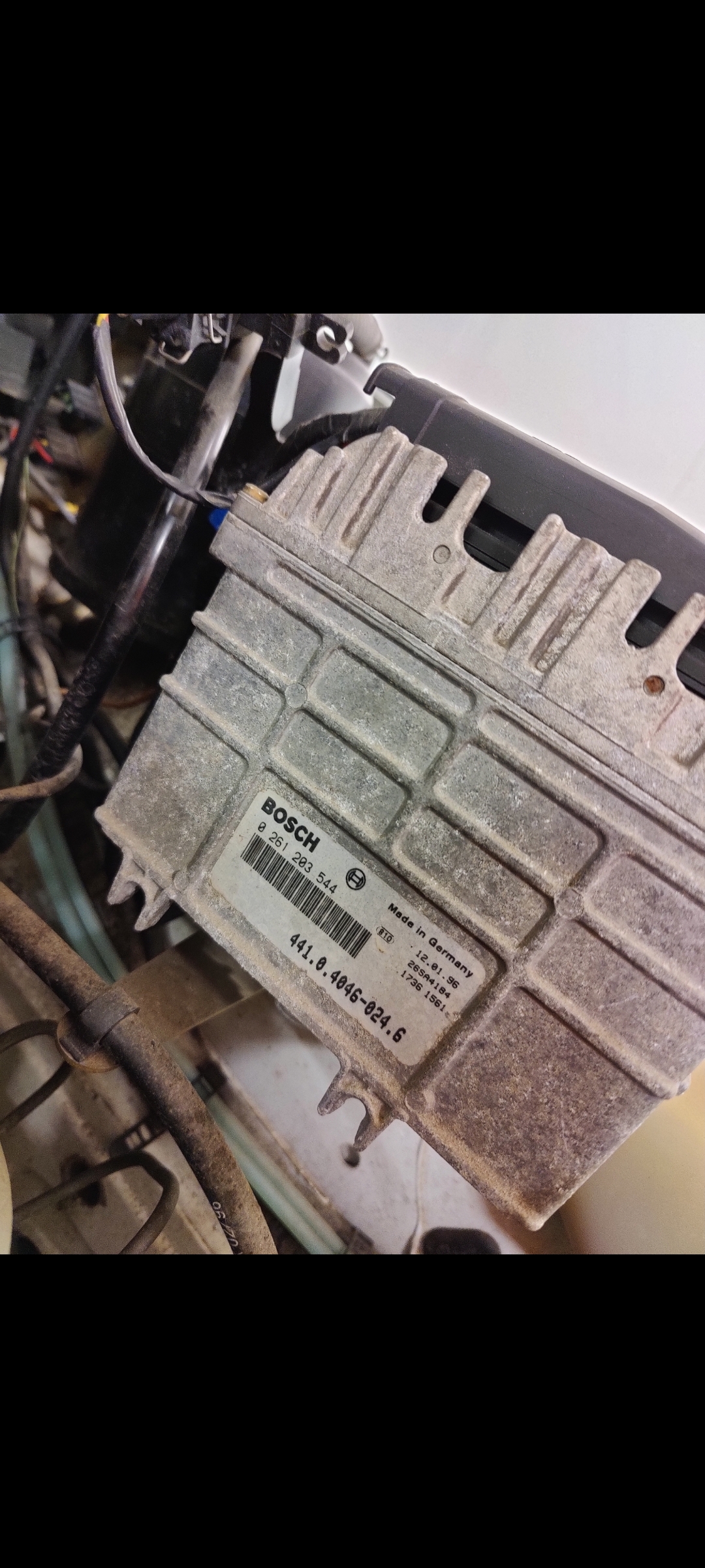

rustfreefelly replied to rustfreefelly's topic in Skoda Favorit, Skoda Felicia, Skoda Fun and Skoda FormanLooks like i dont have the immobiliser? This photo is about my original ECU, because i have those plastic parts at the corners?

rustfreefelly replied to rustfreefelly's topic in Skoda Favorit, Skoda Felicia, Skoda Fun and Skoda FormanWhen all these problems started, i was driving maybe 100kmh at the highway. The car just shut off and my trip ended there. If this problem is about the immobiliser, can i check it somehow with vcds-lite? Are you sure that i my car has immobiliser? Here is a photo of my ECU. Can you say with those part numbers, is there an immobiliser? Also can i somehow "delete" the immobiliser if its necessary? π And thanks already for your reply. ππΌππΌ
