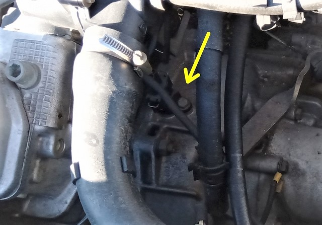

Hi guys again! I havent got the felly fixed yet. Friend of mine told me that sometimes ecu can give fault code about crankshaft sensor, but really the problem is the camshaft sensor. Now comes the stupid question: can you guys tell me where the camshaft sensor is in skoda felicia 1.3 SPI? 😂
Hi, i have found that crankshaft sensor in the photo. But i was wondering where the CAMshaft sensor might be, or does Felicia even have one?
There's no camshaft sensor on the 1.3 engine.
Also, have you tried another sensor? I know you changed it once, but new doesn't necessarily mean good.
