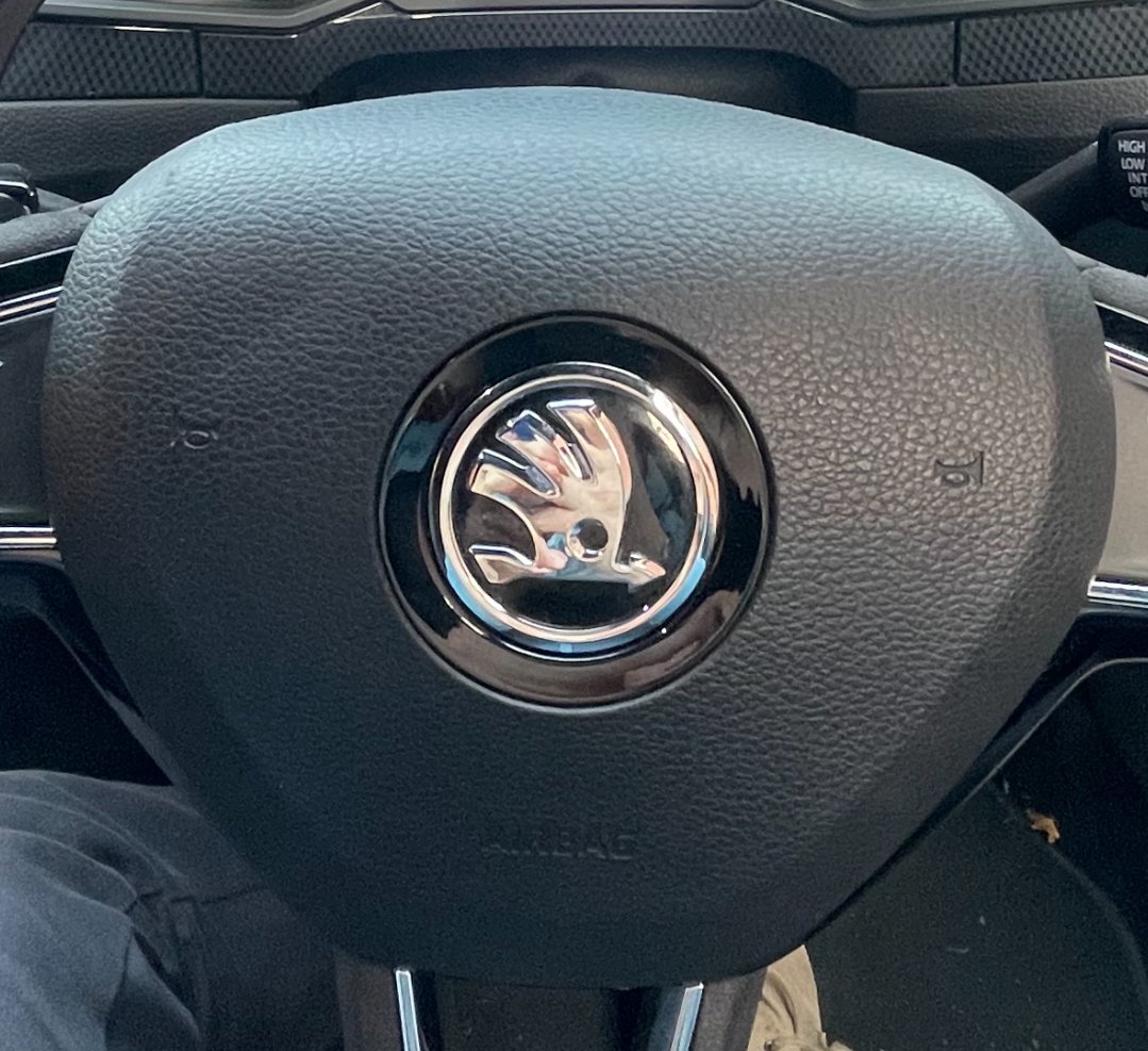

  8. Sure, see below image. This is a later ‘deeper’ airbag. If you look at yours the rear will be quite a lot shallower. Obviously, the pictured airbag wouldn’t fit into a wheel with a shallower space like the older wheels have. This is why I needed an older style airbag for my wheel. When you look at your wheel and compare to this image, you should get an idea of the size of the gap if you fit the old bag to a newer wheel. I believe someone in another thread estimated it at 1 cm. Of course, this might all be academic if the wheel you are looking to purchase is the older style, then it would fit perfectly.

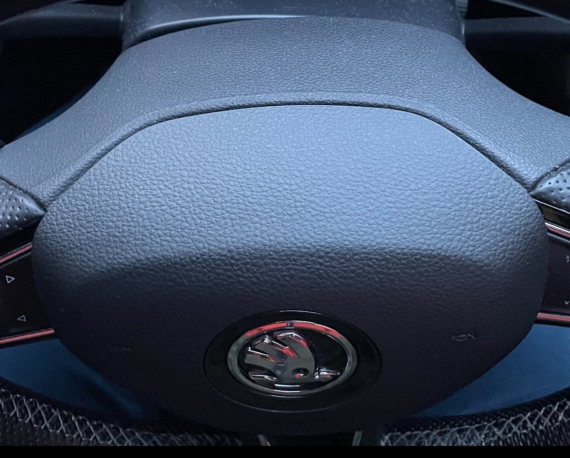

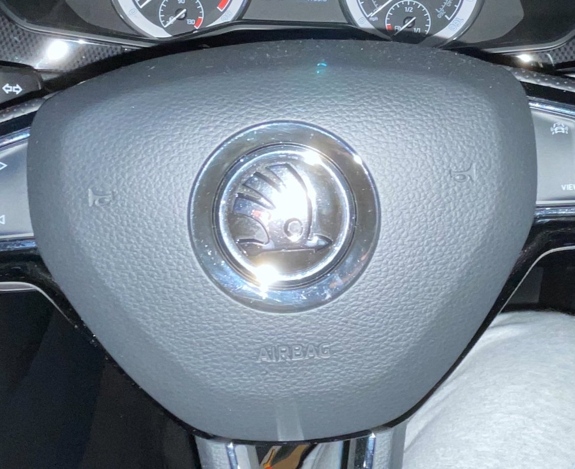

  12. If you see the image below, this is a pre June 2018 airbag. Notice how the crease on the sides doesn’t continue around the top, so the top of the bag has a smooth appearance. Now if you look at the bag that my car came with below, you should see that crease continues all the way around the front of the bag to make kind of a triangle shape. If your bag looks like the one at the top, it’s shallower and I believe should fit any wheel, although you’ll have a slight gap. If yours looks like the bottom one then it’s deeper and will only fit the new wheels (no idea what the part numbers are). It may be worth consulting with your dealer as, like I said, mine was able to tell me if the wheel was listed as compatible.
