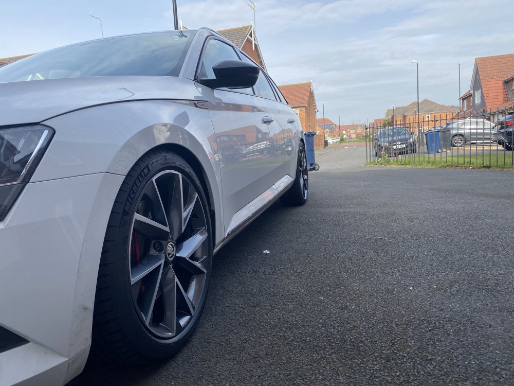

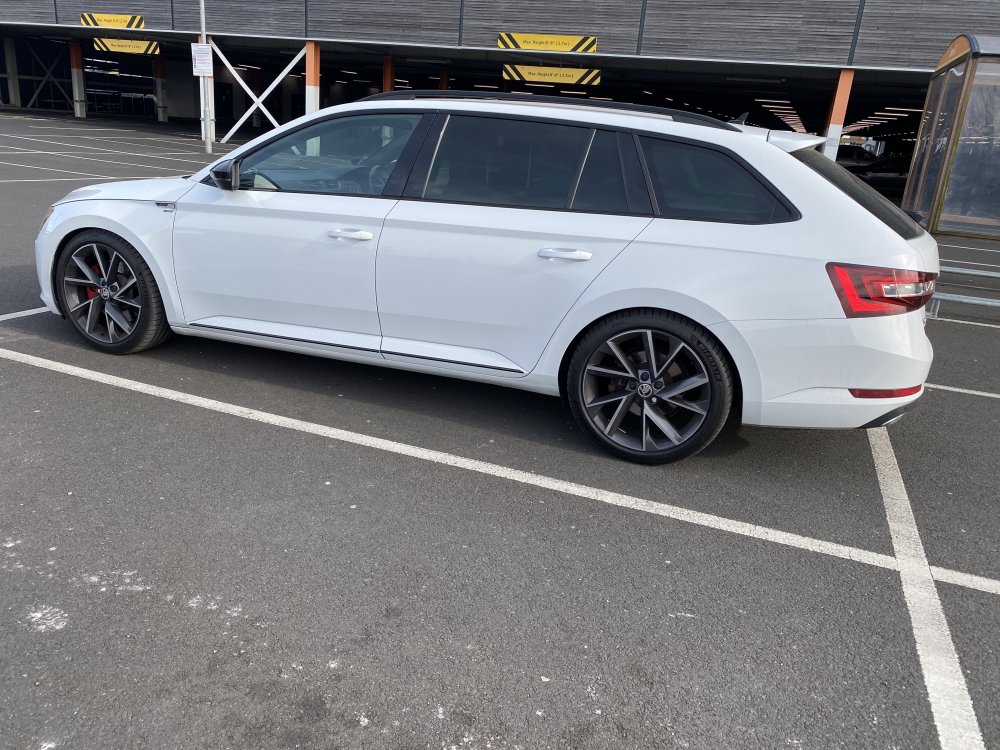

    Spacers arrived yesterday, here's what they look like on standard sportline suspension.

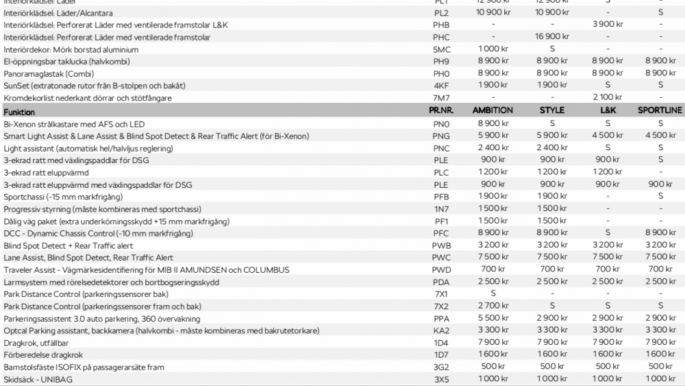

Hi!
According to the Swedish price list, the sport chassis on the SportLine is 15mm lower than the standard car. According to the same document, the DCC suspension is 10mm lower than standard. I would assume the DCC overrides the sports suspension, but I’m certainly not certain.
Edited by Malakim

According to the Swedish price list, the sport suspension on the SportLine is 15mm lower than the standard car. According to the same document, the DCC suspension is 10mm lower than standard. I would assume the DCC overrides the sports suspension, but I’m not certain...
Thanks for this, it actually makes sense. I originally interpreted that comment from @ewlmr as: "Sportline standard" has 5mm lower springs (I thought compared to standard Superb) while DCC is not. But he was comparing Sportline standard vs Sportline DCC obviously and they are both already 10mm lower than standard Superb it seems, with Sportline standard moving down another 5mm to15mm in total, clear.
Maybe this 10mm is ok to not bother with slight lowering, let's see how I like its height and handling once it arrives... Otherwise something mild like Eibach -15mm would be just fine, nothing too silly.

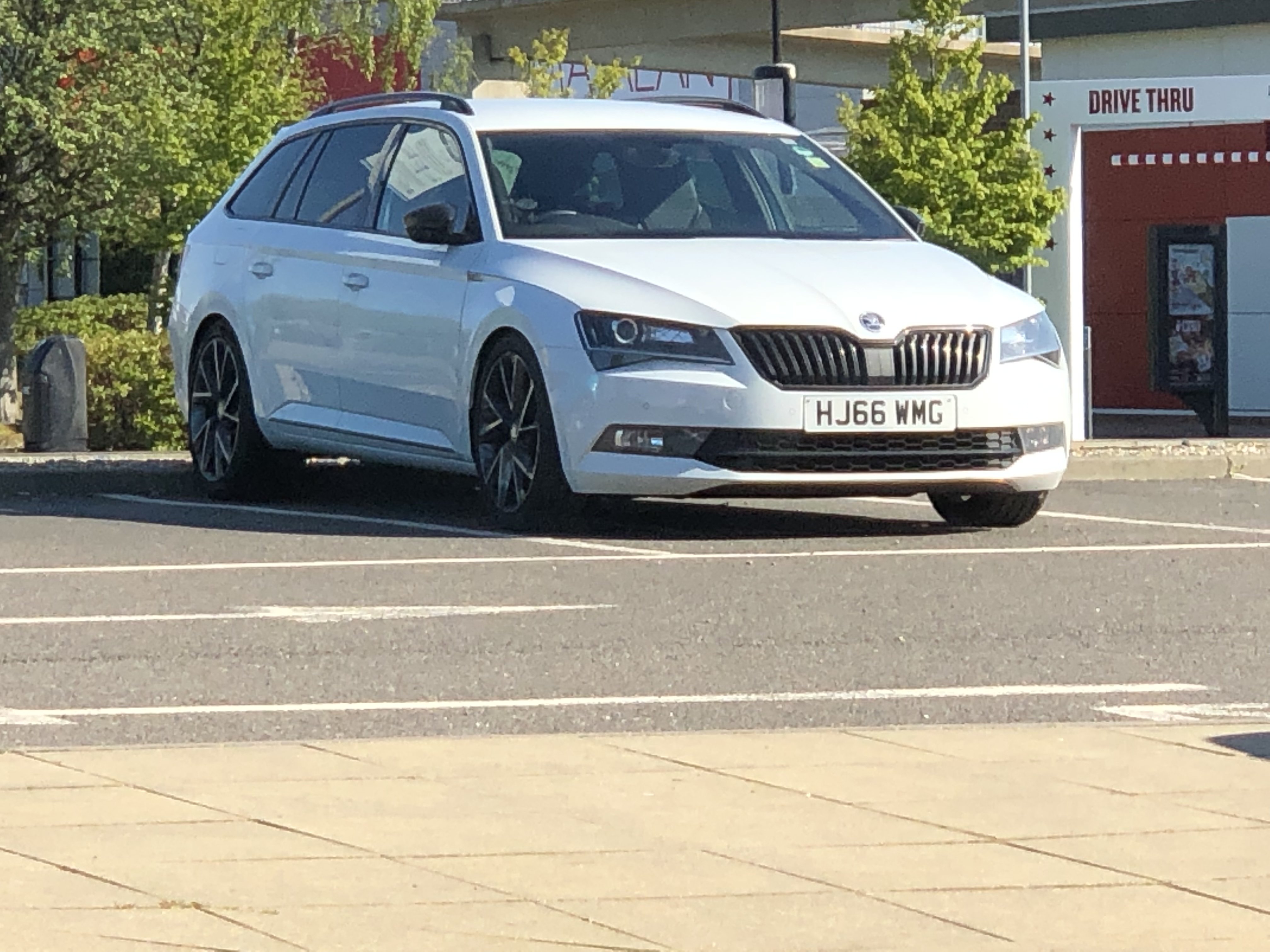

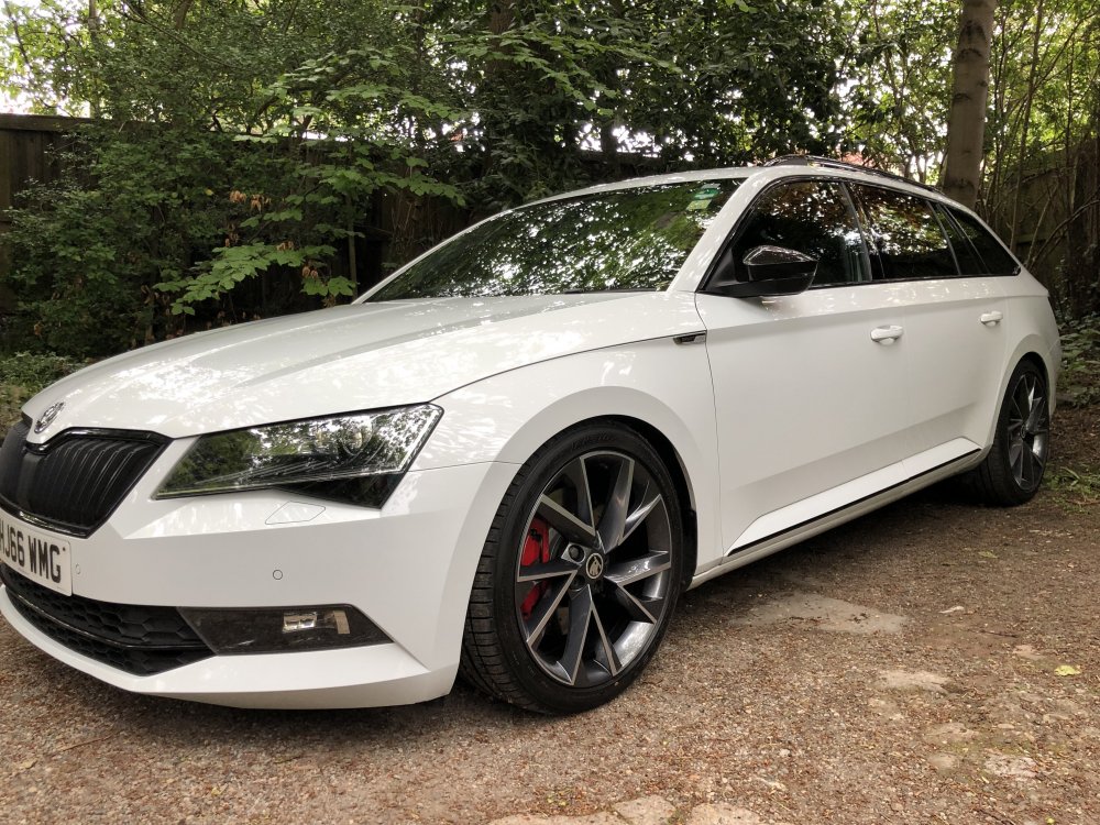

Have a set of eibach springs waiting to go on my sportline 280 with DCC. Will get some pics when I finally get round to it.
Please do! Would love to see how that would look :thumbup:

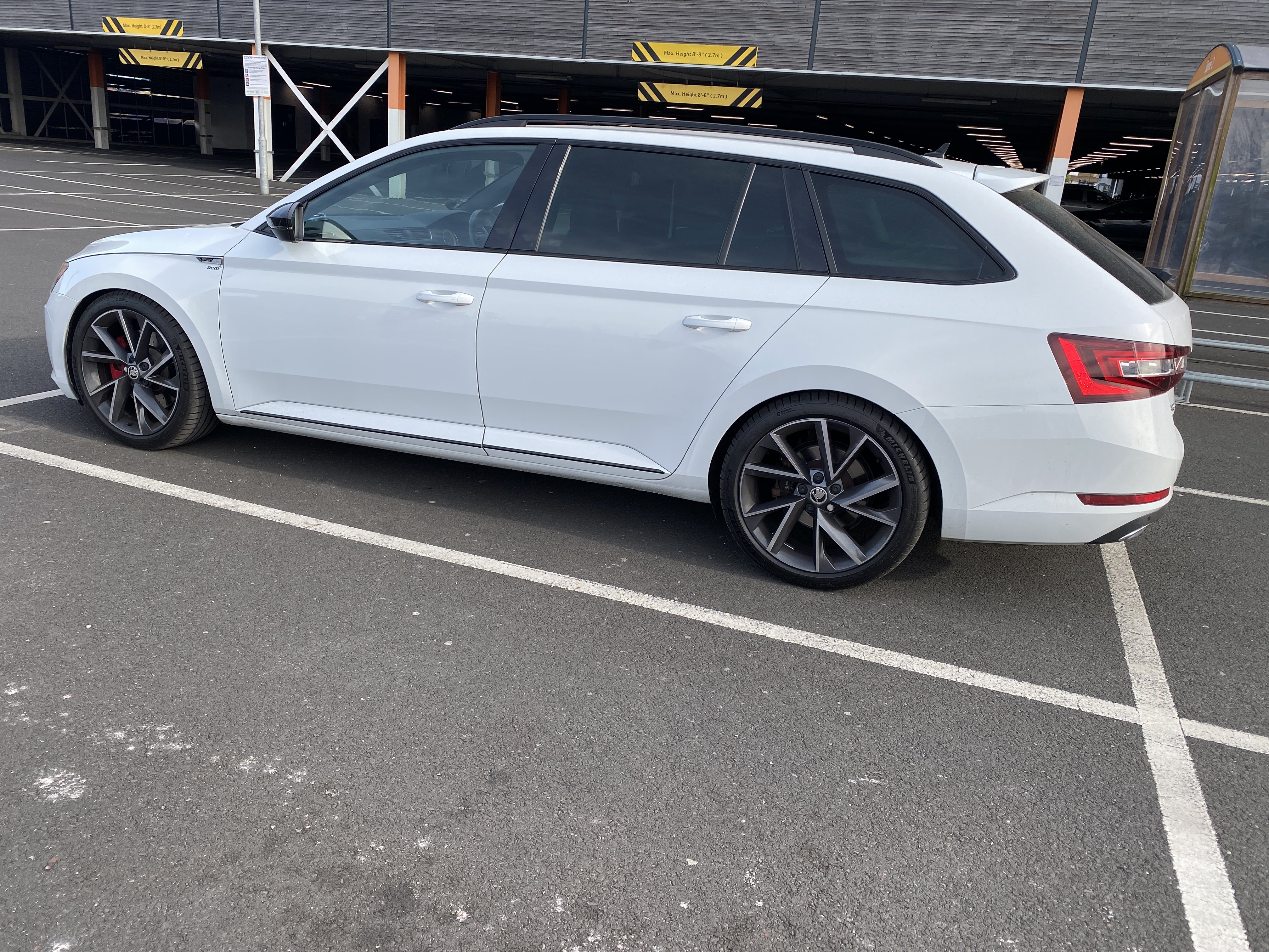

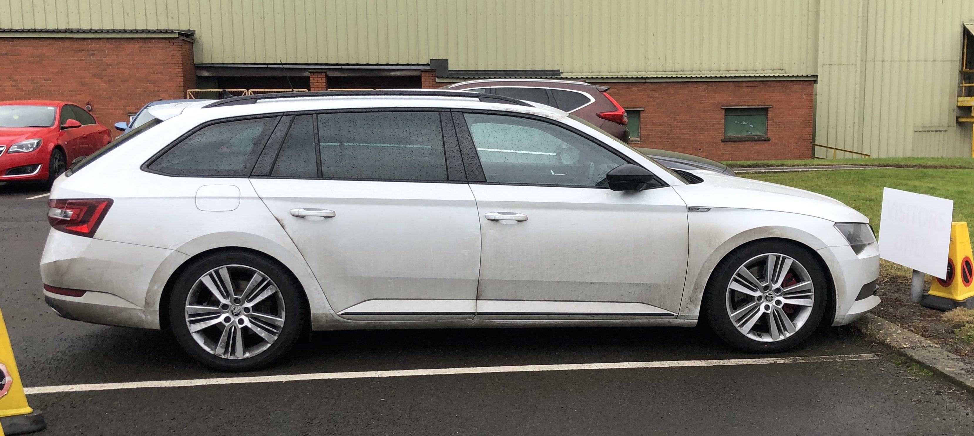

My Sportline 4x4 with H&R and 12mm spacers
Has it reduced the floatiness on turn-in? And is the ride still good or is it notably stiffer. Not sure whether the softness in the standard Sportline comes from soft dampers or soft springs (hopefully not both).
Yea no floatiness now and it’s a bit stiffer but not to noticeable tbh. Even loaded with snowboard and camping kit with the wife and kids it’s stil pretty good. The H&R are properly progressive

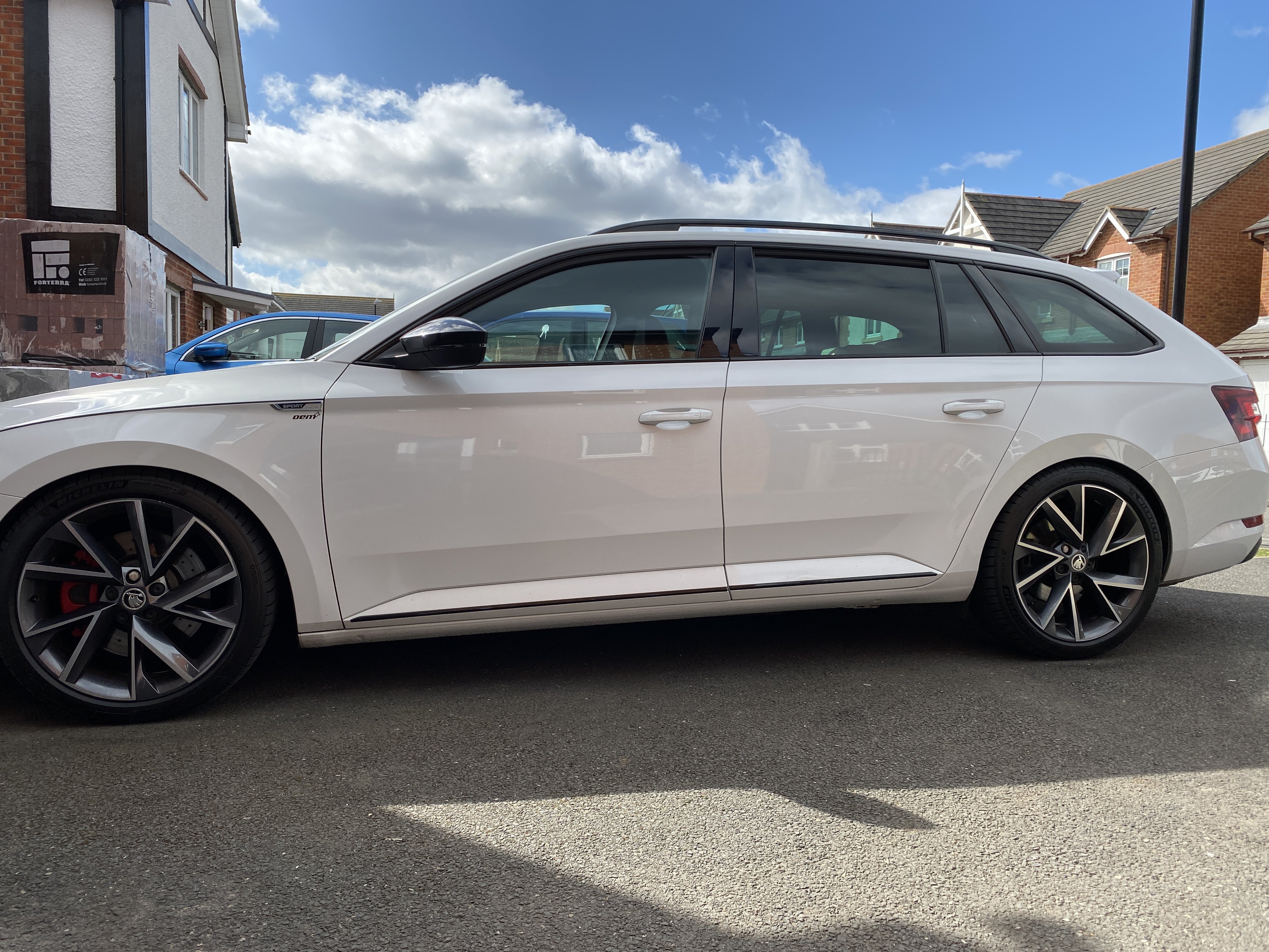

Guess your H & R are 40mm lower than standard Superb but as the Sportline is already 15mm lower than standard the overall drop is 25mm.

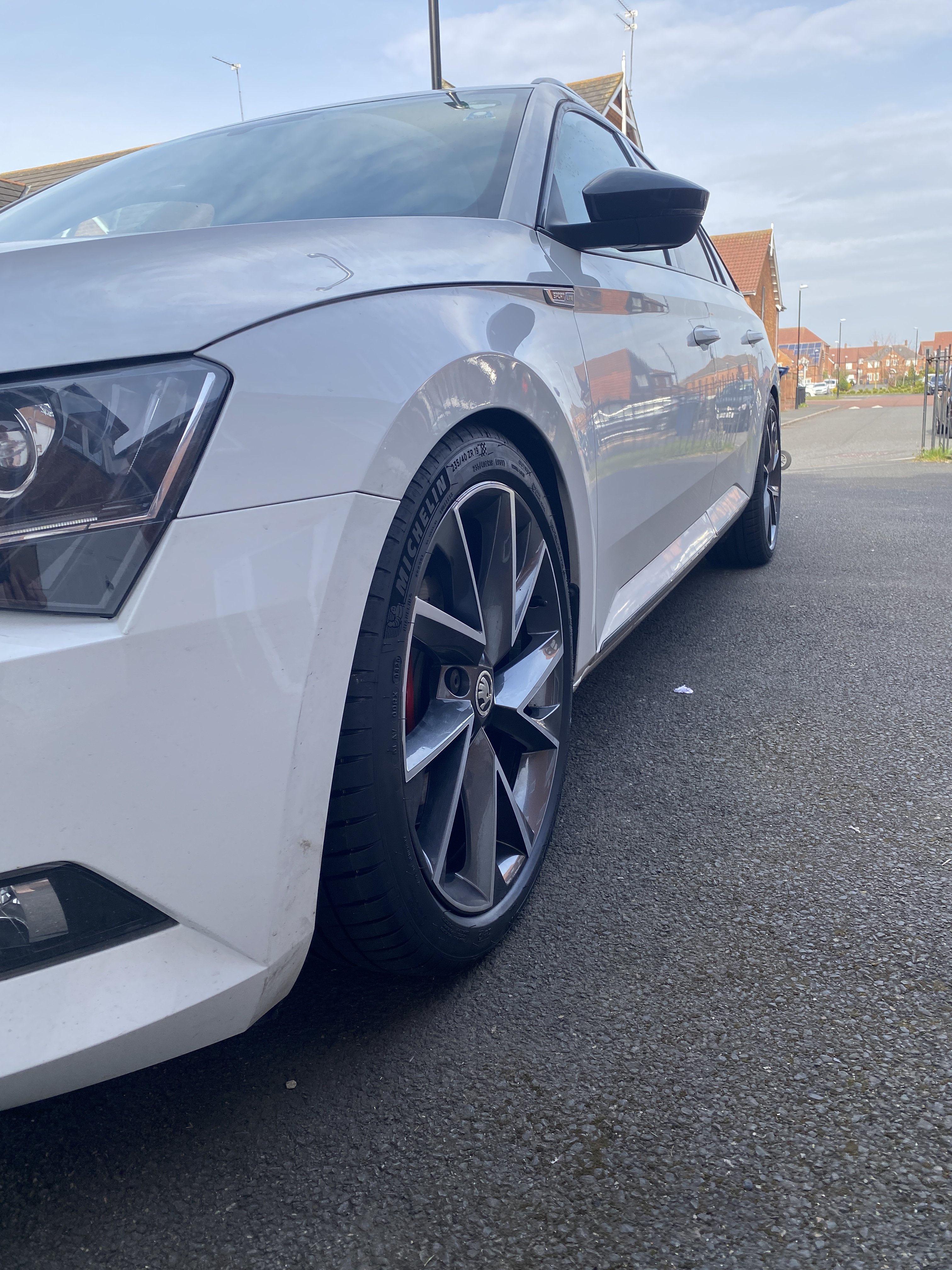

This is mine on 18’s winter tyres
