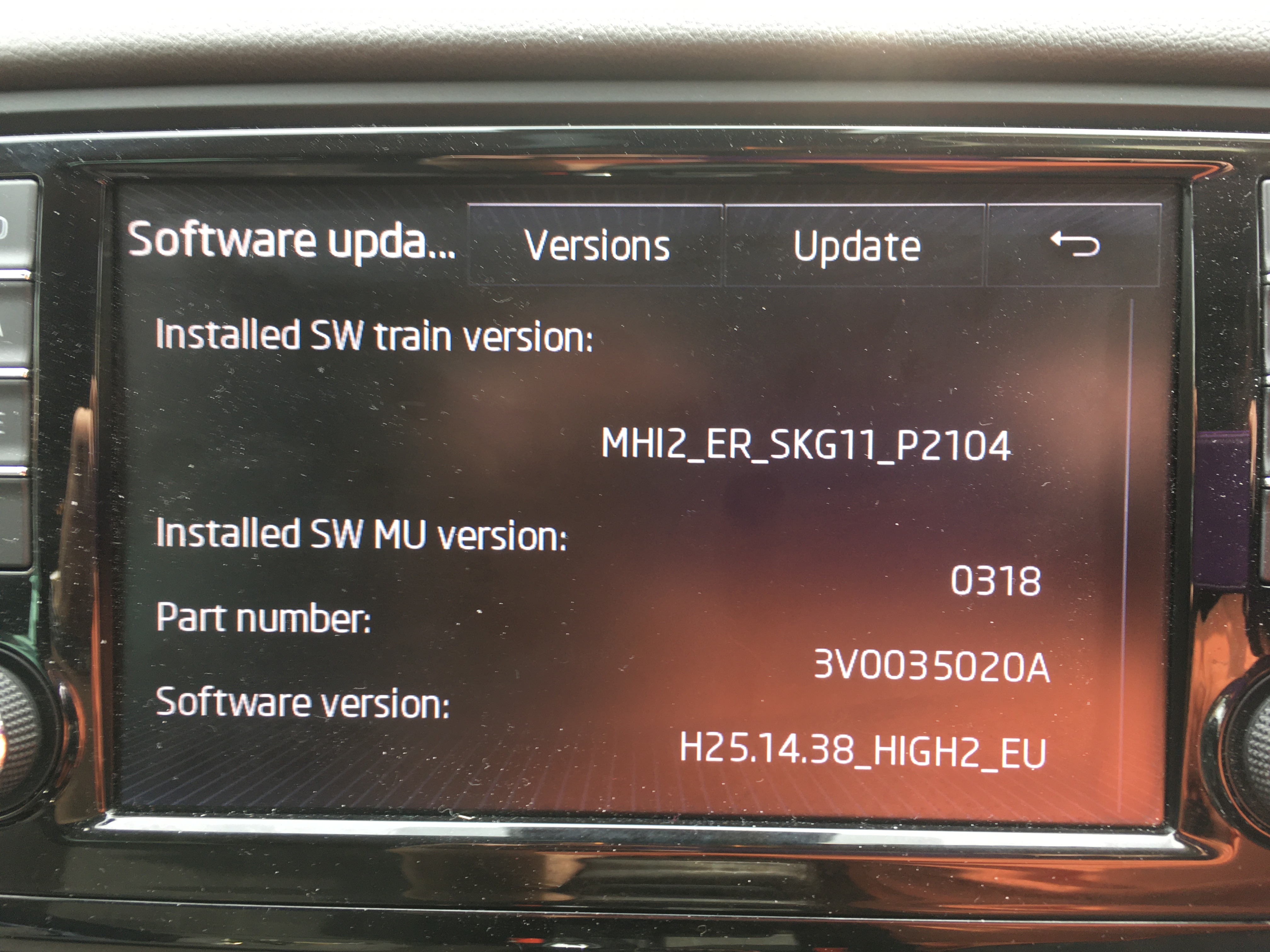

Hi again. So here's the thing. Not being remotely as technically knowledgeable as many of you out there I am now suffering from information overload. I have read and reread many of the posts but am no clearer as to whether or not the is a solution for my Columbus kit. Below are two screen shots from my head unit and what I would like to know is: is there a fix, if so what is it so if I can locate someone with the right dongle get the changes made. All help gratefully received. Thanks.

Hi everyone, I am new to to the forum but have been following the posts from a very early stage as I have the same problem (no surprise there then!!). Great work by all you ‘techies’ who have performed all the research into possible fixes of which I understood nothing. I see in the previous post numskull is up and running using previous advice. My car is fitted with Columbus kit including Canton sound with jukebox feature. Would my fix be the same numskulls and is there anyone in the Manchester area who could apply the fix for me. I am prepared to travel and would obviously reward such help. Here’s hoping.
