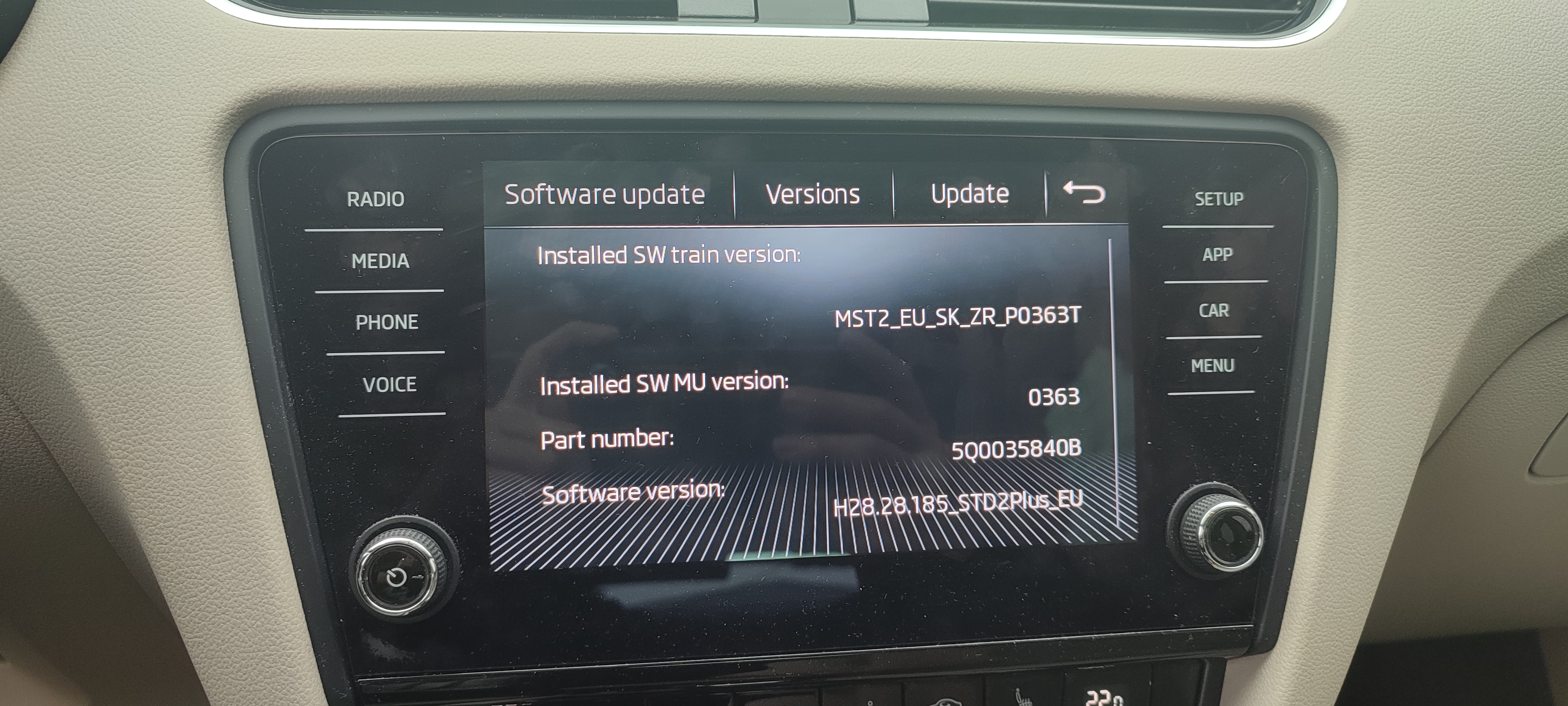

  2. Hello! Is there any updates for my Octavia III Bolero system? Thanks!
