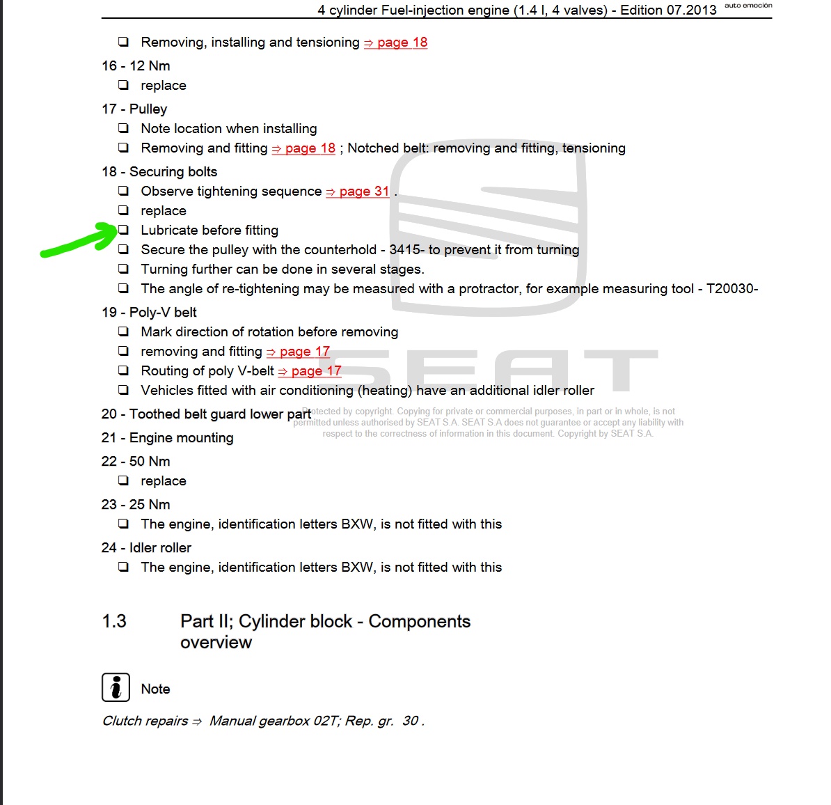

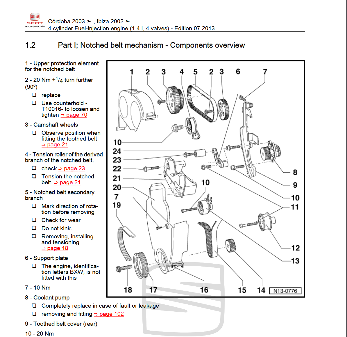

  10. I already replaced the cambelt and waterpump like a week ago (aftermarket kit by SKF, original was outrageously priced), I decided to wait a week and then double-check that the tensioners and everything else looked right since I've never changed a cambelt before and I didn't want to buy new engine mount/crankshaft bolts twice so I reused the old ones for a week. I was surprised to find the 20-year old water pump in immaculate shape, no play or noise whatsoever and the bearings felt smooth exactly like the new one, there was no leak either so it felt like a waste to replace it but I did anyways. I'm doing everything on the ground with regular old jack-stands so getting the torque right is going to be a challenge, I do have a counterhold tool so I should be able to get enough leverage to tighten properly, I will have to use my beam-style torque wrench since I don't have anything else that goes up to 150 nm. The manual does also state on another page to lubricate it (presumably with engine oil or similar) so hopefully that will prevent the bolt from seizing in the future and also make torquing easier.
  11. I guess my manual is saying "use the newest version of the bolt when replacing" but the wording is bad.
  12. I did actually email different dealerships to get a price estimate for a cambelt replacement before I decided to just do it myself, they all use the same new bolt with the hollow head and apparently it's the correct one when they type in my car VIN-number. Still strange that the manual recommends using the same version bolt that the car came with. Do you think it's okay to use the new bolt?
  13. What do you mean? The last paragraph just states different torque requirements for the new vs old bolt.

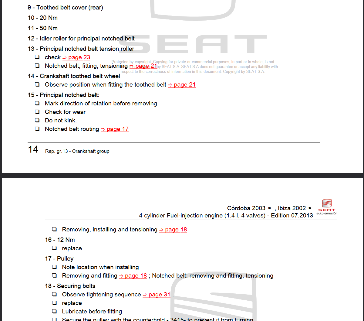

  14. Had to replace the crankshaft pulley bolt on my ibiza 6L 1,4 BBY, the one my car came with (from factory) is a 19 mm 12 point with a flat head but the one dealer gave me is 21 mm 12 point with a hollow head? Looking at the repair manual they do mention two different crankshaft pulley bolts with different torque requirements, flat head 90 nm + 90 degrees vs hollow head 150 nm + 180 degree. What's strange is that the manual does state that the same version of crankshaft pulley bolt that the car came with should be used, so why did the dealer give me the new bolt? Can I use the new bolt without issues or do I play safe and get the original flat head bolt? 150 nm is quite a lot of torque and I don't want to strip something.
