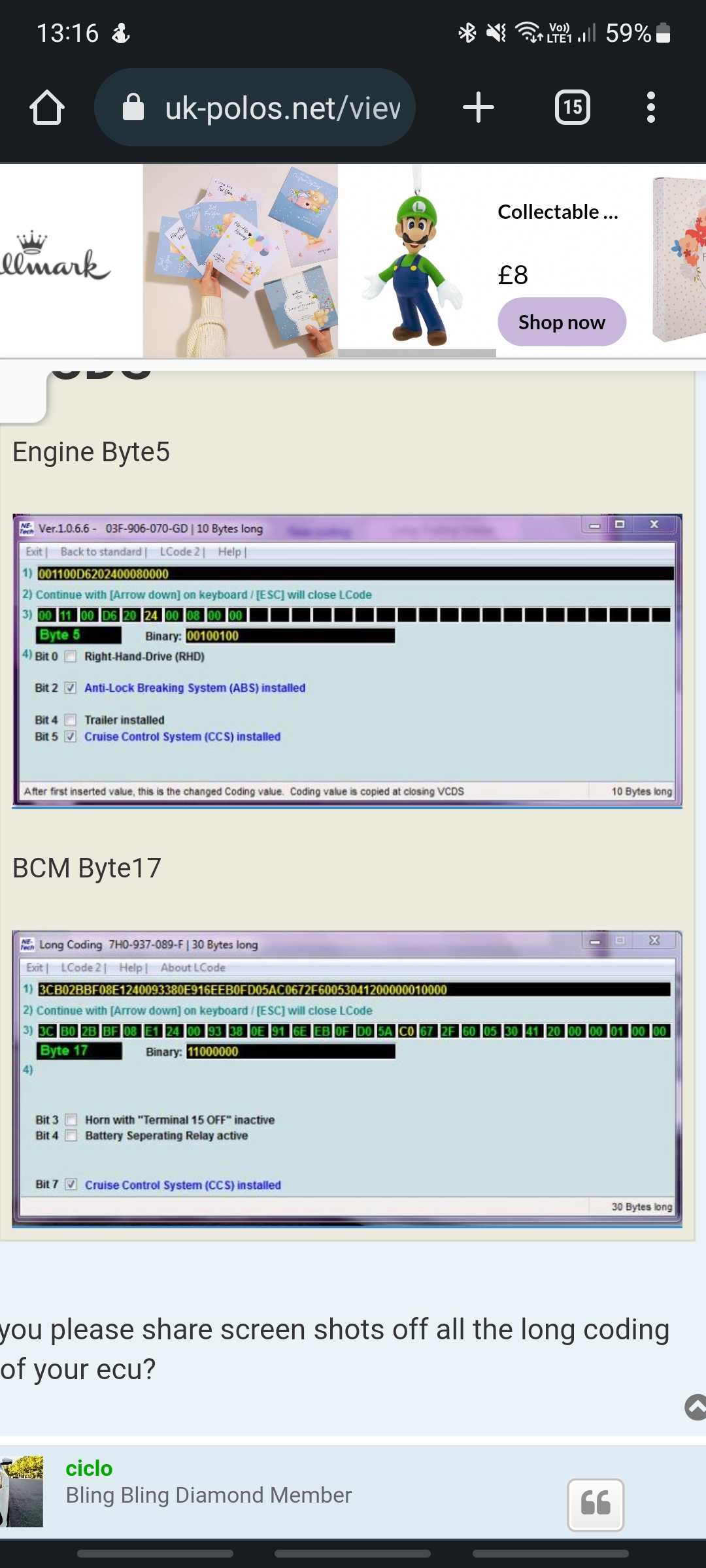

  24. I think I have managed to program the cruise control on vcds using the included pic. I think the aftermarket would sound alot better than the oem stereo well they normally do. I'm not worried about the instrument cluster as I have the basic one and it doesn't show it anyway. The facia and adapter harness were £25 from the bay. Ahh OK ill get the bluetooth one thanks.
