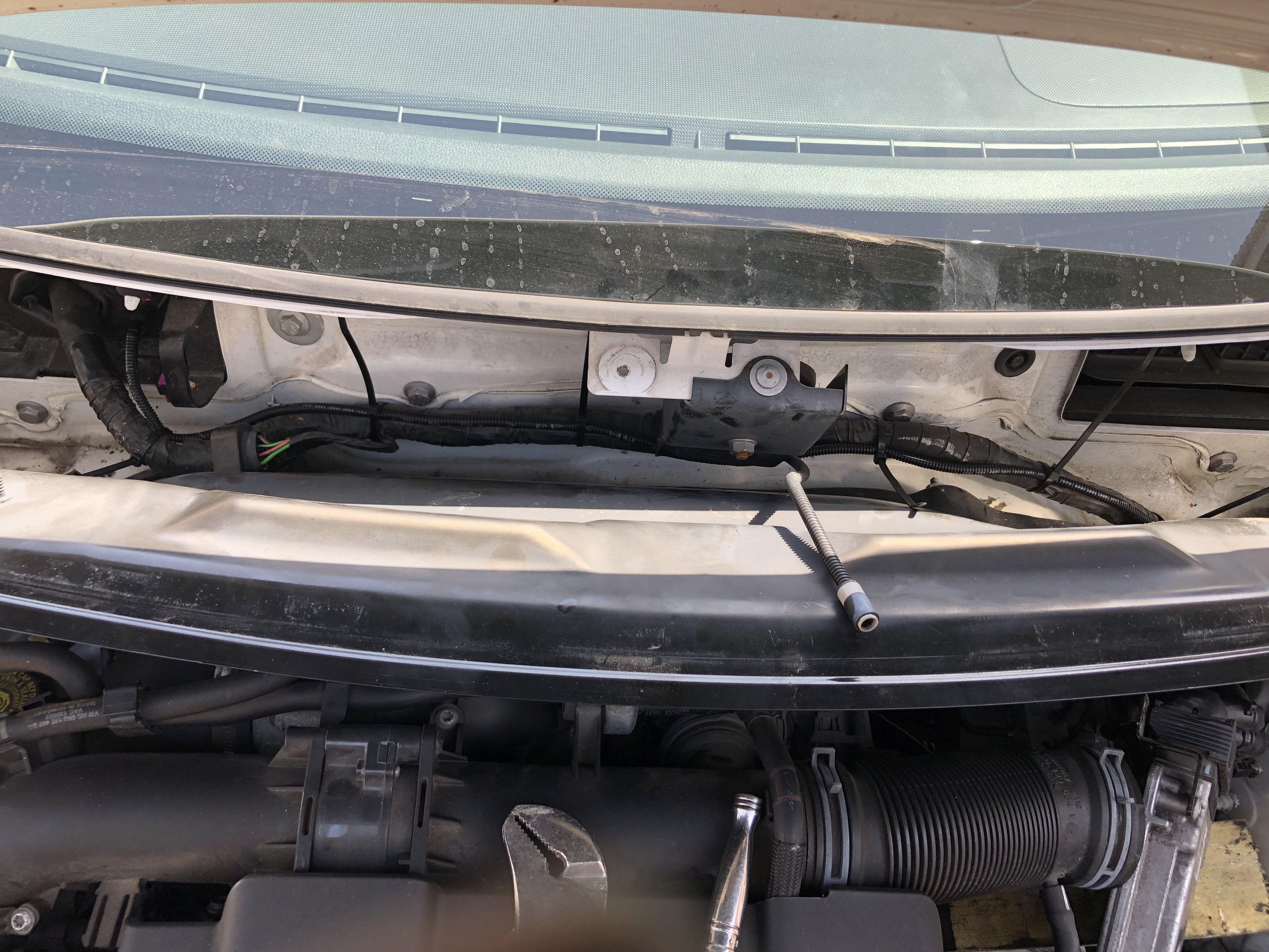

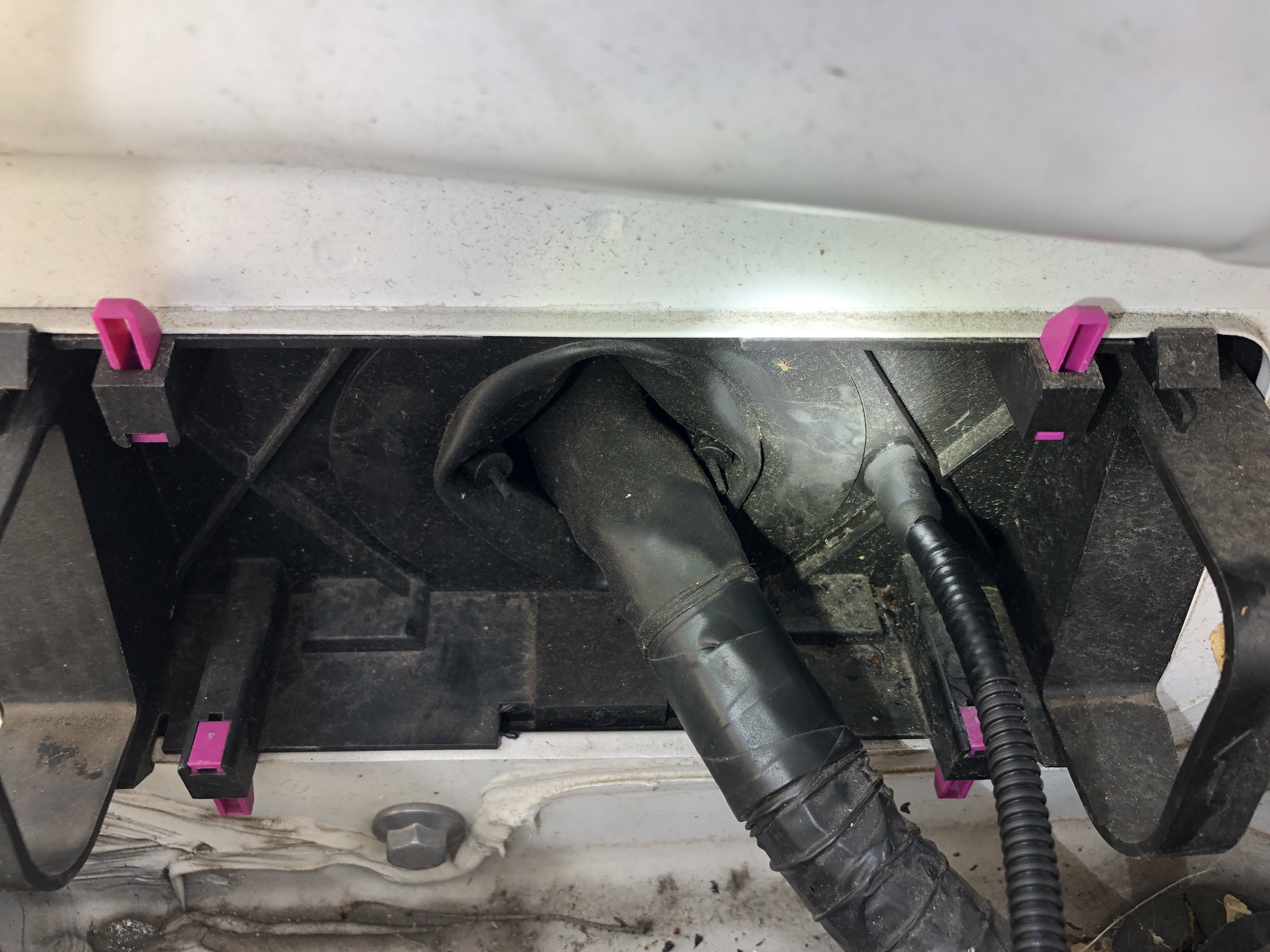

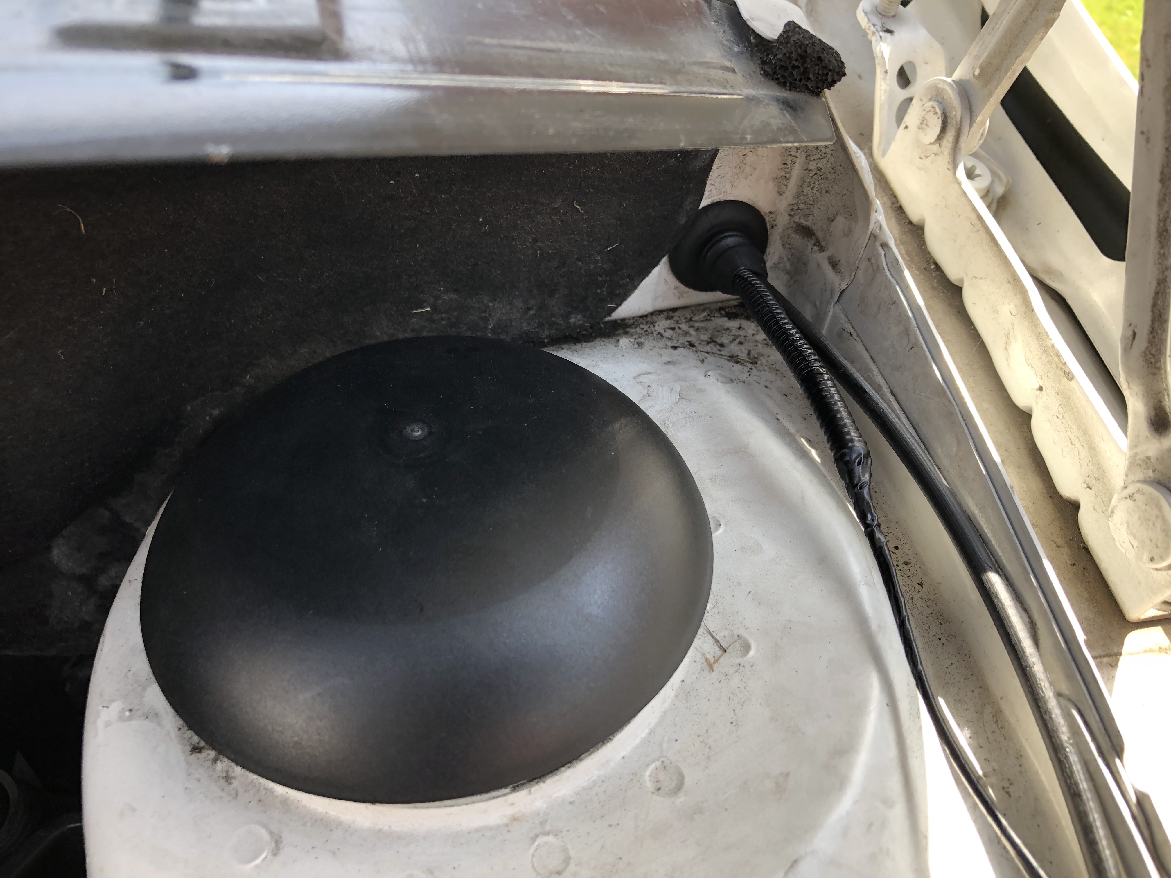

    REF cruise cable, its easy enough to remove the windscreen wiper scuttle panel, then the wiper motor etc for access.........then.....   Run the cable through the bonnet release cable grommet
  • That's great thank you, The pictures help alot. I wasn't too sure on what people were saying when mentioning the bonnet release cable but I see now. Its to get it though from the scuttle area it makes
Run the cable through the bonnet release cable grommet, along under the scuttle panel, cable tie neatly to the main loom already in there and then into the car through the main loom connection panel at the drivers side, you have to drill a new hole obviosuly, check on the inside for anything behind, it should be clear, you can easily feel the location up behind the pedals.
Images from mine when I did a few years back
Edited by UrbanPanzer
That's great thank you, The pictures help alot. I wasn't too sure on what people were saying when mentioning the bonnet release cable but I see now. Its to get it though from the scuttle area it makes sense now. I think I'm just gonna solder the clutch switch cable in as I'm not going to be taking it back out. I'm hoping to get some time on Monday so fingers crossed it get it all in. Then it's just the programming.

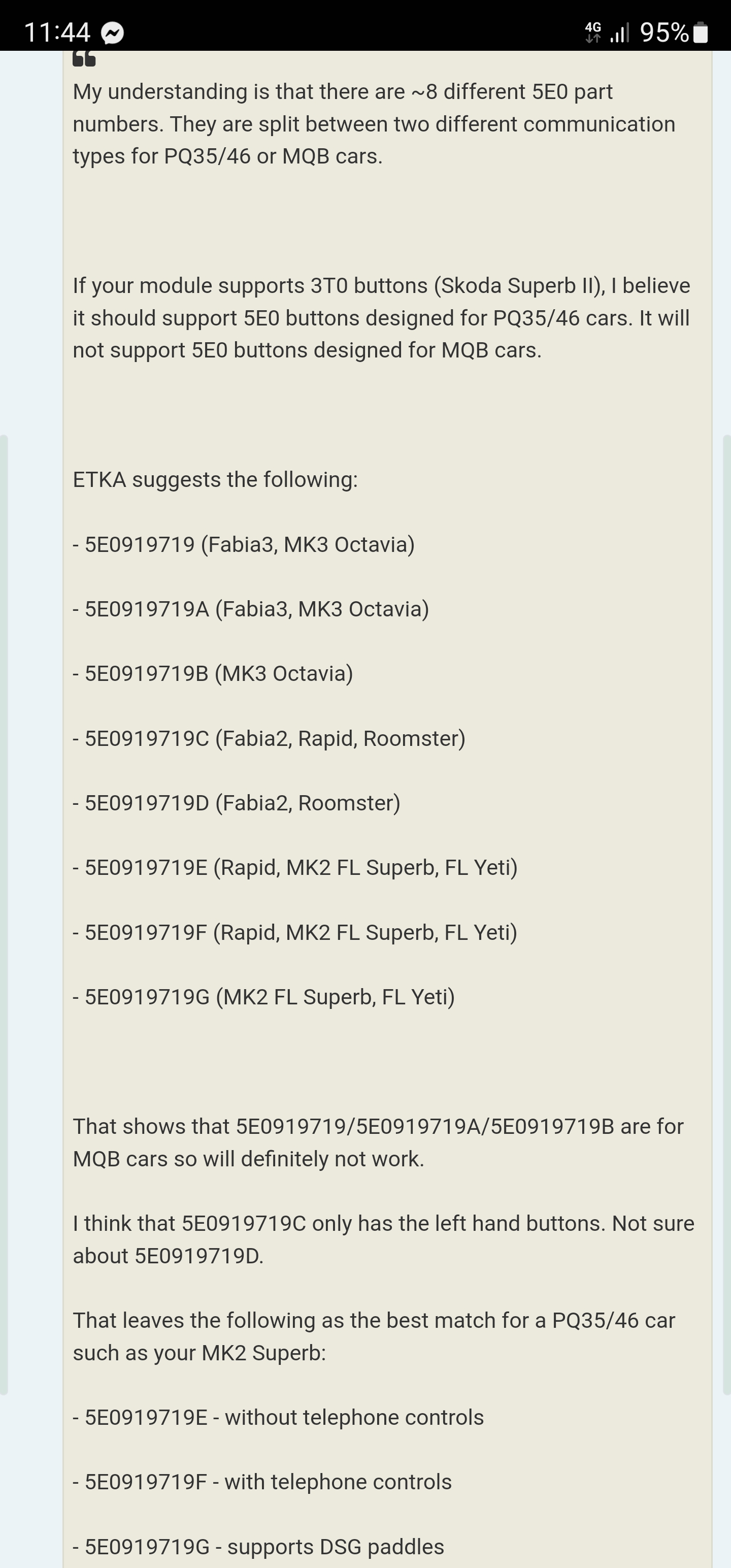

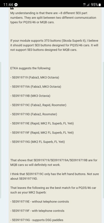

I would also be interested if the mk3 mfsw would work in a mk2. I did read somewhere that they don't work as they are totally different. I was surprised thay the fabia doesn't have steering wheel controls but I guess it's money saving.
I got into a rabbit hole regarding this recently. The steering wheel itself is easy, buttons and airbag loom need to be from another pq25 platform car to fit
I will soon have a full steering wheel with the buttons available as i'm upgrading to the dsg paddles stuff
