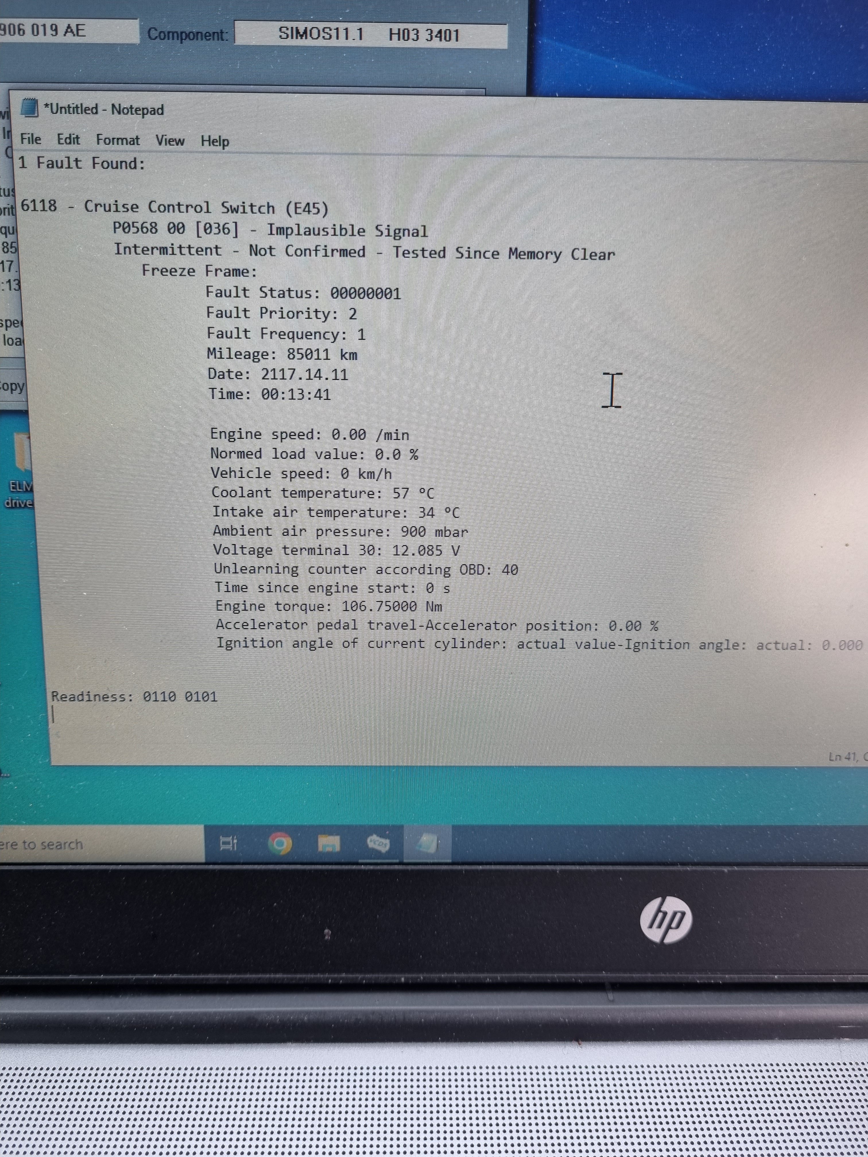

  10. The weird thing is when checking on vcds the cruise control stalk functions properly except that it thinks cancel is active until I move the switch to cancel then it's OK.

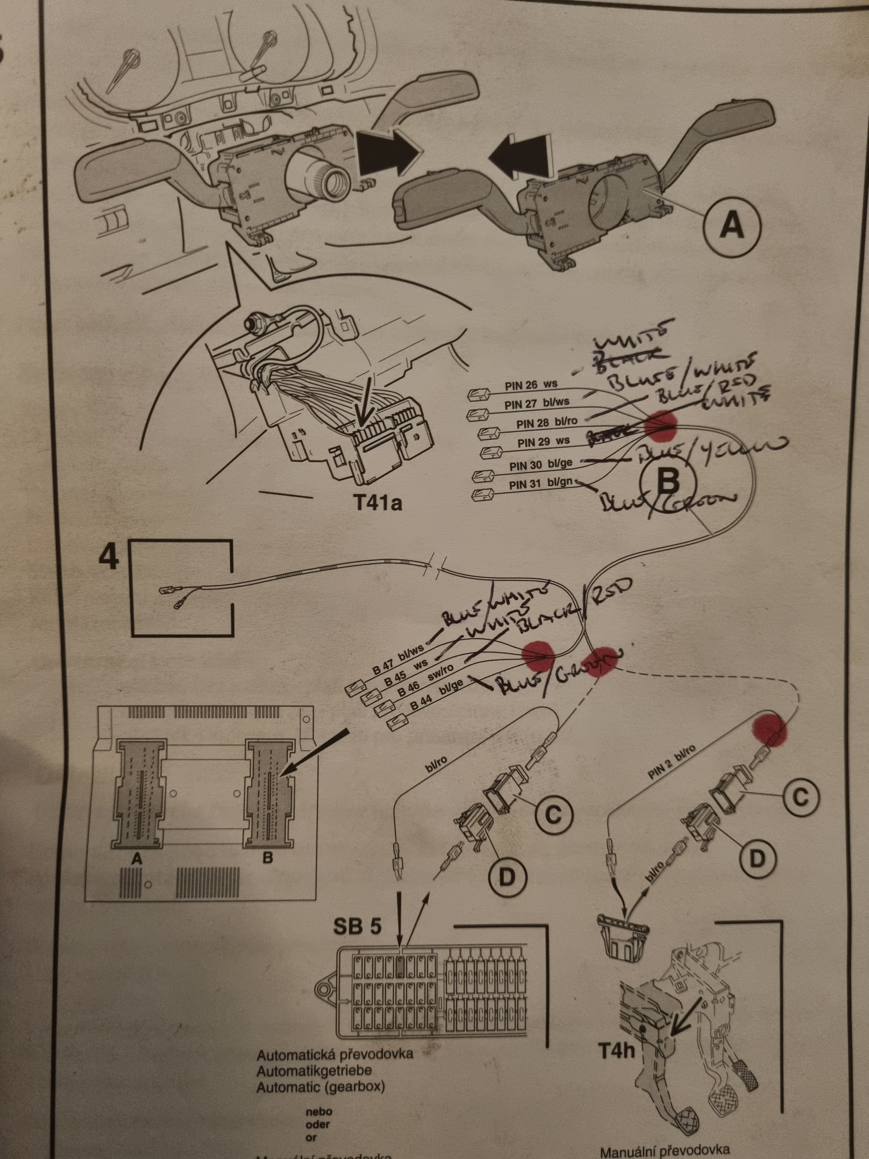

  12. Yes sorry I did notice that but there is only blue white and blue yellow going to the bcm.

  14. OK so I checked the pins on the bcm and sadly I did have them in the right places. Still getting an error I'm really not sure what's wrong. Maybe a faulty stalk?
  15. OK so I messaged tech1e and with his help I have found the issue. The instructions that came with the kit are very poorly written. The pins that go into the bcm are not in order. I'll get out tomorrow and swap the pins over and hopefully that will be it.
