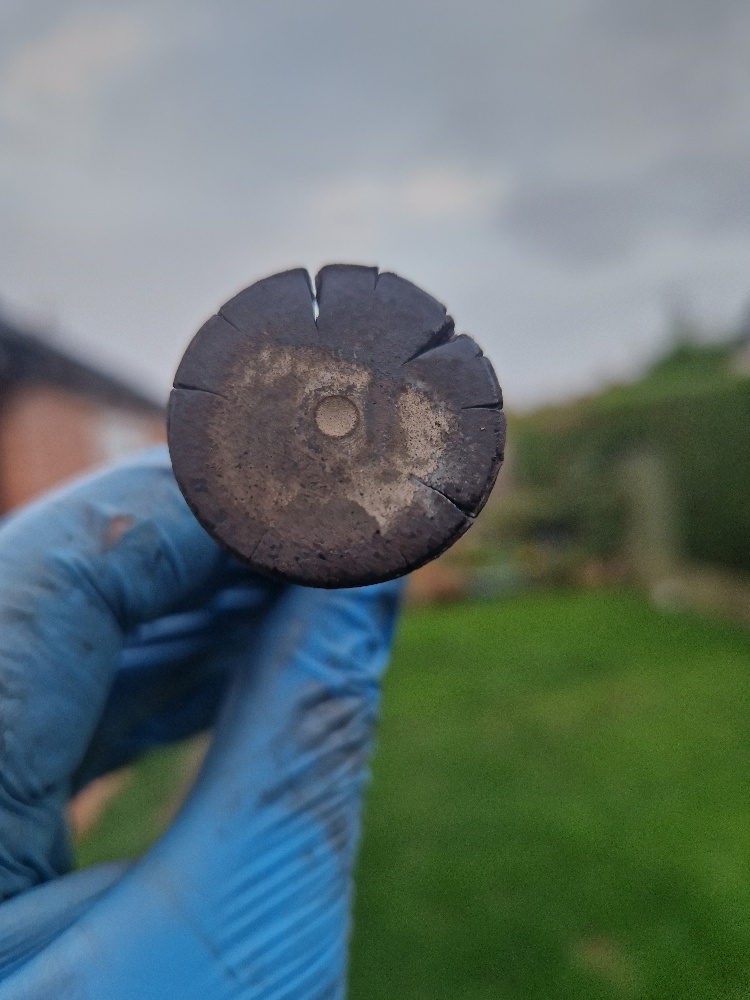

Thanks for the info. I get why the cam carrier sealant is different as it has to produce a very thin seal as the bearings are within the cover itself. Original stuff was very hard, almost like a varnish. The other two lead to very similar (or in some cases the same) alternatives and I can't see much difference in the specs so will just go with one option for the timing cover and sump. That is valve #3, #2 was fairly similar and #1 not quite so bad...

I am well on with this and will start a new thread to detail everything. Exhaust valves are boggered!! Just have a couple of questions: - Timing cover and sump appear to be a silicon based sealant, cam cover appears to be something very hard and difficult to remove. What are the suggested options for reassembly please? - Does the camshaft sprocket bolt need replacing? (I have a new crank bolt) Many thanks

Okay so we have a problem! Original compression test (done on a warm but probably not full temp engine) was on 21st August, so 4 weeks ago, and result was 11 / 9.5 / 9.5 Today we have: Cold Engine: 11 / 9 / 7.75 Cold Engine + Oil: 12.5 / 10.5 / 9 - All roughly + 1.5 but cold engine presumably tolerances are greater Hot Engine: 11.5 / 9.5 / 8.25 Hot Engine + Oil: 12 / 10.25 / 9.5 - All roughly +0.75 So #3 is detereorating... Head off, leak test, probably need valve guides and exhaust valves?

I am happy to take the head off and presumably replace the exhaust valves if that is what needs doing, almost at the point where I will do it just to rule it out! If I go down that route what else would be prudent to change while I am in there? The only thing that puzzles me in this case is that the problem is intermittent, surely it would be a constant, and how poor compression would relate to the above error codes? I'll recheck the compression at cold, and working temp and see what i get and report back. Thanks guys.
