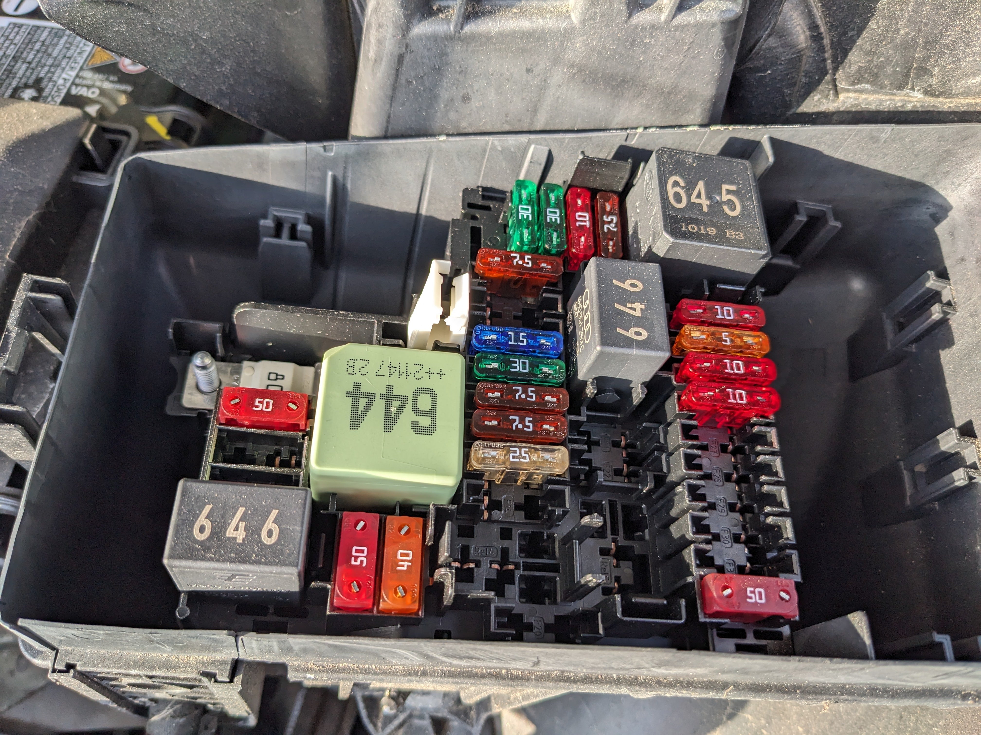

Maybe ensure that the car isn't plugged in waiting for a charge time as well. I'm pretty sure I read that somewhere else. I was unplugged when I did mine, gave it a wee while after removing then refitting then scheduled a charge for half hour later.

Hey, not sure what to suggest other than a trip to the dealership. I can't remember how long I removed mine for when I did it. Maybe give it another go for a longer period?

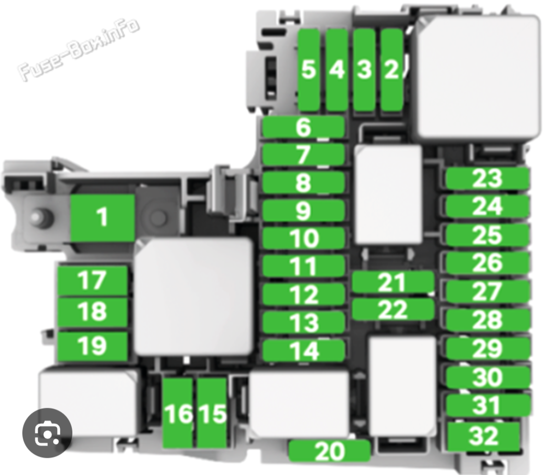

Fuse three in the top picture, 2nd one in from the right hand side after the 64 5 - so yes, the 10 between the 7.5 and 30A fuses. How long did you leave it out for?

Quite simple, bonnet up and open the fuse box on the right hand side. A quick check online will show the position of the fuse that you need to remove. It takes 5 mins to do tops.

Good to know. I cancelled my slot at the dealer today as I was able to successfully charge from home over the weekend. Hopefully not prematurely. Removing and replacing the fuse seemingly working for me. The car was initially throttling the AC charge so I switched it off via the in car system and I have read that the error message is part of the 3.7 update, whereby the car complains it cannot charge as it's expecting an immediate charge (as if using DC fast charging) rather than waiting for the home charger to start at its desired off peak routine. Whilst I was cancelling my slot, the service dept did ask why, I told them about removing the fuse and the comment I received back was , 'yeah, that resets the charge module, maybe the AC reset was missed at the end of your 3.7 update'. Make of that what you will. Anyways, thanks for the update, will be nice to hear what happens once they've looked at it.

I'm also having a similar problem with my Enyaq. It was in Skoda Dundee recently getting a software update to 3.7 and a new charging flap mechanism fitted and since I've had it back I've been unable to charge from home either when setting the car to charge during off-peak hours. Car will happily charge from a fast charger (done this twice). I did initially think it was an issue with my Wallbox App but I can manually override the setting and the car will charge perfectly, however as soon as I plug-in in preparation for charging overnight it shows the following error: "Unable to fully charge vehicle - Consult vehicle manual" - however I'm not trying to fully charge it - its set to 80%. Rather frustrating as it was working perfectly prior to going into Skoda. Tried removing the fuse last night, that seemed to work and I got a small charge but the error above flashed up on the dash again. Booked into Skoda again for 30th Sept.

So off the back of the software update and/or having to get a new charging flap fitted my car is now refusing to charge via AC at home. DC charging is working perfectly ( two fast charges since I got the car back from Skoda) however I don't want to be doing that on a regular basis. I was able to get the car to take a small charge from home last night, having read about pulling out fuse 3 under the bonnet for a reset. When I checked this morning the setting was on to reduce AC charging so it only charged at 1.9kw. Thinking that the fuse trick might have fixed it I was dismayed to see the same error I saw yesterday pop up on the dash again this morning - "Unable to fully charge - Consult the Manual". Wishing I had removed the charge cable prior to checking however I don't think that would have made any difference. Cant be pulling the fuse everytime I want to charge from home so my question is, I assume I will need to return back to the dealer to get this looked at?
