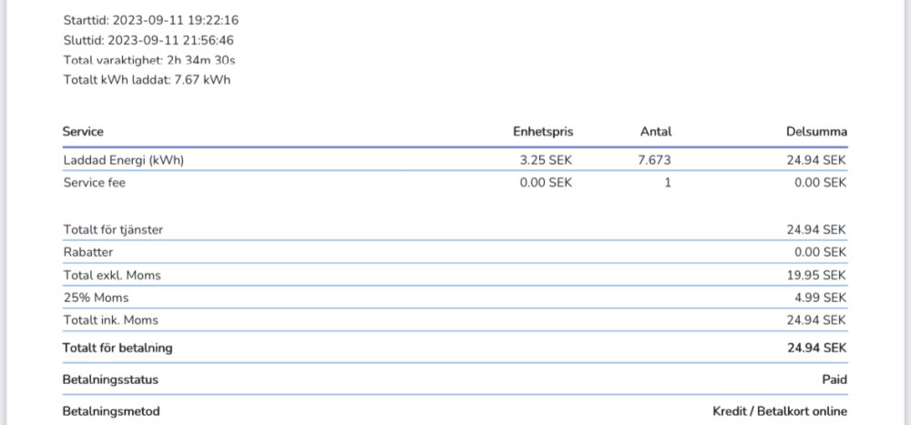

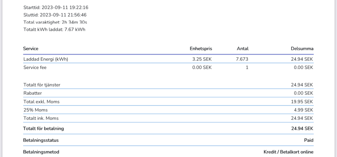

"I apologize for my confusion, it was getting late. it should have been from 20% to 99%. I'll upload a picture of the receipt that provides more details (it's in Swedish, but should be easy to understand).

Hello, I wanted to check with you if you have any advice. I own a Skoda Octavia IV 2021. Lately, I've noticed that I only get up to 50km of range on my battery, and it charges to exactly 11 kWh, showing 99% when I start the car. Weather conditions are good, with an outdoor temperature of around 20 degrees Celsius. It should provide me with 13 kWh and a range of approximately 65 km, right? I charge the car at different stations, mostly 22 kW, but also 11 kW (if that makes any difference?).
