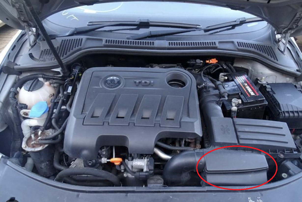

  1. I have managed to sort out these two problems. Vibration- went to another garage and balanced wheels again, which helped. Buzzing sound from engine bay - air intake covers... see picture ( they made so much noise that I thought it comes from gear box)

  3. It has been serviced. Its sounds the same in S and D.
