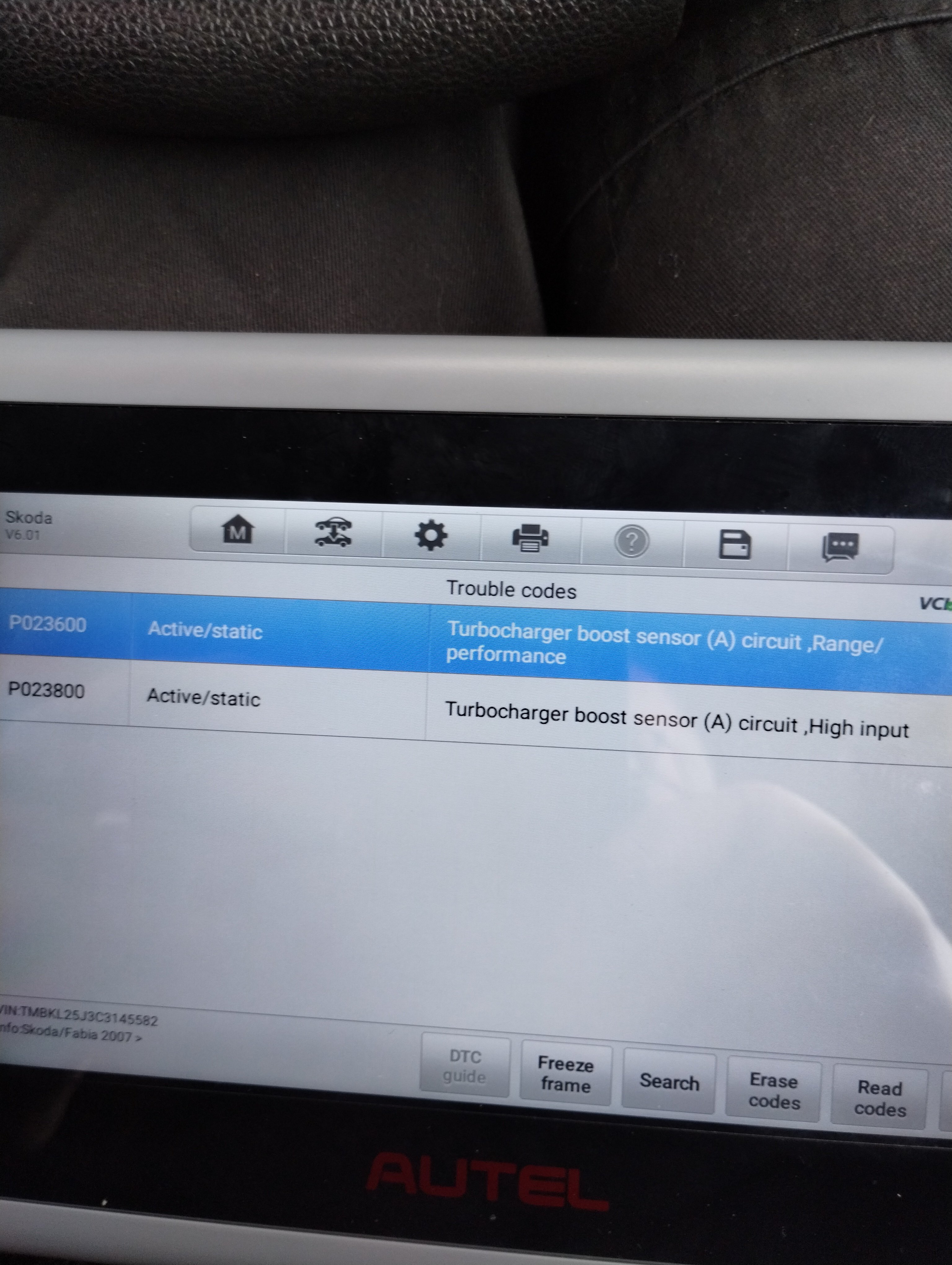

  1. yes it was a broken wire to the map sensor right next to the plug got a replacement plug with wire from the breakers then replaced the map sensor at the same time the car runs like a dream now
  2. yes the car goes into limp mode and flashing glow plug light comes on
  3. i have a fabia 1.6 tdi that has gone into limp mode i have done a code read and it is giving 2 codes P0236 and P0238 both are active/static boost sensor (A) circuit range / performance and boost sensor (A) circuit high input can anyone advise me what to check or replace
