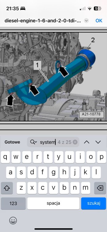

  7. I also checked the one-way valve. The leak may only be the pipe I marked?

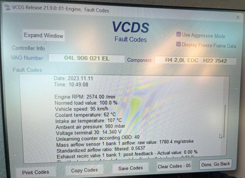

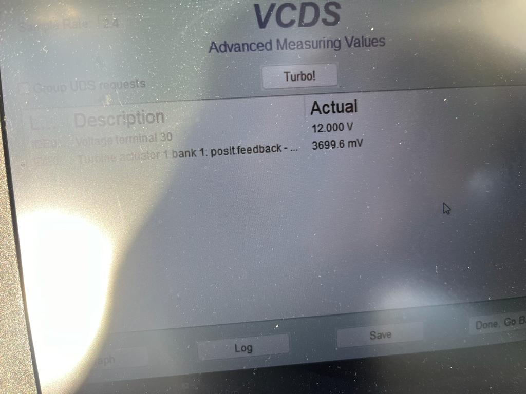

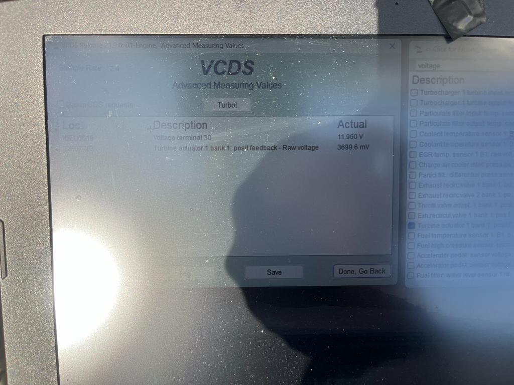

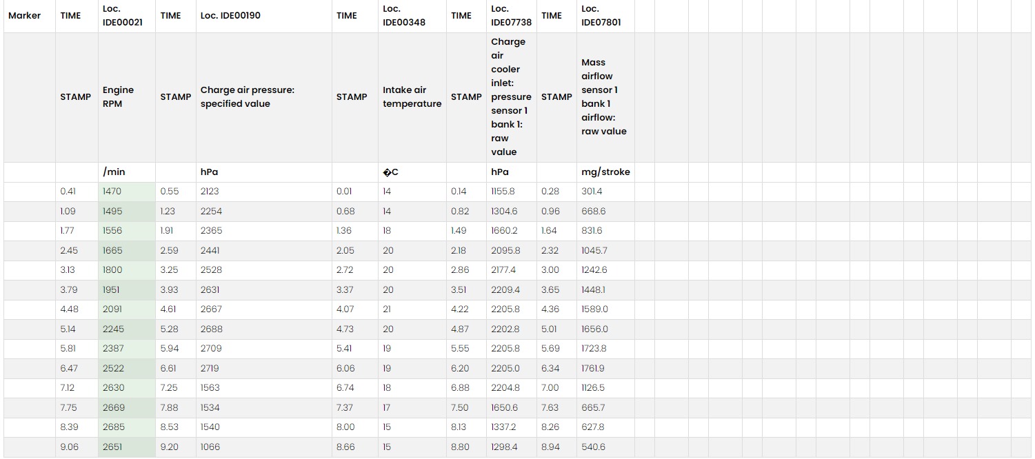

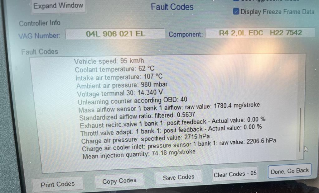

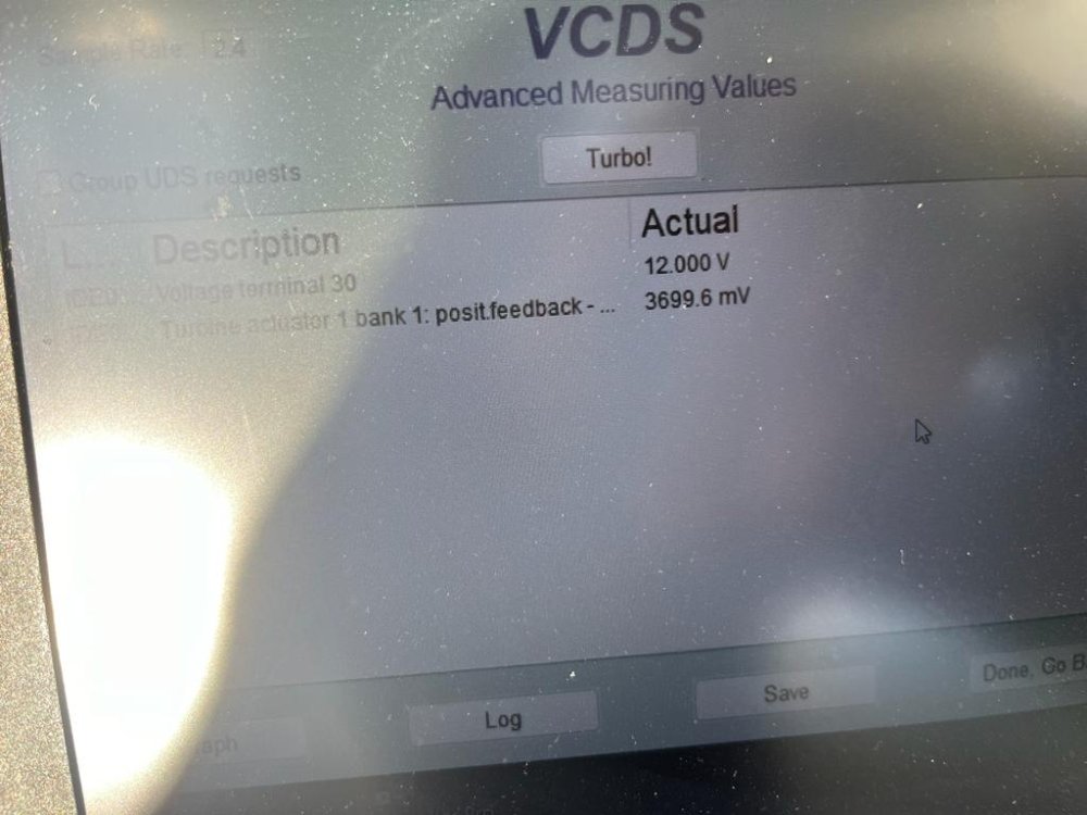

  8. Hi, When accelerating, the car enters limp mode, loses power and the glow plug icon lights up, I am posting errors and logs at the bottom. I have already replaced the vacuum lines and the N75 valve. What else to check? I also checked the bulb with a syringe and it holds pressure. Now Logs: The location of the turbine bulb is 3699.6mA in the lower one and 694mA in the upper one: I checked this cable by eye and it is good, I also tightened the clamps: And I replaced these hoses + valve 6 with a new one \ Please help, what else could be going on 😕

  10. It is a manual transmission. The car has 240,000 miles on it and this has been happening for 2,000 km and I have traveled 40,000 km in total. maybe it is a stuck turbine or EGR?
