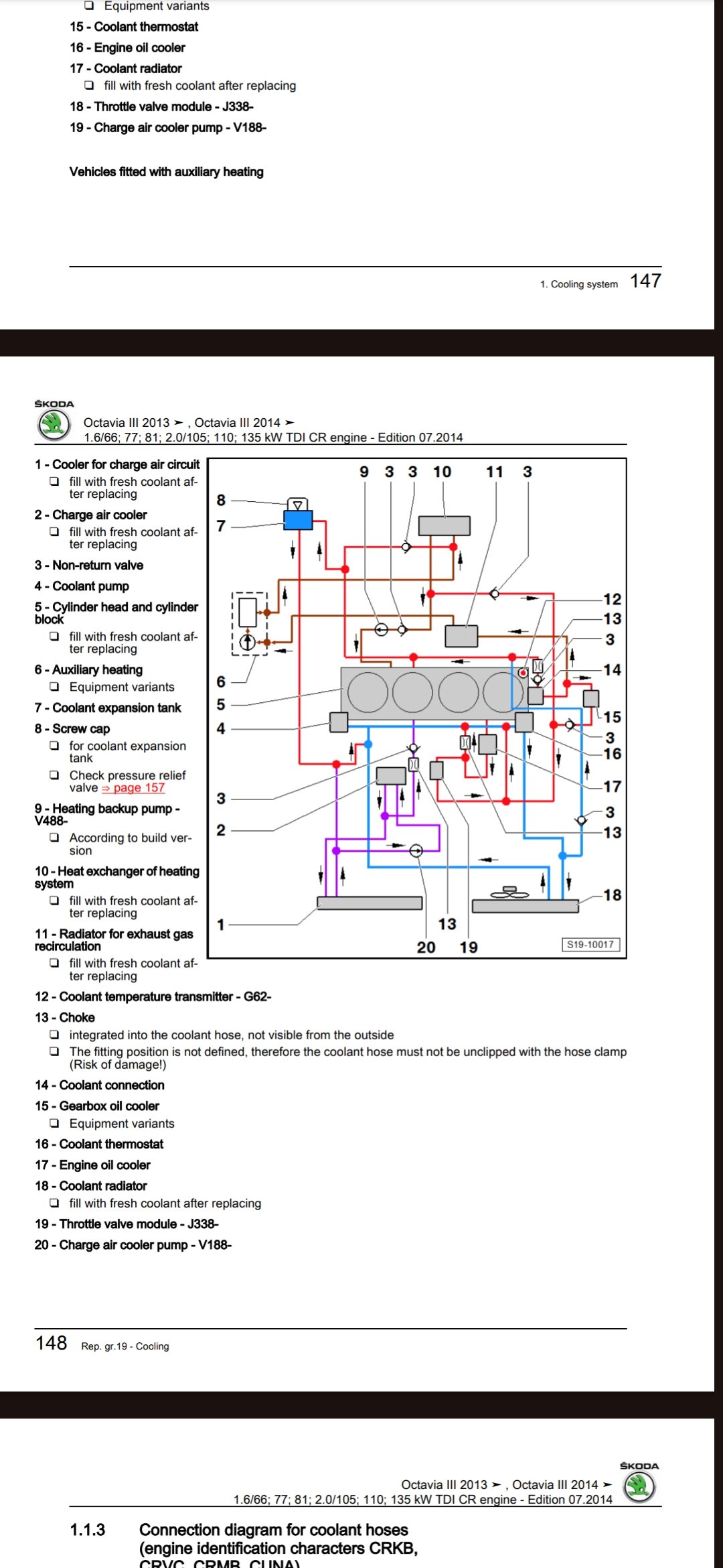

Octavia Heater Matrix
Hi. I believe there are two different makers of the original cooling system that these cars left the factory, Valeo or Denso. Other makers can of course make parts to these systems according to the specs, but i believe that you cant mix Valeo and Denso system parts together. You should go to skoda-parts.com and make an account where you can enter your own cars VIN-number to check which parts are the correct ones for your car. I am using this method for sourcing spareparts for my mk3 Octavia and it works great.
