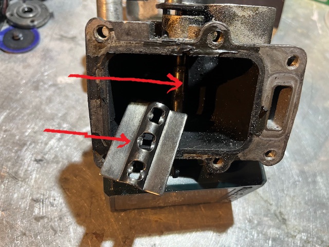

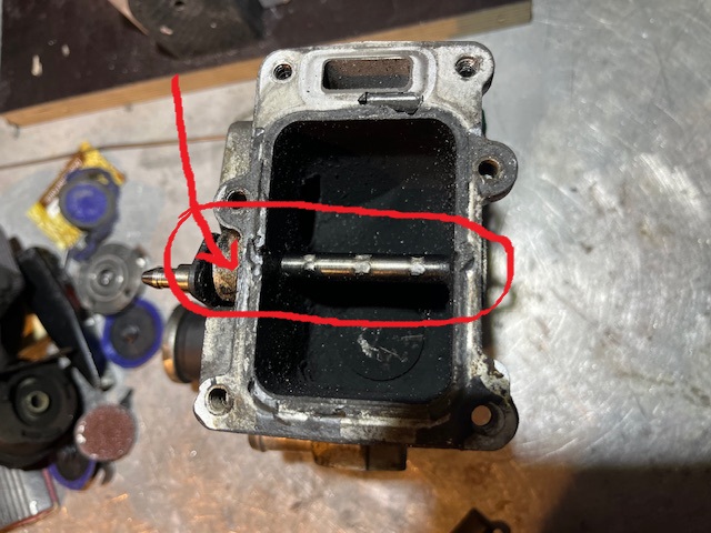

  5. Well changing the oil and oil filter every 10000 km does pay out !! And 2 minutes later hit the big 400000 km !!
  6. Yes I bought a new one ofcourse ! But getting the old one out and and replacing it with the new one was a nightmare !! BUT !!! Ive got my lovely Skoda Superb back again !! No warning lights no restricted power just smooth Skodaring ! 🙂
  7. Did you find the problem ? As I went through the check this change this clean this !! Then found out it was AGR Valve part number 045063N , fault showed PO40300, the butterfly flap spindle has seized solid , even though its made of stainless stell , and also the flap,spott welded on , had fell off the spindle .Its a git of a job and only for the brave !! Repalced it , all the lights went out and I can drive it at normal speed and no limp mode any more !! Thats why I let my mate do it !! He hasnt spoke to me since !! Good luck and I hope this helps .

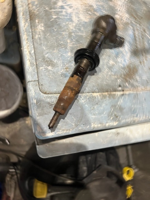

  8. I have just been told by a grownup ! That be happy , not with the rusting in the bore side , but that its a sighn that it did not leak diesel and the one you thought was healthy , ie , had a light oil covering is a sighn that the injector was not air tight ! And the number two injector is probably blocked , and take the end that goes into the cylinder take it apart , with the help of one trustworthy YOUTUBER , and clean all the jets out clean all the parts and clean all the rusty surfaces on all the injectors and coat with ,Ive been told , a silicone type lubricant .Any thoughts ? Please let ne know .Thanks Harry
  9. I have found out that the reason my Superb was in emergency mode , is because I had an injection problem ,acording to our computer test rig . After pulling it out , with the biggest slam hammer on the market , I found that the end of the injector was rusty ! Is this normal ? Then I took the other 3 out , number one was , to my eyes had slight oil on it , nothing seriuos , but all the others , and two of them where running fine , where rusty . The car was running perfectly up till then . Good starting , good mileage etc .No smoke .I have been given a used injector from an accident car , with only 1500 km on it .Just to try it out . Hope you can help , and maybe some words of wisdom !! Thank you Harry
