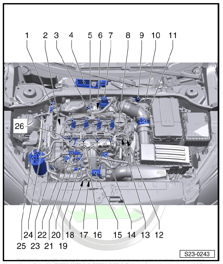

MAP = Manifold Air Pressure i.e. 'boost' sensor.
@Nas2 It's component number 18 on this diagram:

@chimaera u are a star ! That looks like my engine . Il let you know how i get on but have got a feeling will need to access it from underneath the car!
Boost sensor is best accessible from the bottom - tray needs to be removed - located right next to the thick black pipe.
You could try to access from the top - but it would be rather one-hand job ;)
That diagram would be great if there was a legend somewhere?
OP's question was about the MAP sensor: which I pointed out.
@chimaera and @jafo thanks alot . Found the sensor and changed it . Problem has been sorted ! :thumbup:
