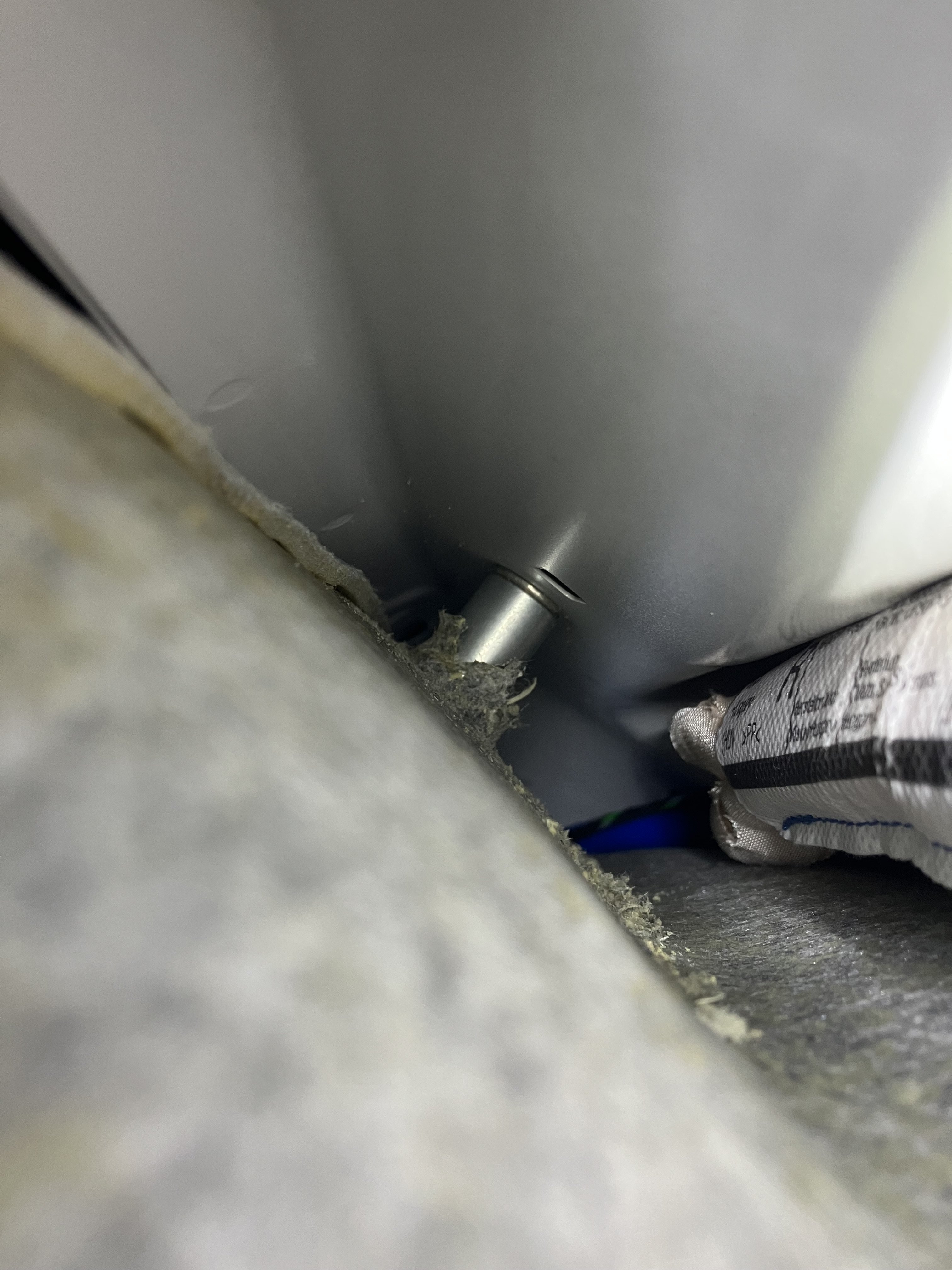

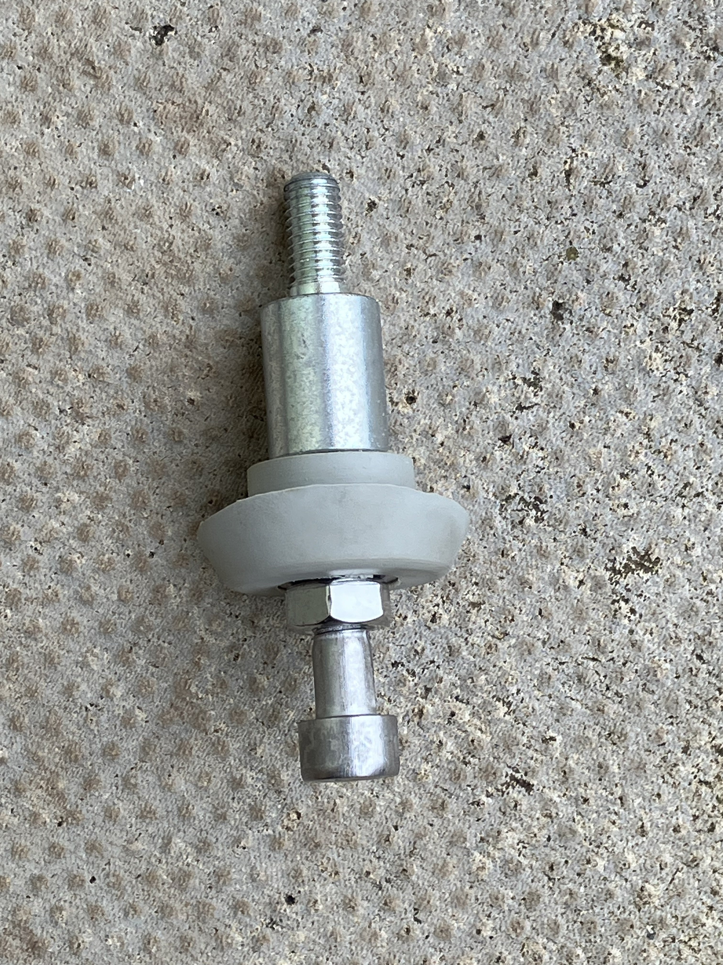

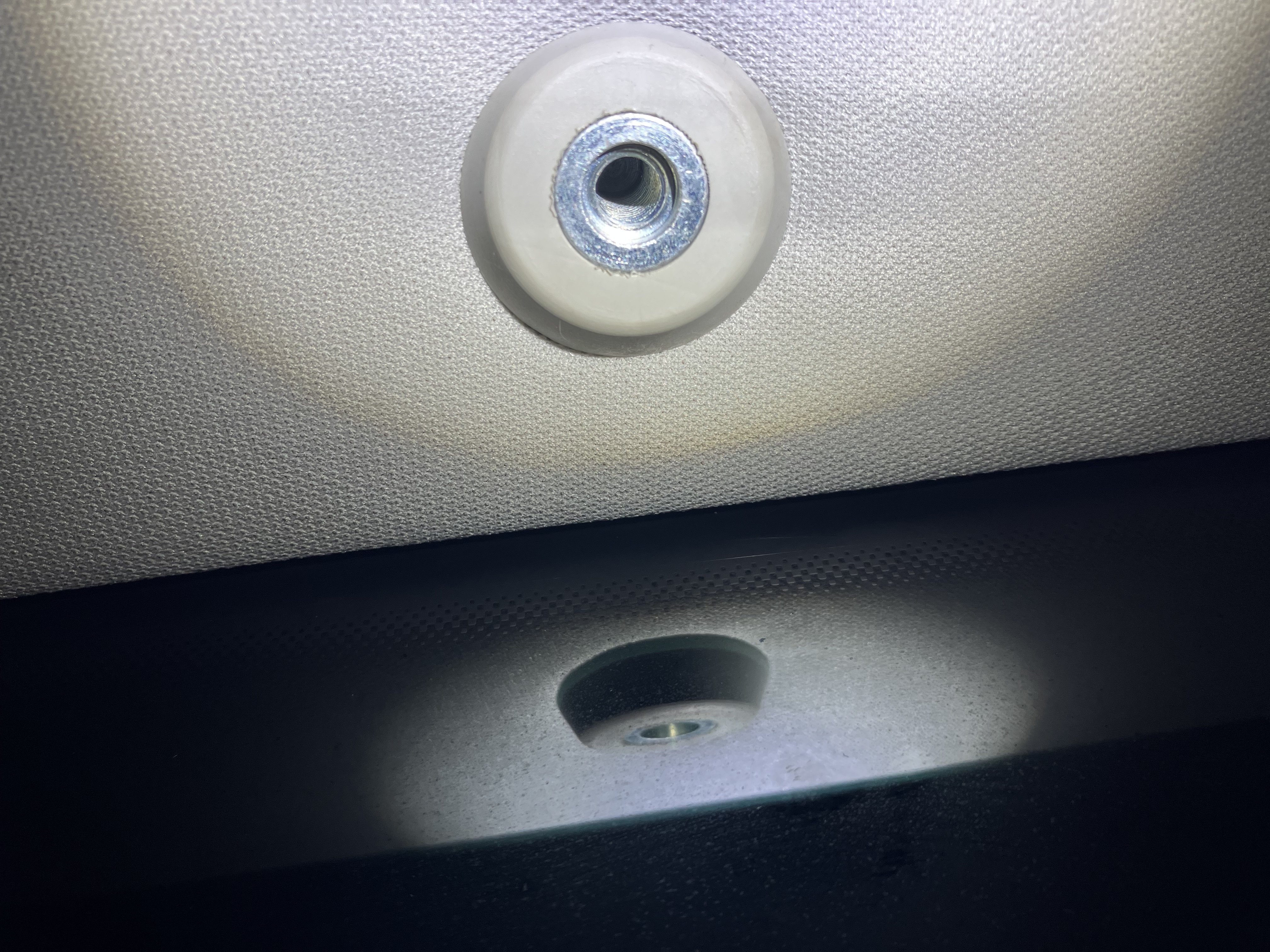

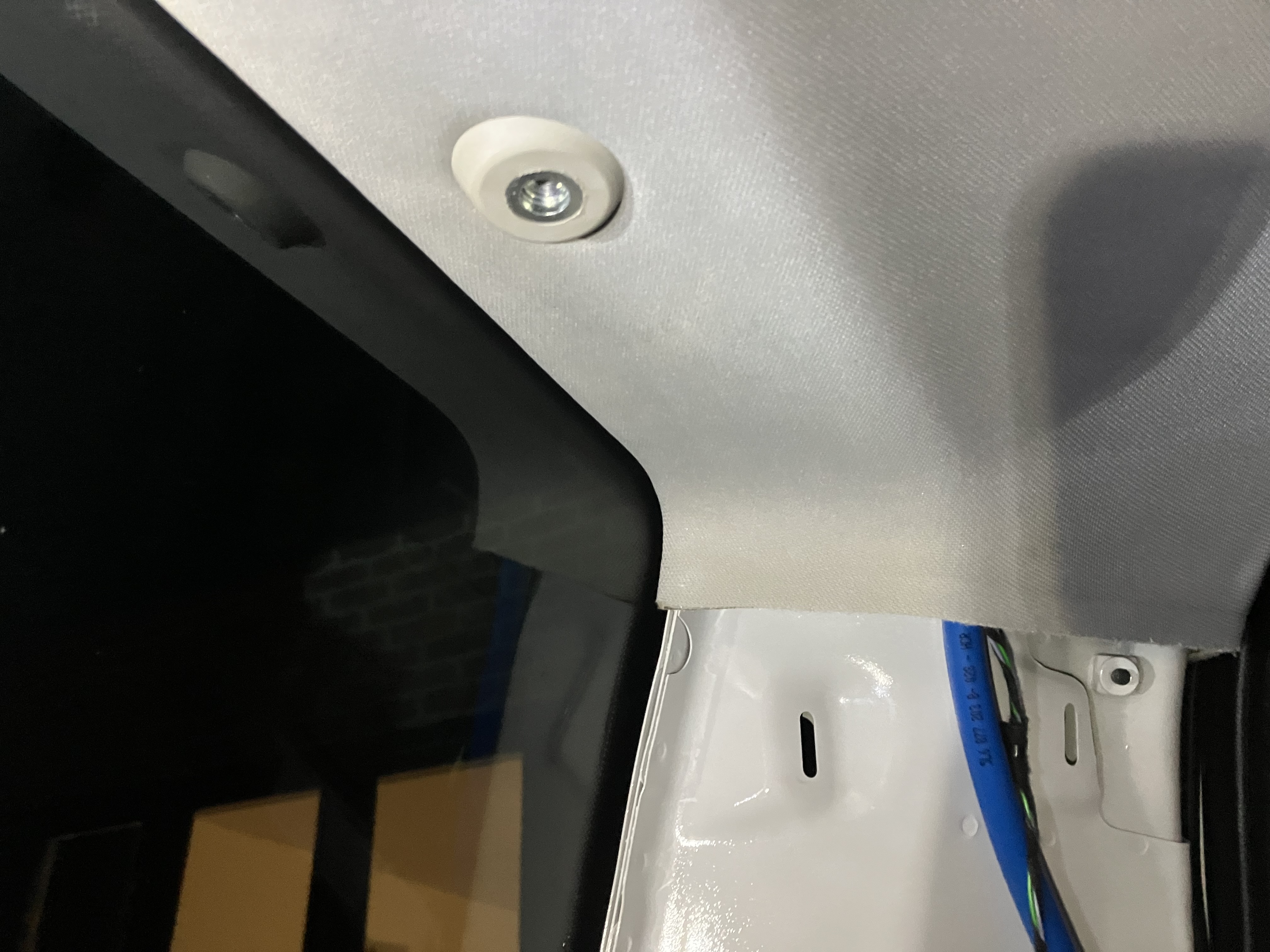

I think I follow. It’s difficult to tell by the photo I took but think the outer part ant least does unscrew. The lower fixing points are below the quarterlight windows and one of them is completely removed. This must have happened as the cage was removed prior to sale. I’ll check it out once there’s daylight. I’ve found a rod which is cut left hand on one end and right hand on the other. That will be a useful tool to complete what you first described. I just need to figure the diameter now.
Dog guard fixtures - removal - help!
Hi @Warrior193 okay this makes sense. Thanks. After posting the opener, and the LH thread occurred to me, I went back out to check. Looks like NS is LH thread and OS might be regular 🙄 Now I need to determine the thread diameter and source what you’re referring to. Such a pain to complete an otherwise ordinary job. I’ll check screw fix or somewhere. Thanks for the suggestion. It’s a big help.

Hello! I have a need to remove the headlining of my Yeti (dreaded pano sunroof leak) but it is held in place by the dog guard mounts the previous owner had installed. I assume they can be removed and wondered if a threaded bar locked in tightly may unwind it. The only issue is how do you lock another bar in tight without winding the current fitting tighter (unless it’s opposite thread but I can’t see it well enough). Thankful for any suitable advice to remove it. Weti
