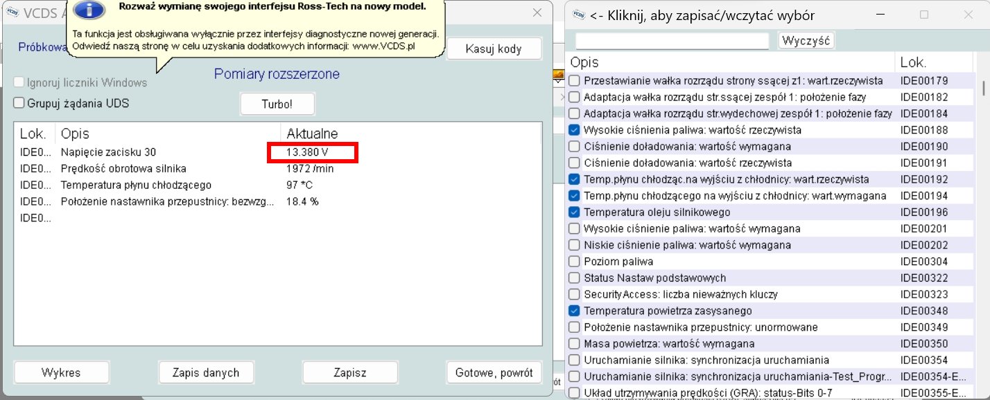

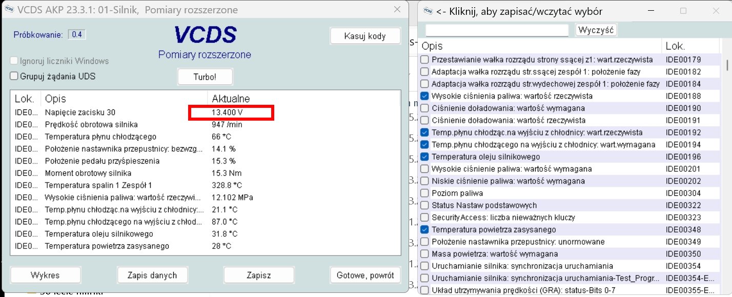

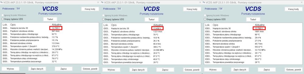

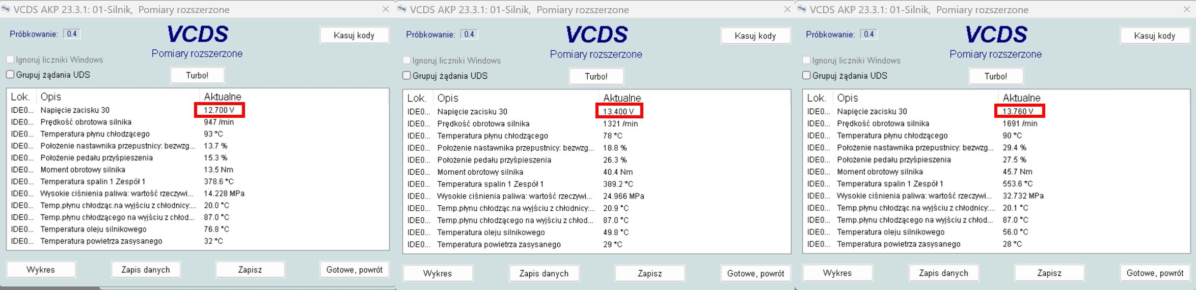

I did a second longer ride, the voltage of terminal 30 ranged from approximately 12.2V to 14.4V and it changed literally every second, randomly. Then I checked and cleaned the battery terminals, the battery ground to the body, and the entire fuse box and fuses directly next to the battery. (I wanted to check the ground on the engine, but I don't see such a ground cable anywhere) There is some result - but not entirely, now VCDS shows the voltage at idle and on the road in the range from approx. 13.5V to 14.4V (it changes randomly) Now there are no indications of 12.7V, the minimum is 13.5V, the same voltage as the VCDS indications is on the battery terminals. However, the revs were still higher (VCDS indicates approx. 950 rpm on a warm engine). Are these unstable charging the right lead in this case? Or maybe it is "suspicious" because it is 5 years old (i.e. from new) and the car has start/stop...

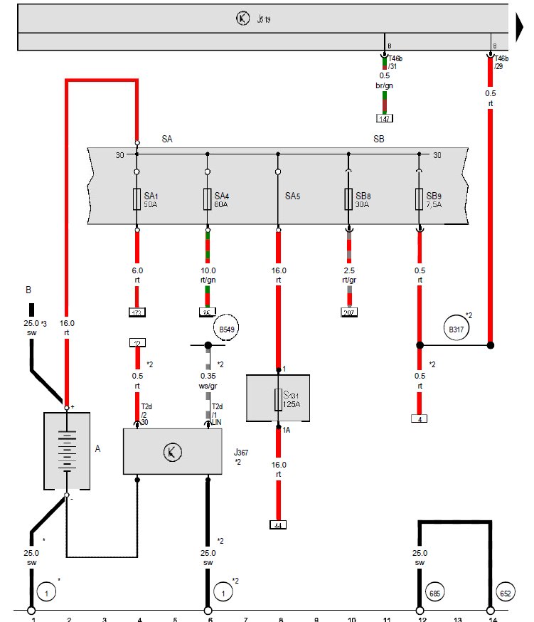

Yes, The voltage measured with a multimeter (a good quality one, Fluke, and in the "LowZ" mode, i.e. with some load) directly on the battery terminals at any engine speed is about 14.4V, and according to the diagram from Skoda Rapid (I can't find the diagram for Fabia III but I think it's the same) the main bus "30" is connected directly to the battery positive. On this bus, the ECU (via VCDS) measures and gives a voltage of 12.7-13.7 V... so something is wrong. Tomorrow I check all battery and ground connections.

Yes it's true. Today I connected VCDS (the engine has the UDS protocol) and what surprised me was the voltage of terminal 30 was very very low, from 12.7 to 13.7V! This is the main PLUS and should have the same voltage as at the battery poles (which I measured earlier and which is approximately 14.4V at idle? Perhaps this is the reason for the higher idle speed - "undercharged: battery?" This is what it looks like.
