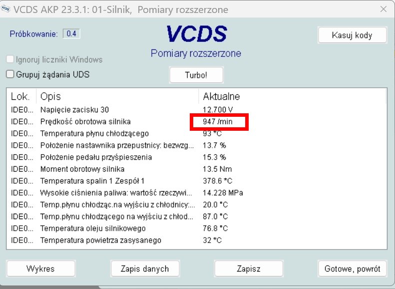

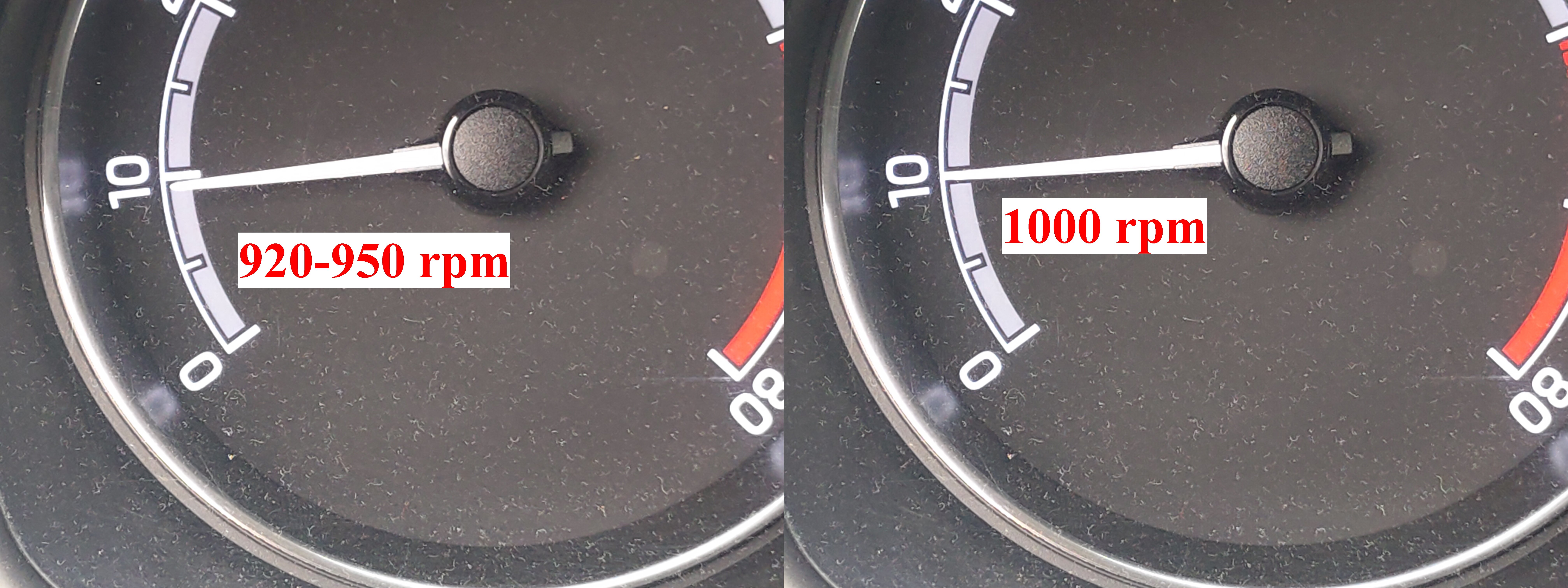

Hello. My Fabia 1.0TSI/95KM (2019) probably has an increased idle speed because the VCDS shows approx. 945-955rpm (regardless of the engine temperature), and at the same time the tachometer on the dashboard randomly shows approx. 1000 or approx. 950rpm once. (the readings differ by approximately 1-2mm on the scale, so the difference is approximately 50-100r, but there is a difference) The photos were taken from a tripod, from exactly the same angle, so there is no question of the camera's "point of view". All power consumers are turned off, the engine is warmed up. So the imprecise tachometer readings on the dashboard are a separate issue, and the VCDS displaying a value of 945-955rpm, which seems too high for this engine, is a separate issue... I have connected the VCDS dozens of times and it is always 945-955rpm. Maybe your colleagues have a screenshot of VCDS, what does it look like? Regards
