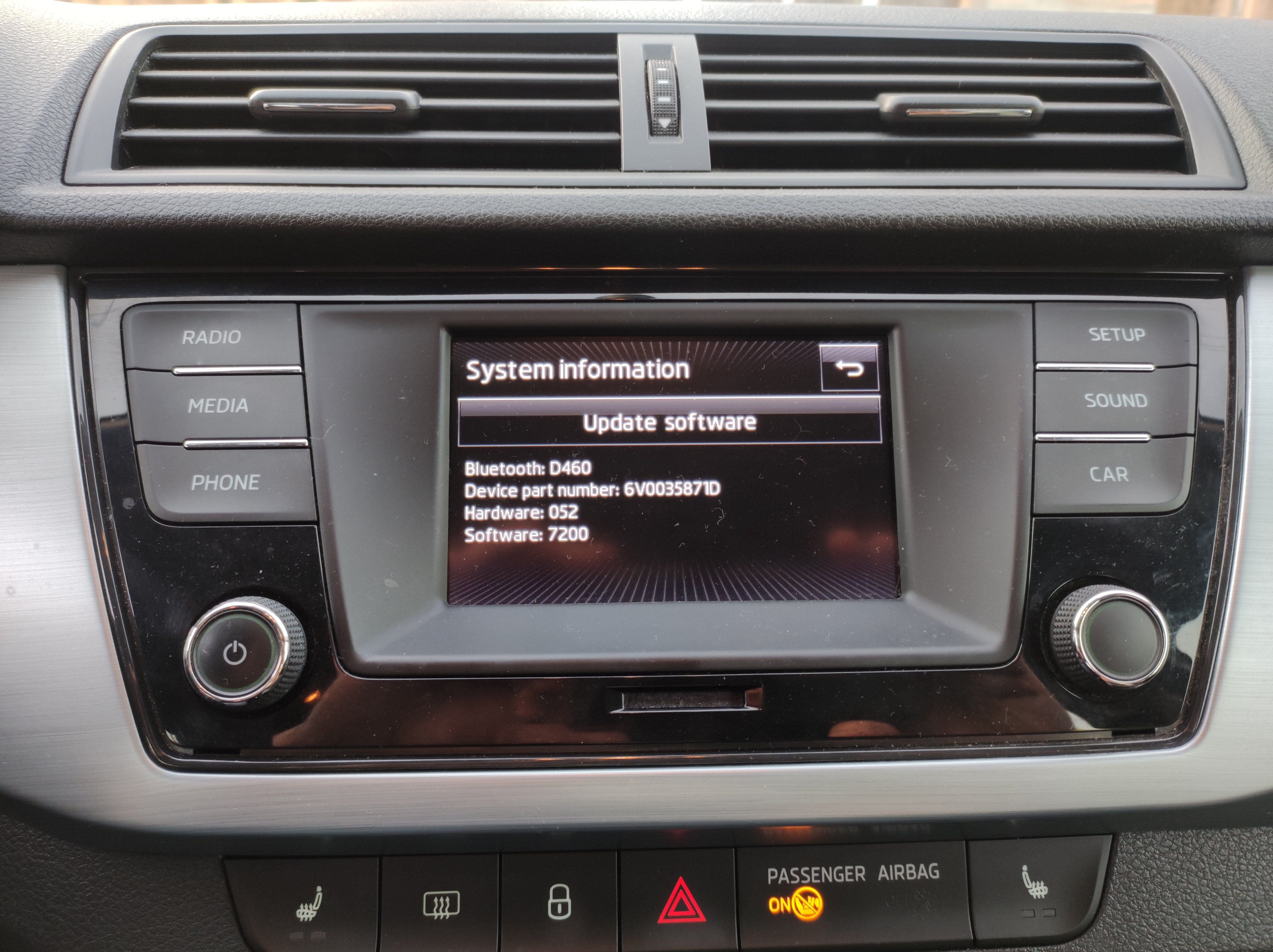

  6. Hi All, I tried to search the forum to check if somebody else had a similar problem to no avail. We've just bought a MY2017 Fabia Combi with the simple Swing infotainment system. As we have another Skoda, an Octavia, setting up Bluetooth was easy. Now for the strange part - my wife just called me that she was on the phone inside our house, the car parked outside (keys in the key drawer in the house) when she couldn't hear whoever she was speaking with. When she checked her phone the phone said that she was connected through the car, so she just selected "phone" and was able to continue her call. Did you ever experience anything similar? It seems that our car has some sleeping problems
