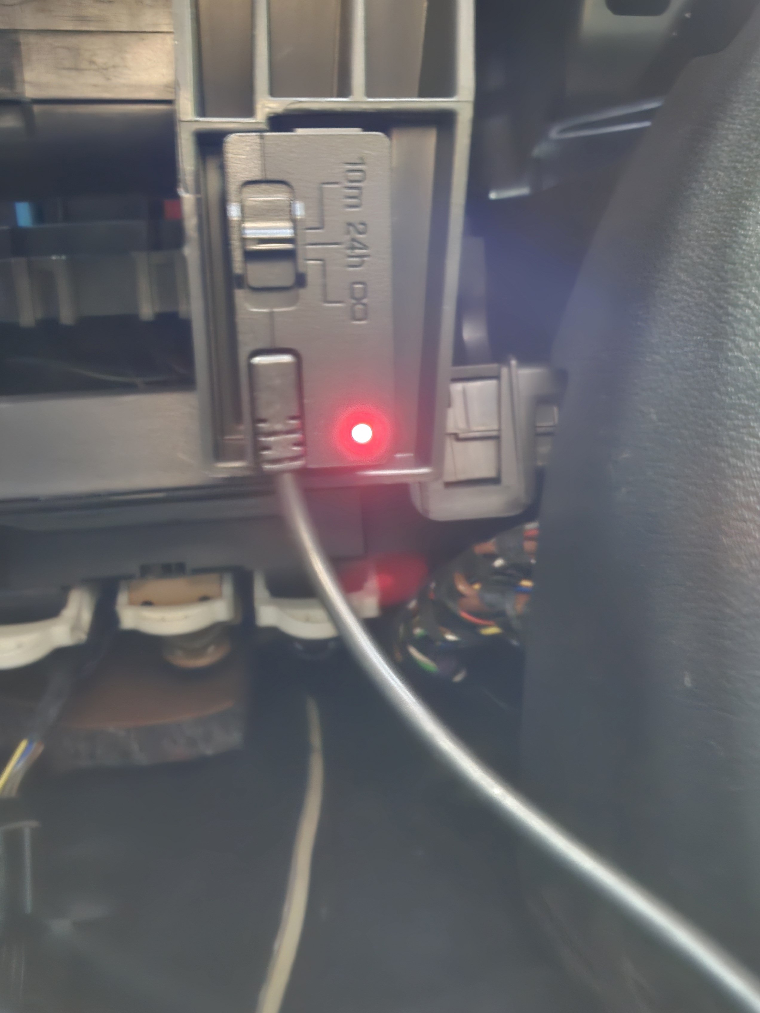

  1. Well, uninstalling the old cable took a lot longer than installing the new one. 😀
  2. Thanks, hopefully my local garage can do that. I'll sort the fuse first though. 😀 I couldn't get it out of the plug so had to put it all back in. I'm getting an OBD cable to power the new one. 😀
  3. So, I am possibly a complete idiot, but it's come round to uninstalling this dashcam, I unplugged the plug from the fusebox, got an airbag error! It must be me unplugging it surely, as it's a bit of a coincidence otherwise, but surely I didn't wire it to the airbag fuse? I've plugged it back in but the error is still there.

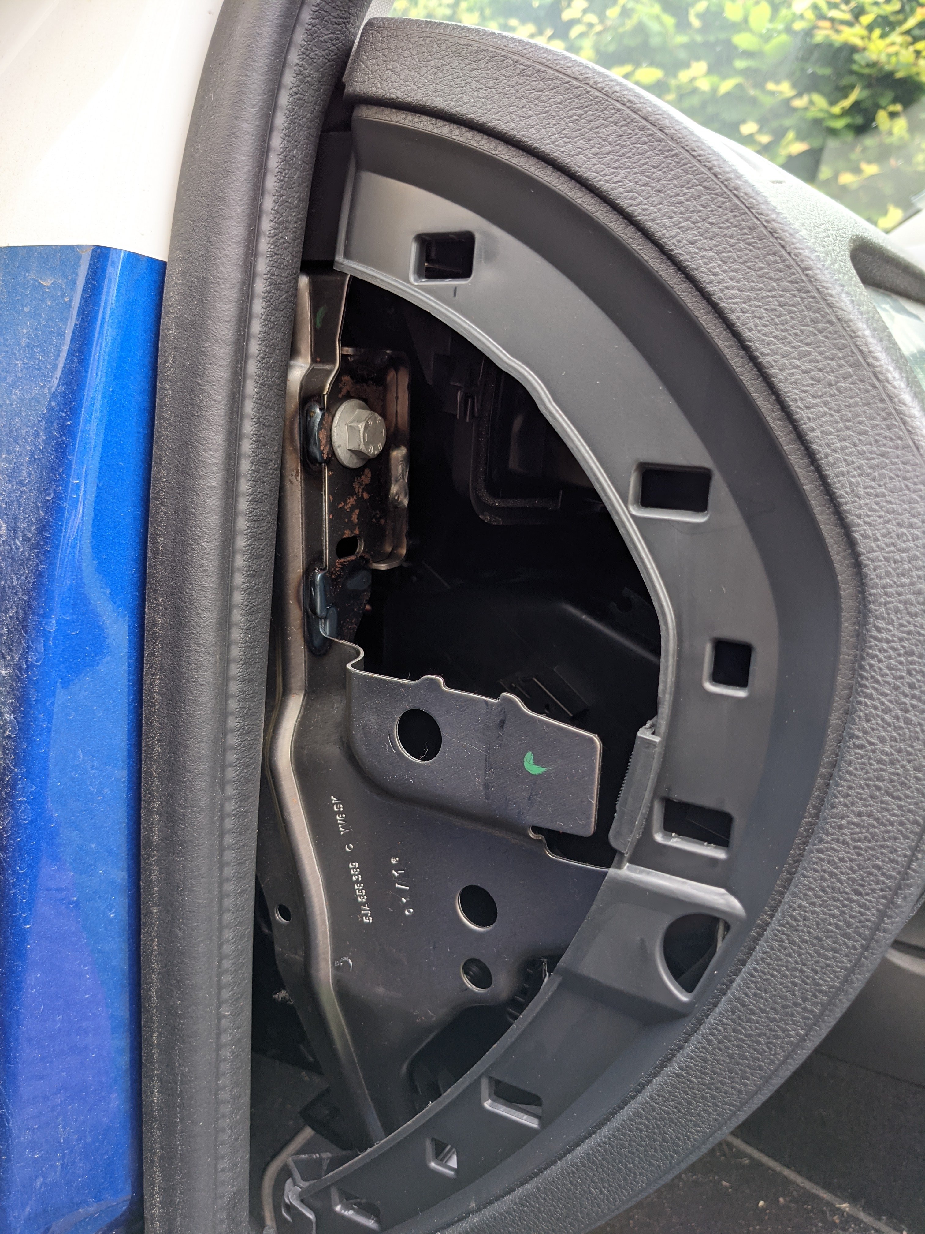

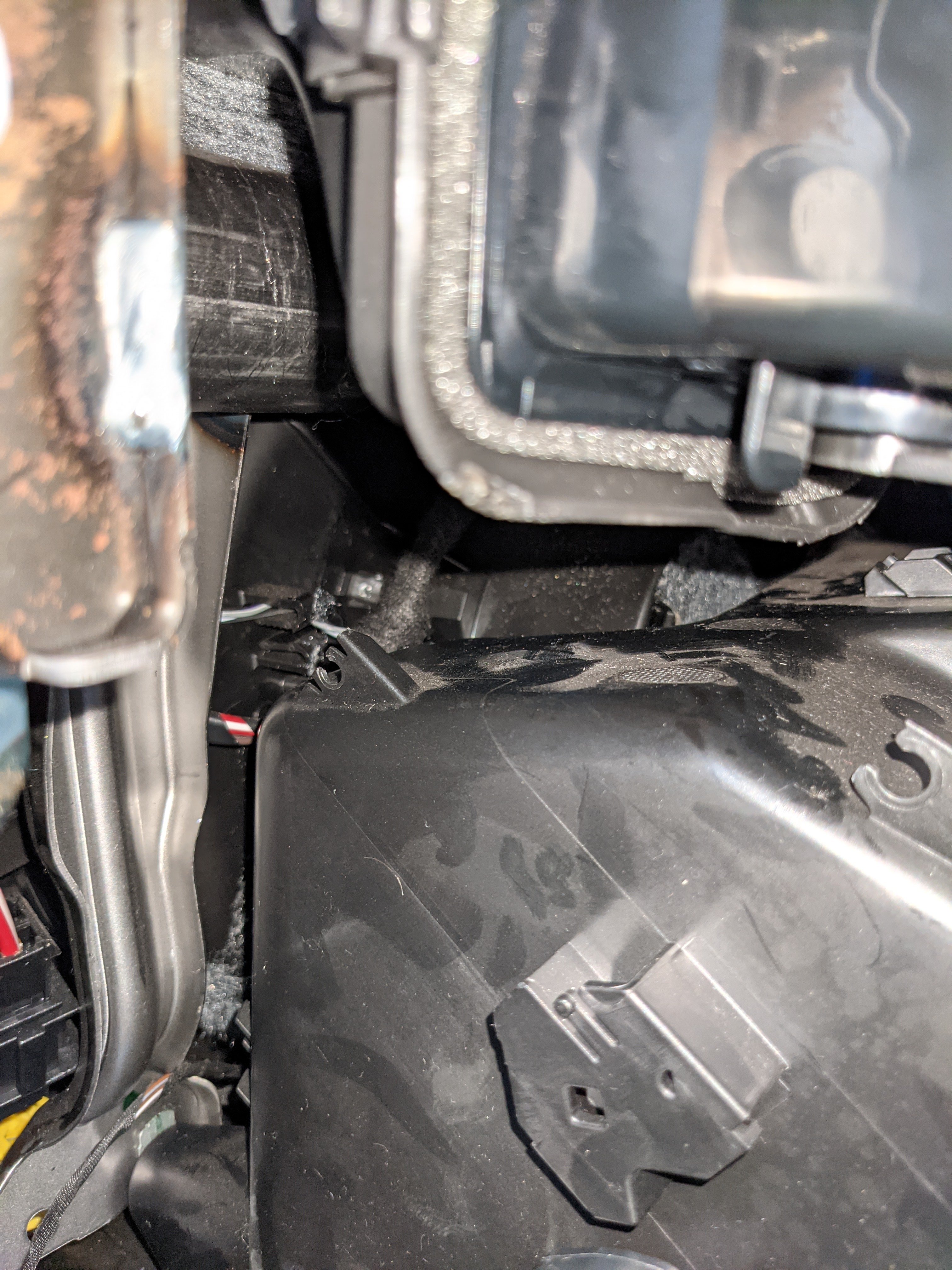

  5. I'm not sure they entirely knew. They changed the resistor and it still didn't work the first time they had it. But before they fitted the new one they stripped it all down, cleaned it up, redid the connections and it did work so they refitted it.

  7. Happy to report no petrol smell this morning. It possibly was partly caused by starting up and immediately getting stuck at the entrance of the garage for ages due to traffic. I think if I'd pulled straight out I wouldn't have noticed anything. I did notice when clearing out the embarrassingly large amount of litter in my glovebox that there was a black rubber seal lying around in there. I wonder if they assumed I would be leaving it and then when I said I needed it at the crack of dawn they threw enough of it back together that I could take it.

  10. Reminds me of the smell you'd get with the choke right out in the old days. I assume smells pass through the missing panel and no blower to diffuse it. God knows why they left it like that, I told them I needed it tomorrow and the fan isn't due in till then. Ex demo car, 400ish miles when bought, 60k more since.
  11. Does explain the intense petrol smell on starting though!
  12. Other than that they went in through the side and haven't attached the glove box properly, I'm not sure you can see much? Maybe half was an overstatement. 😀 They have disconnected or turned off the passenger airbag too.
