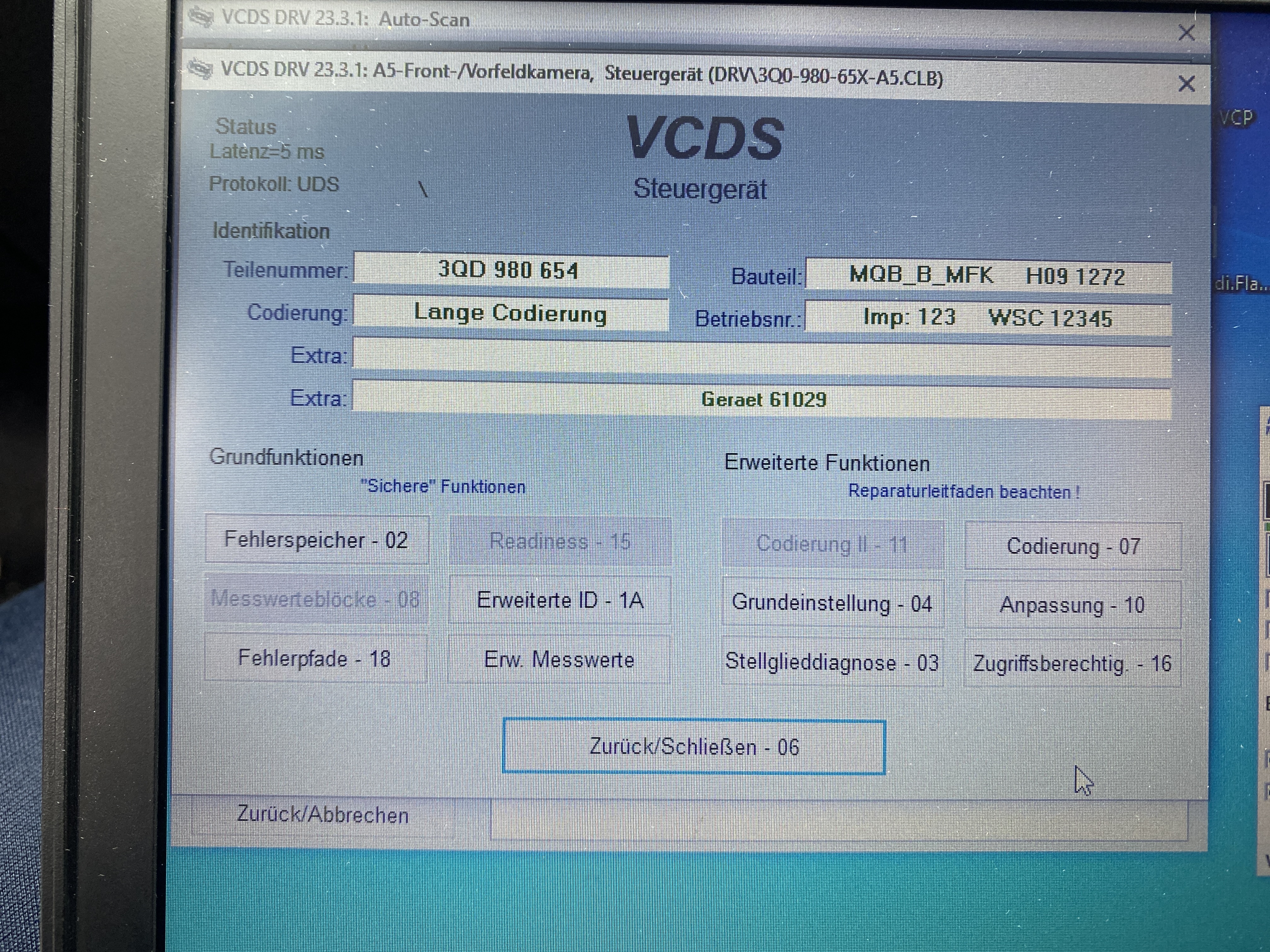

  6. Hi, i changed the headlamps to Model B. I changed the 8U0941329 against 4H0941329. The other Moduls i took from old headlamps. I coded the 09, Shutter (Leuchte 10 and 11) disabled, Eyeleashed enabled (Leuchte 16 and 17). I coded the 09 for DLA and i coded the A5 Byte 21 to Hex 40. After that i trided to flash the dataset for my 4B. After flashing there was a Error in 4B, invalid dataset. To rescue the situation we flashed the 4B to SW 0246 and took a Dataset from another car with DLA, work done with ODIS. Now i can not run basic setting and the error is shown in Unit 4B "no basic setting". If I try to run manuel the basic setting, VCDS, OBD11, ODIS say, "conditions wrong for basic setting". Every time i start the car i can see and hear he is trying to run the basic setting. Even when i delete the fault in 4B, directly ater deleting he is trying to run basic setting an the fault comes back. I dont know what to do now 😞 Maybe try to flash on 0285 and try Dataset you send me. Adresse 4B: Multifunktionsstg. (J745) Labeldatei 3Q0-907-338-V1.clb Teilenummer SW: 3Q0 907 338 HW: 3Q0 907 338 C Bauteil: FCM MQB Low 002 0286 Seriennummer: 23101811601588 Datenstand-Nummer: V03935274LG 0001 Codierung: 000000020100066A02007F01000000000000000000000000000000000000 Betriebsnr.: WSC 12345 123 61029 ASAM Datensatz: EV_MultiModulContiVW48X 001010 ROD: EV_MultiModulContiVW48X_001.rod VCID: 72BDDAD5042CDF4A09F-8026 Leistungsmodul für Scheinwerfer links: Subsystem 1 - Teilenummer SW: 4H0 941 329 HW: 4H0 941 329 Bauteil: Leimo links H02 0013 Codierung: 000000 Leistungsmodul für Scheinwerfer rechts: Subsystem 2 - Teilenummer SW: 4H0 941 329 HW: 4H0 941 329 Bauteil: Leimo rechts H02 0013 Codierung: 000000 2 Fehlercodes gefunden: 13705479 - Datenbus fehlende Botschaft U1121 00 [008] - - [Kamera_FDD_Obj01 data bus missing message] Sporadisch - bestätigt - geprüft seit letzter Löschung 0032 - Scheinwerfer C107E 54 [137] - keine Grundeinstellung Warnleuchte EIN - bestätigt - geprüft seit letzter Löschung
  7. Hello, i flashed my 4B unit to 0286 and could install dataset via ODIS. Now I cannont run basic setup in 4b and i think there is a wrong coding in unit 4B or Unit 09. Can somebody send me please Adpmap and Autoscan of Unit 09 und 4b? regards.
  8. I build the new Xenon Light. Coding Unit A5 und 09 succesfull. Problem was flashing 4B. Now I have the ERROR "Dataset implausible" in Unit 4B I flashed with this selfmace .xml for VCP. (attachment) I can not code the LeiMo Units, also Error LeiMo left und right not coded. I think maybe the ALFID is incorrect. I tried with 44 and without any ALFID. Can anybody help me? 4B_3Q0907338_VCP.xml
