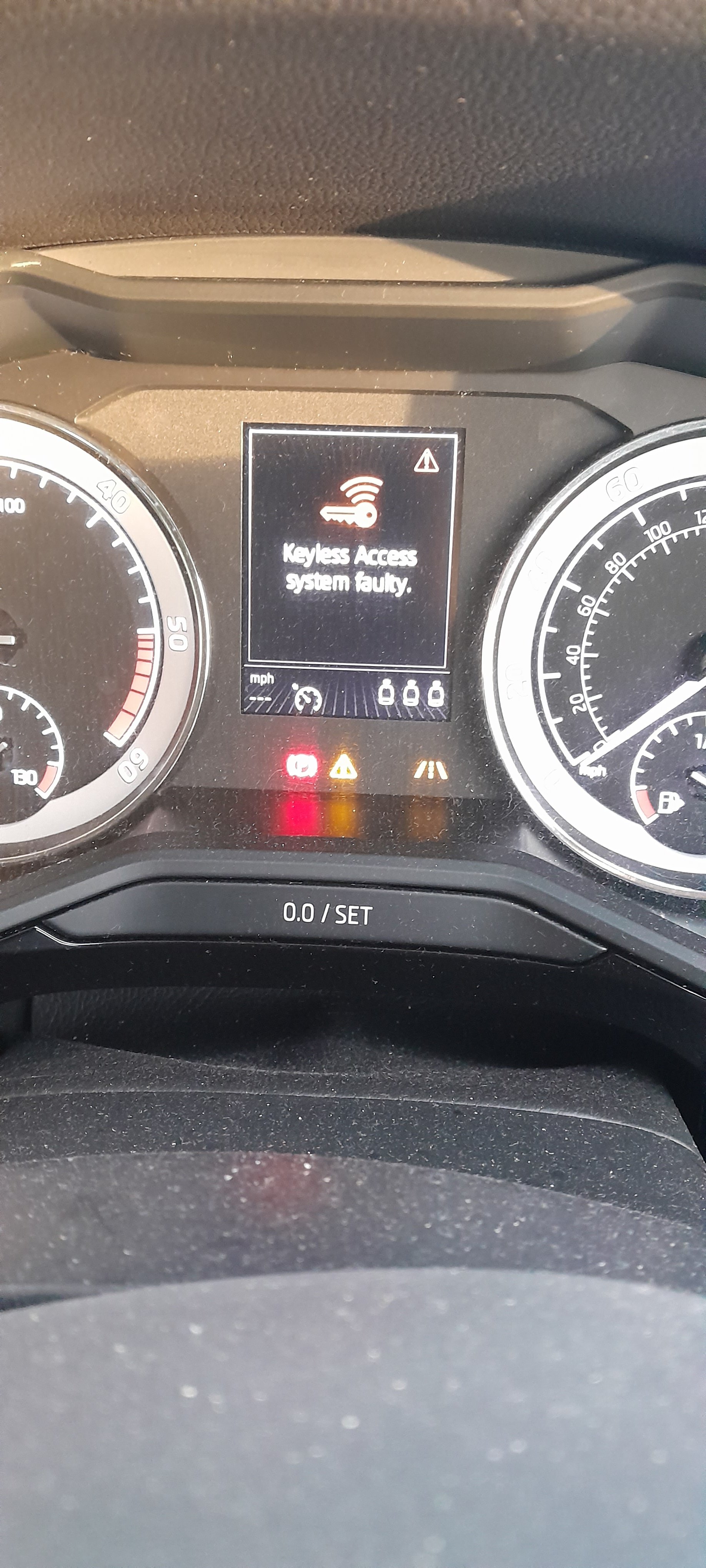

  3. Hi there I am getting this fault showing up,see photo, I can only unlock the doors by using the buttons on the keyfob. Car starts ok but the said warning comes up, when I press the lock button on the keyfob it goes away for a while until a door is opened or engine switched off and then restarted. My car is a Superb estate L&K 4x4 2017 Anybody know how to remedy this issue.
  4. Yes we had a lot of rain over a couple of preceding days but the temperature dropped quickly during the night. I've had the car from new and that's the first problem I've had with it.
