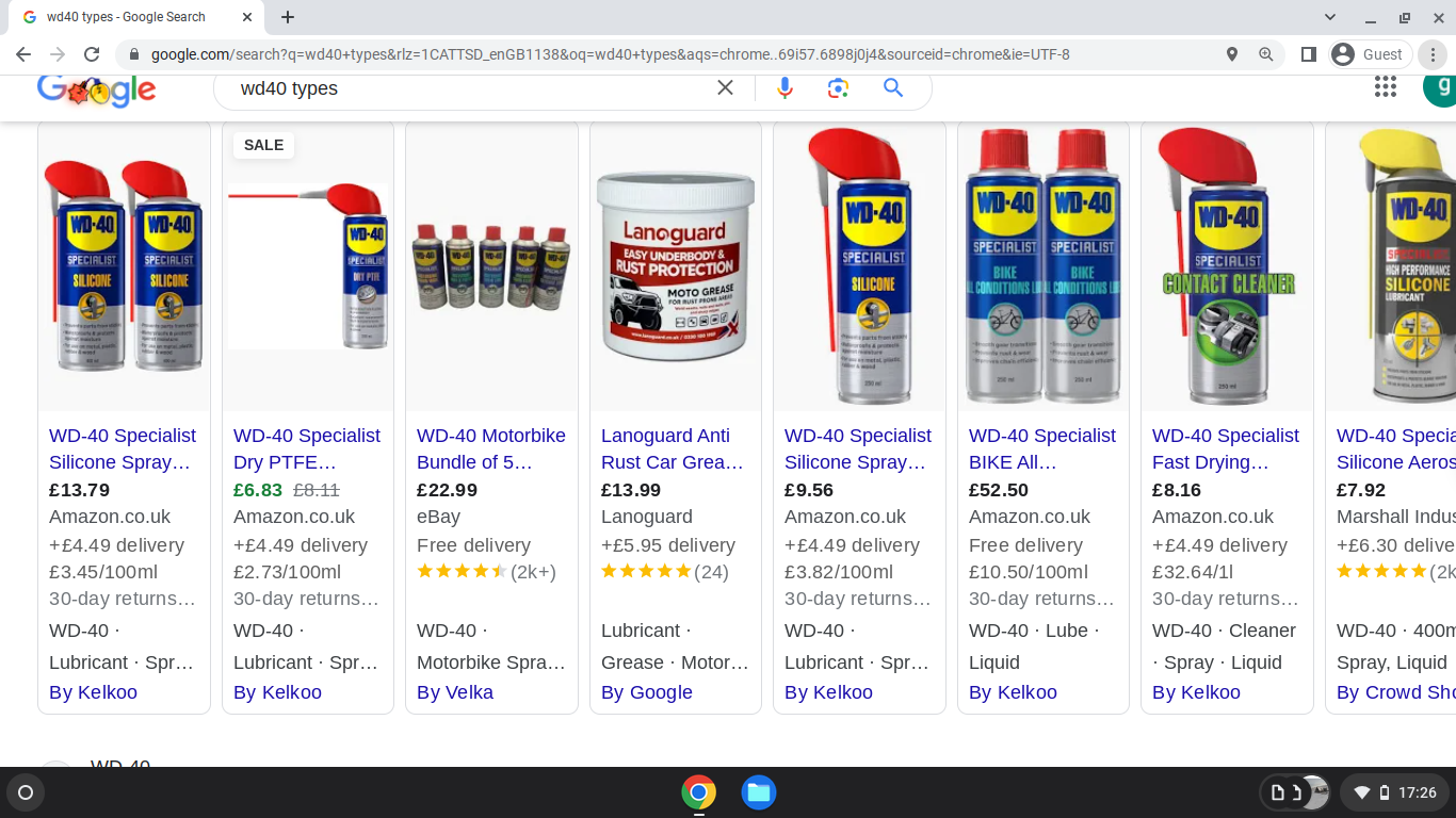

^^^ That was / is the 'Original' WD40 there are various now..
The original WD-40 they call Multi-Use and it's not long lasting as a lubricant, good for flushing crud but doesn't leave a long lasting lubricant, the other WD-40 cans they call
WD-40 Specialist®.
WD-40 Company also have the brands of 3-IN-ONE® and GT85® and others.
