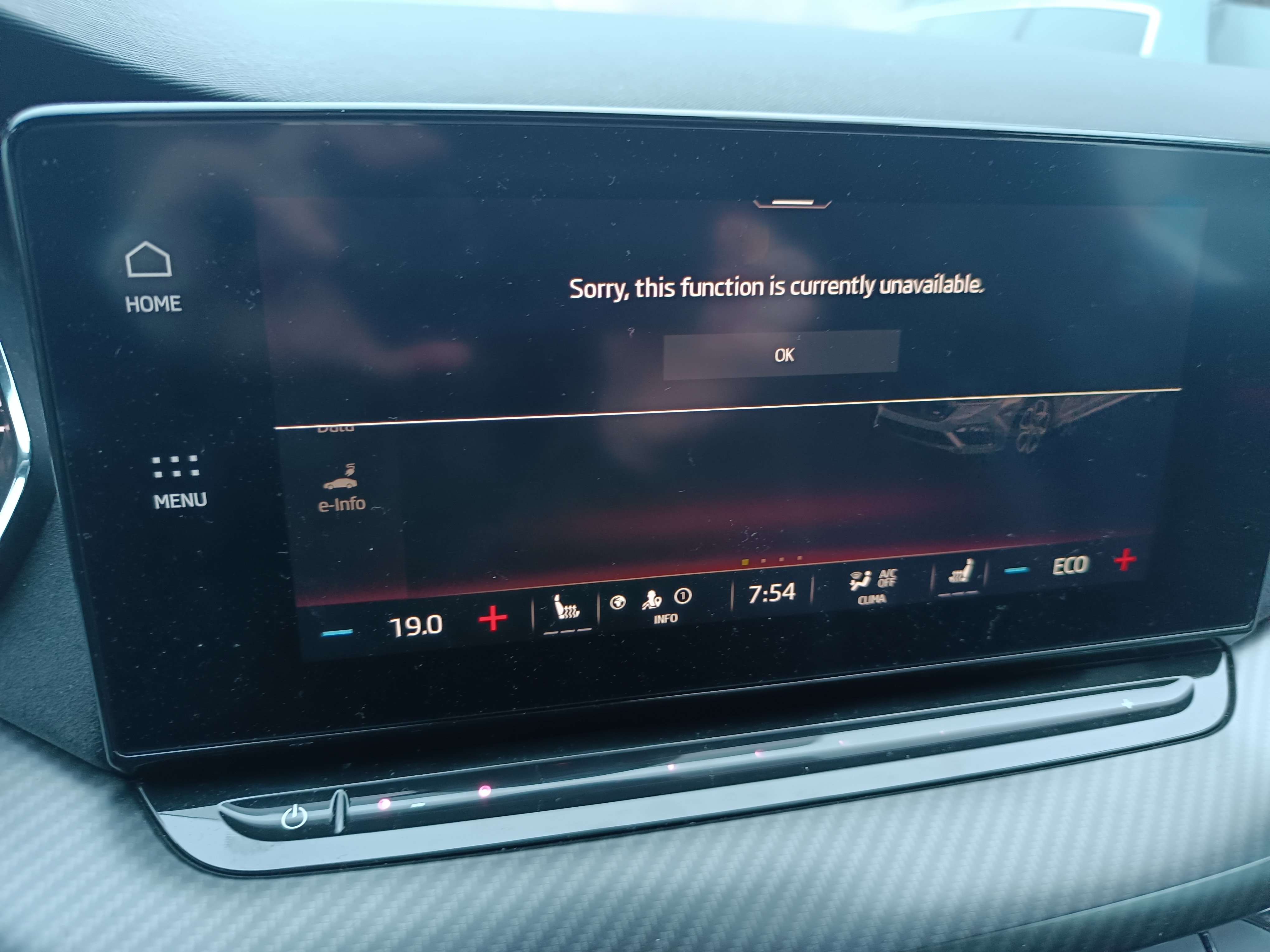

E-manager not available
Hi everyone, Just in case (may read in one of my other post that links to this) someone has above issue, mine was fixed by dealer. The issue appeared right after 1941 software update. Went back to dealer, they could not resolve at first but finally did a reset by their tester to the software and now the e-manager menu is back and works again.
Hi All, Have you ever met the e-manager function not available? The charging settings in skoda app still working with plans too, but in the infotainment not available and this happened roughly afyer 1941 software update. Any fixes?

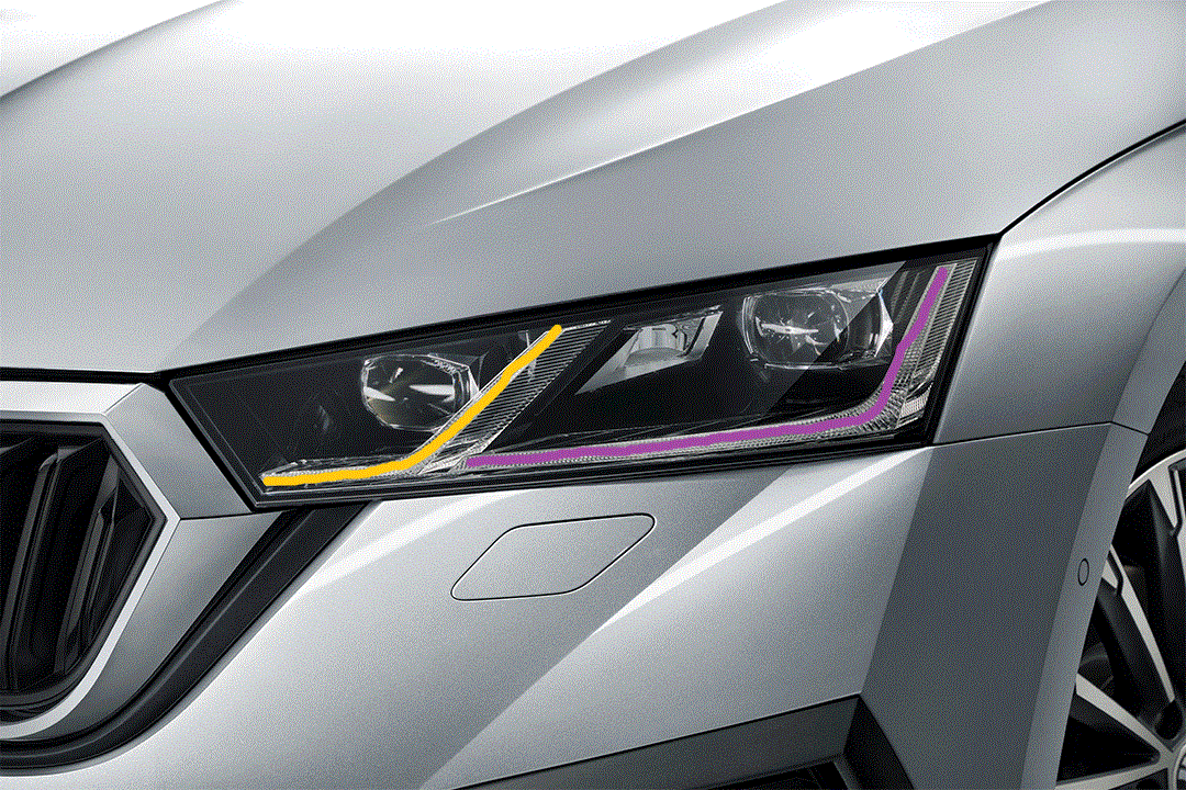

Matrix headlight signal colour issue
- Matrix headlight signal colour issue
Hi there! I am new here and a happy owner of my new Octavia iv vRS PHEV. Today I have faced a weird issue of one of my matrix headlights. The signal light used for daylight too is comprised of two parts. When signaling both should turn orange but the one on the side is purple (light intensity is ok) and the other towards the center of car is orange (this one is fine). Have you guys ever had this issue and if yes, what is the culprit and how did you fix? Thanks! - Matrix headlight signal colour issue
