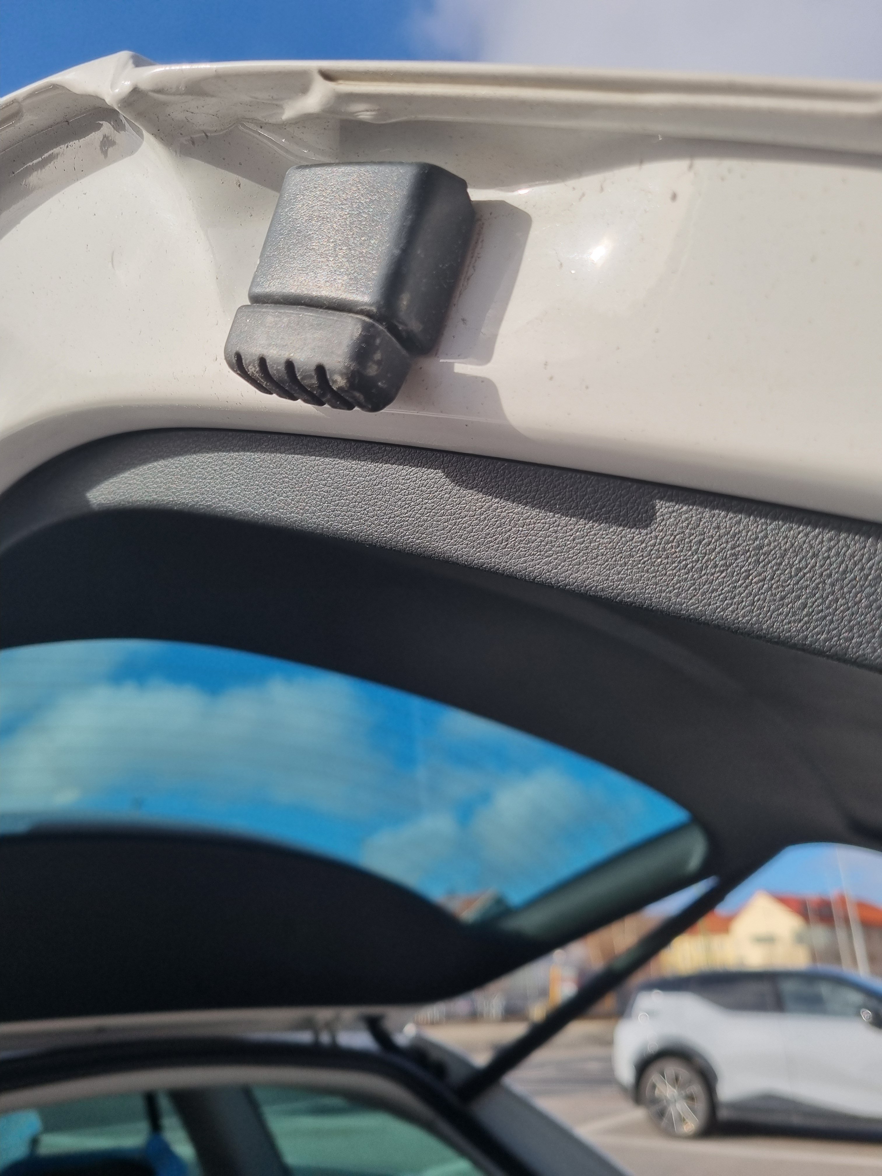

  17. I have following damper on my Octavia Mk3, MY 2020. Adjustable? Which Volvo damper are we talking about by the way?
  18. My stoppers does not look like that. I have a 2020 model MK3. Maybe they changed them from 2018. Would be interesting to know if I could do any adjustments.

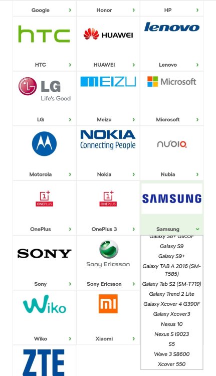

  19. Yes, the tweeter on both front doors are cracking when playing high volume. I tested playing songs from IOS unit, still cracks. I adjusted the "fader" balance to the rear, the crack sound vanished. As soon as I balanced 50/50. The tweeters started cracking again. Its not during the whole song, more when the bass in the song drops. BTW, one thing that I noticed. I checked the compatability phone units for the Amundsen system. Samsung S21 was not in that list. Whats does this mean? Not even Iphone 11, which I tested with, was in the list. See attached image!
