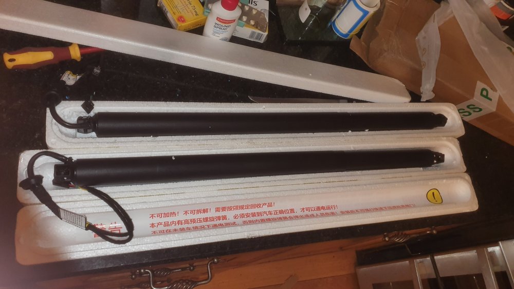

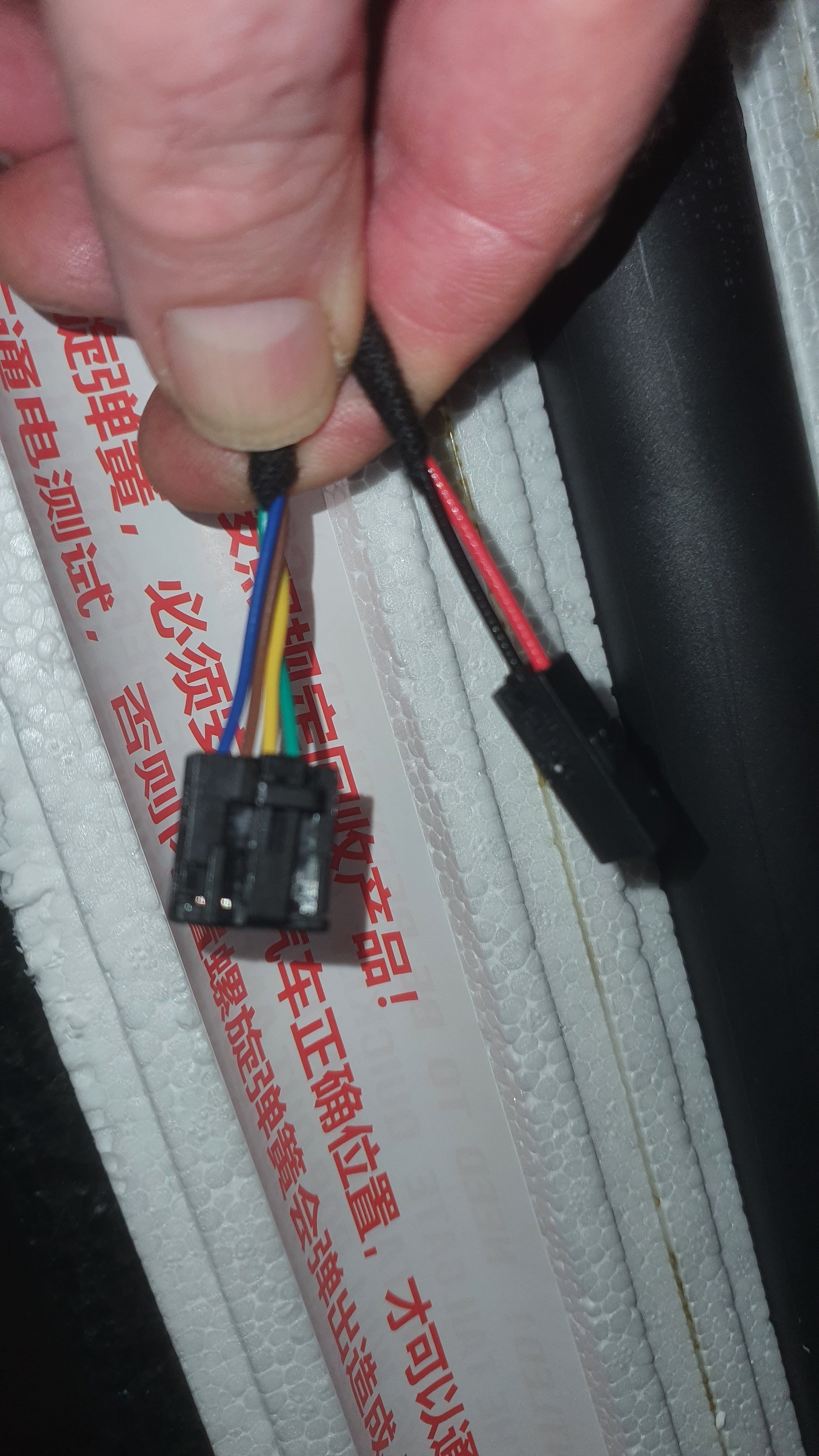

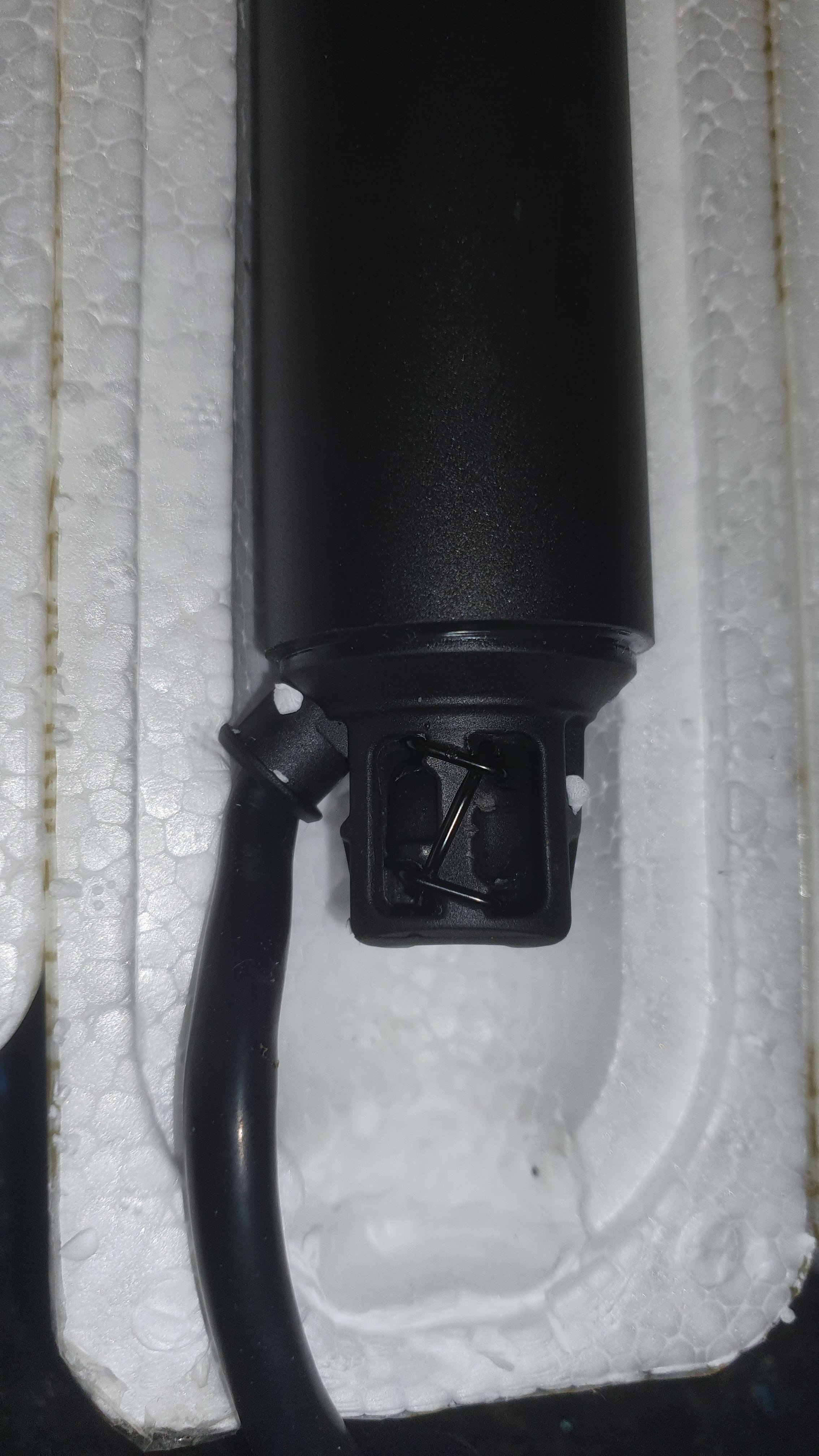

  1. Ok so fitting the pistons is really simple take off the covers simply pull them off. Feed the two electrical cables and Disconnect. Unclip the pistons top and bottom. Fit new pistons a half hour job. The pistons are larger but fit perfectly.

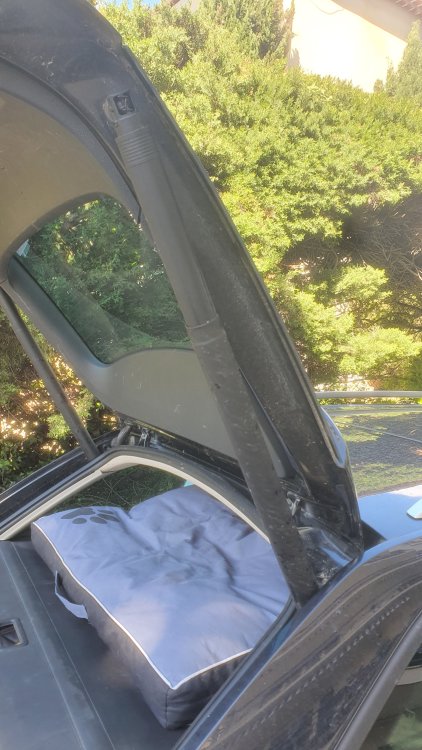

  3. So my new electric boot struts for my Octavia 2013 arrived today so I will fit them tomorrow. WARNING WHEN I removed the old ram I disconnected the battery and unclipped the power connection to the left hand piston / ram I then unclipped the top of the piston. As I undid the top clip it exploded firing the top of the piston and the spring 40 feet down the drive onto the road. Fortunately it did not take my eye out which it very easily could have. When I terreved the ram I found the threaded joint between top and bottom of the ram had the screw tread stripped bare.
