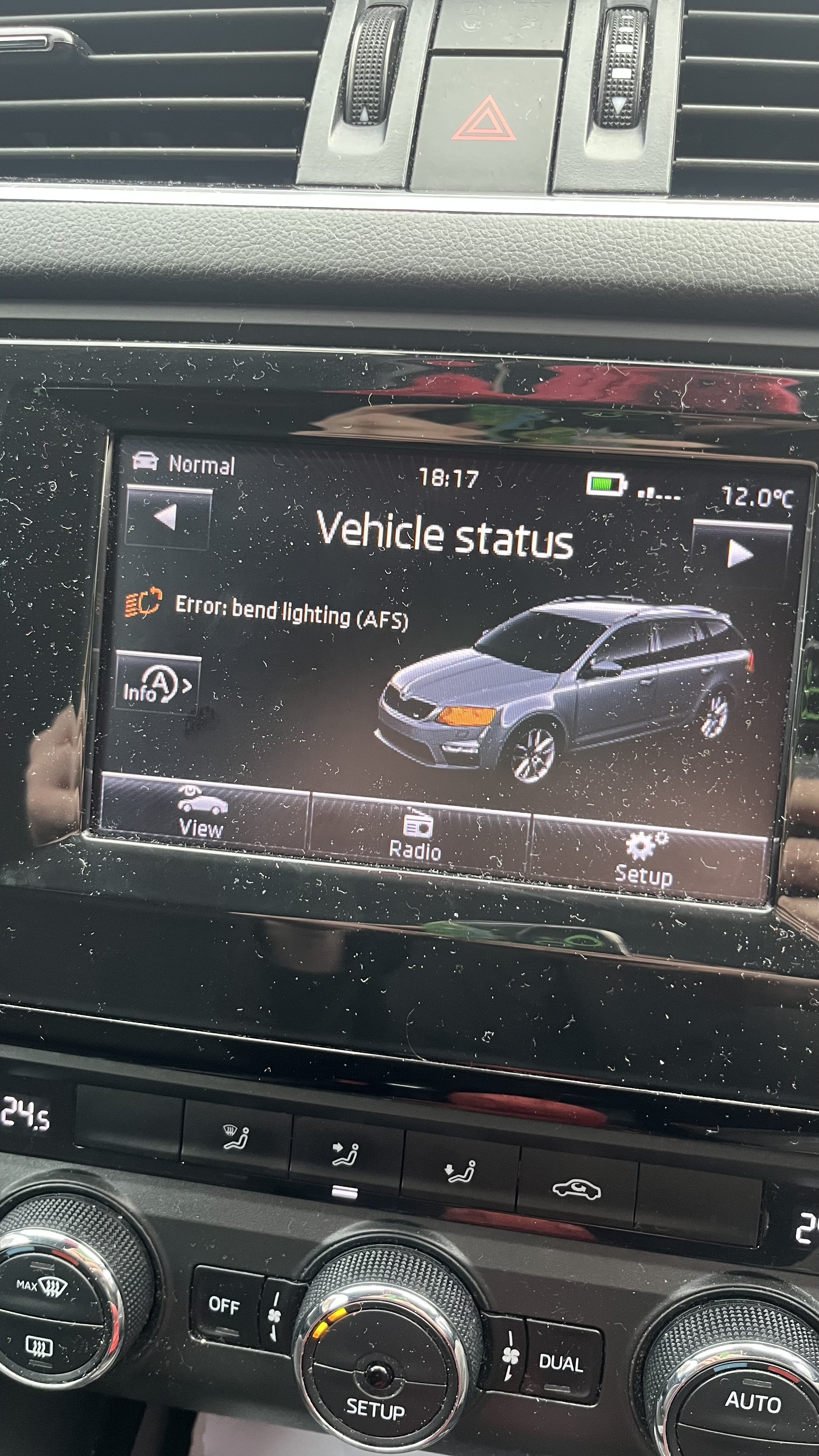

  1. Just looking for some guidance. I’m getting this on my dash, and it only seems to pop up after I’ve been driving the car for a while Looking to see what the suspect could be because when I look I’ve seen it either could be a bulb, the sensor on the arm, or a module … I’m leaning more towards the sensor on the arm. Xenons work fine. And it does its little dance in the morning. The sensor however looks very worn and very loose … Anyone who’s had the same problem let me know how you fixed it

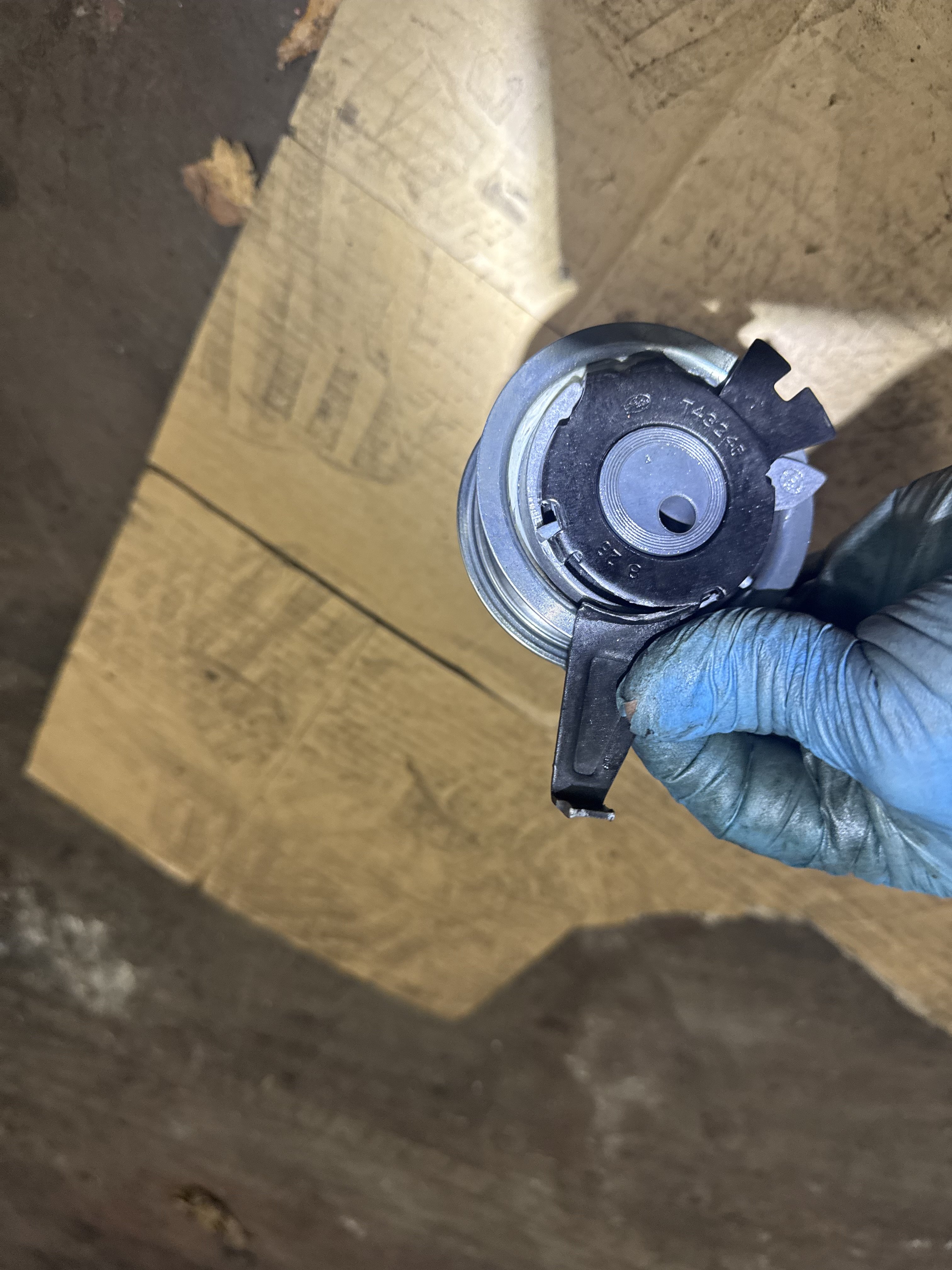

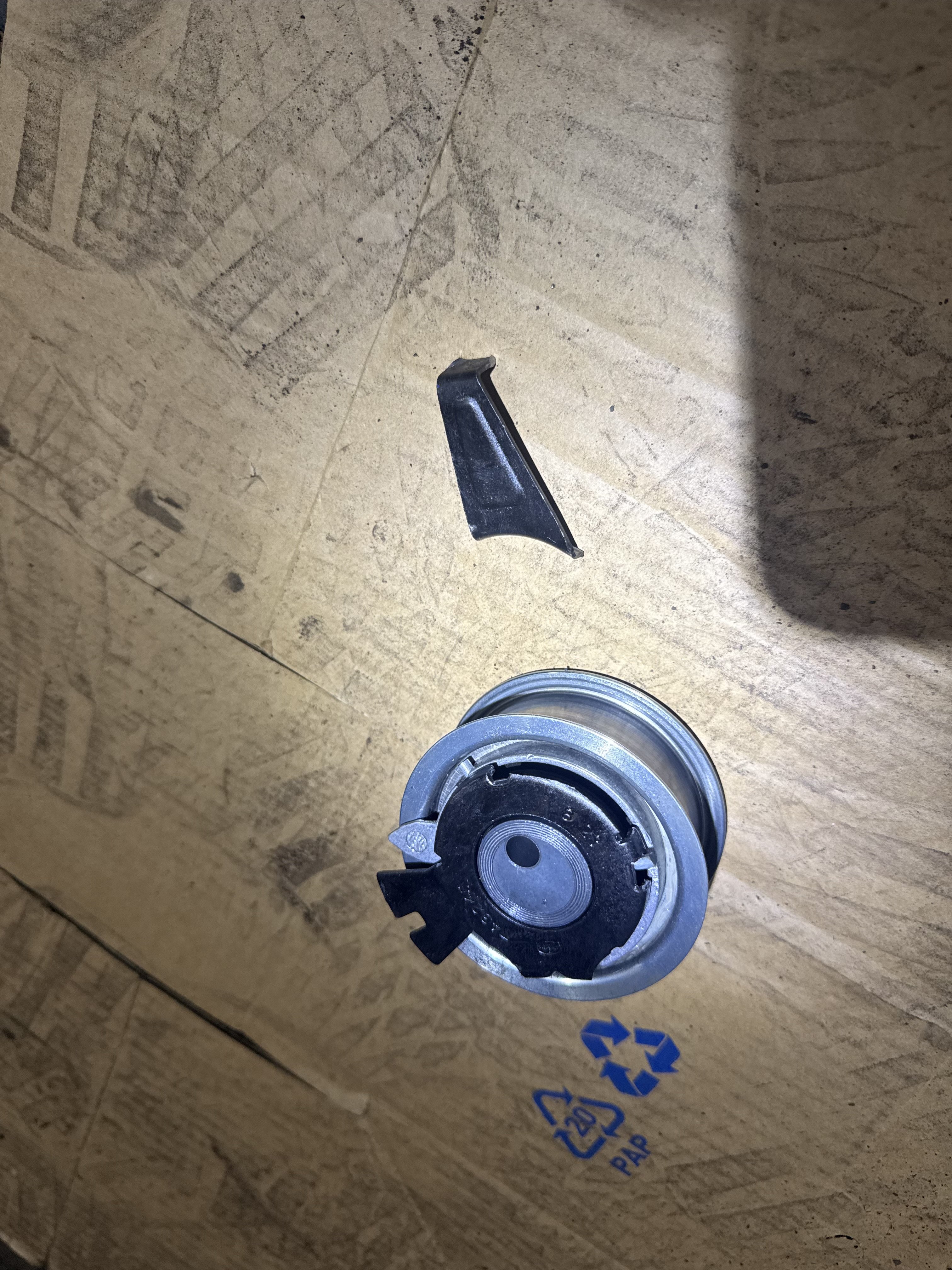

  2. Hi guys so what a week?! Monday my car threw a wobbler I’ve only had it a year Started off with a strange fuel leak on the rail, then randomly at the same time my tension pulley for the timing belt snapped … luckily there is no damage to my engine after slipping two teeth.. has any body else has issues with the gates products ? The garage that installed the cam belt in the first place swear down they have never seen this yet the Audi specialist who did the belt said he’s seen this quite a lot with gates? … I need some answers

  5. Hi mate I actually changed the ballast, I’m pretty alright with abit of DIY on my car (I did own a Ford before) so I have a garage full of tools lmao! But the ballast did the trick for me there’s two on the headlamp one for the DRL and one for the main lamp… I didn’t wanna pay £100 for a bulb so it was cheaper to try the ballast first it worked for me and has been working great for a few months now and you only need to unhook the bumper on one side it will give you enough room to remove the lamp. Rather than unscrewing both sides from the arches witch is a pain it’s easy to just do one

  10. Hey guys, I’ll update you I bought a new module off eBay… and alas it worked. Does look like it got some water inside … and it was the left. Didn’t need to fully take off the bumper, just get it away just enough to move the light out. £50 all in all.. better than going to a garage

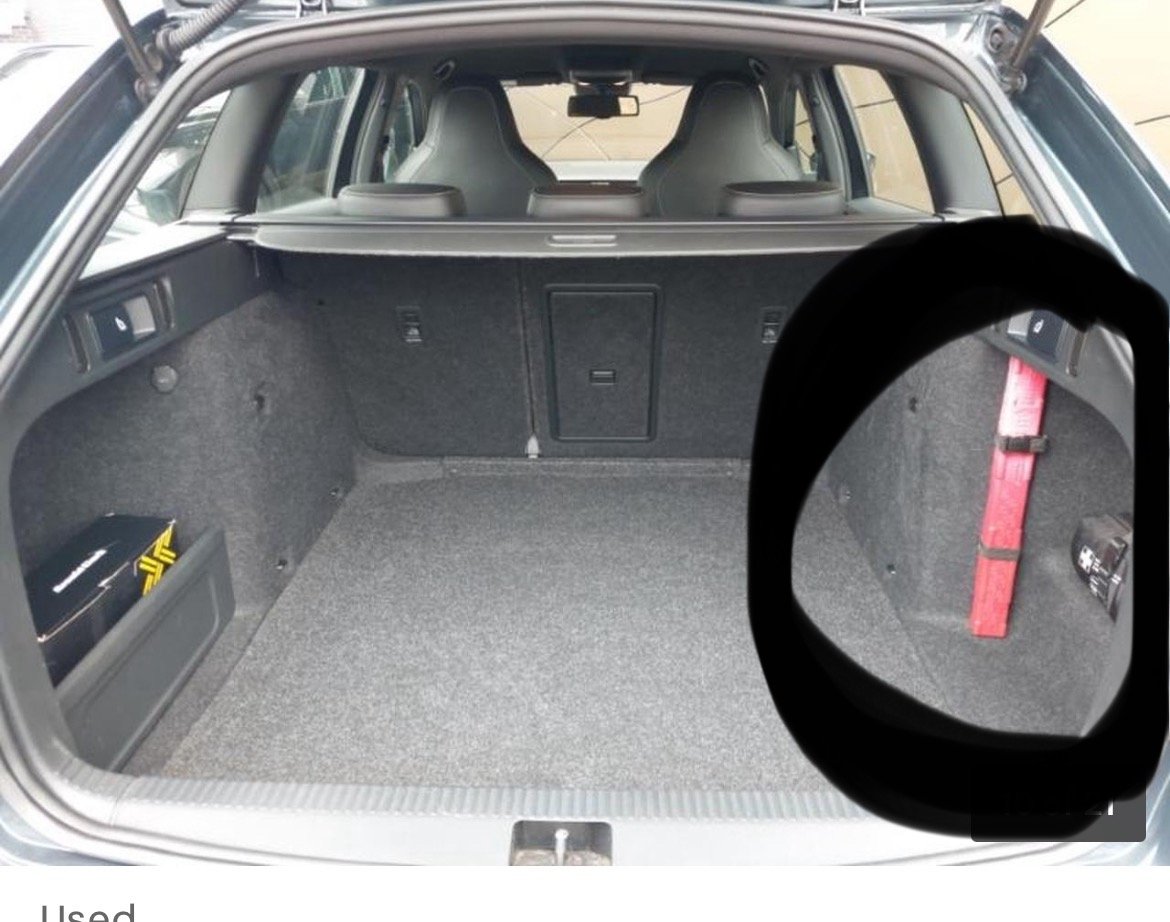

  14. Ahh yeah! I may pick myself one up then. Do you know what the other thing is?. I’ve put my car pump there as it fits perfectly
  15. I’ve been searching the net to find out what these are ? No joy .. it’s really niggling at me haha.. just wanna know what they are because I see some Octavia’s with them
