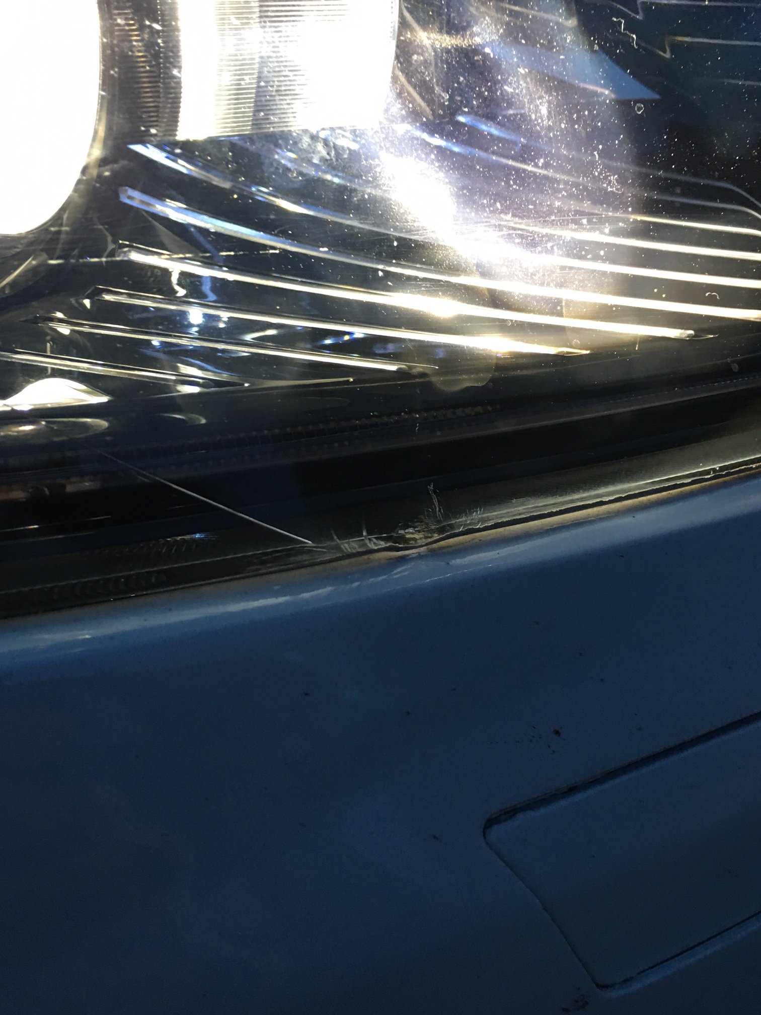

I am starting to really dislike my LED DRLs! After a bash last year my headlights started leeking and shorted out. Skoda checked them and said that it was due to hairline cracks caused by the bash. The insurance company agreed and changed them. last month. They let in water so they changed them again. Last week I caught a metal post in the car park. Minor bumper damage and the pipe to the headlight washer sheared off. All replaced. Everything was working fine. I have had a couple of RH DRL warnings come up. They went away and the light worked fine. Today the DRL went out and would not come back. Strange thing is that I have seen them flash on a couple of times. No water this time as a dry day. You will see on the attached photo that the glass was nicked when I hit the post (The long line that looks like a crack is meant to be there!). It worked fine after water jet was done. I dont think it is fair to go down the warranty route. The headlight is loose so I will be taking a careful look tommorow.
Does anyone know about the electronics within the unit? I am wondering if I have damaged LEDs or whether there is a Ballast or similar that I should try to change? I wiring diagram would help.

I have managed to download the electrical manual that covers the Xenon with LED DRLs. Whilst the left hand side is bumper off, the right hand side is just wheel arch shield out. There is a control module for the LEDs. The fact that it lives under the light and my right hand light unit is loose rather suggests that is worth investigation. This is rather a common one so hopefully I can find a fix as we all start to drop out of warranty. The same unit is a problem on the Audi with J861 controller. Hopefully I can get the part number from the unit.

I thought I would post the solution to this problem. I got some silly answers from some, but nobody knew the answer to this common problem which is occuring with LED DRLs. I got the solution on the Audi forum as it uses the same unit.
It was not the DRLs that were at fault or the knock. There is a DRL control unit underneath the headlight which was the fault rather than the £400 headlight.
I managed to get the part 4GO 907 697 D on ebay for £45 brand new (from Latviua admittedly). Just put it in and the LEDs are fine. The attached photos show the cause.
I hope that this is of use to anyone who gets the same problem out of warranty.
RHS is a 5 minute job via the wheenl arch. LHS is bumper off so not as easy.
Happy to take any questions.
