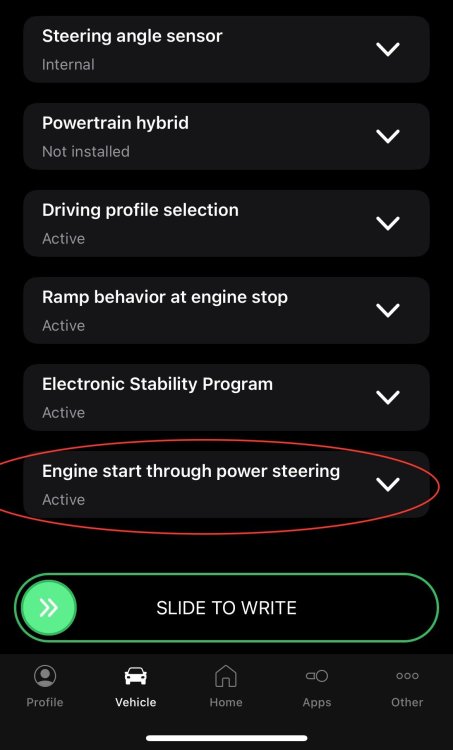

Hi to all, Does anybody know what type of steering system my petrol Octavia III 1.4L TSI 2016 is equipped with? I'm a little bit confused cuz in OBDeleven the steering module reports an "Engine start through power steering" active function in long coding tab. (See photo) I hope you can see my confusion here cuz i though i had an electric steering and im getting this active state of engine start through power steering. Maybe the "power steering" also means electric power steering and it can work alongside with the starter motor to start up the engine. Don't know.

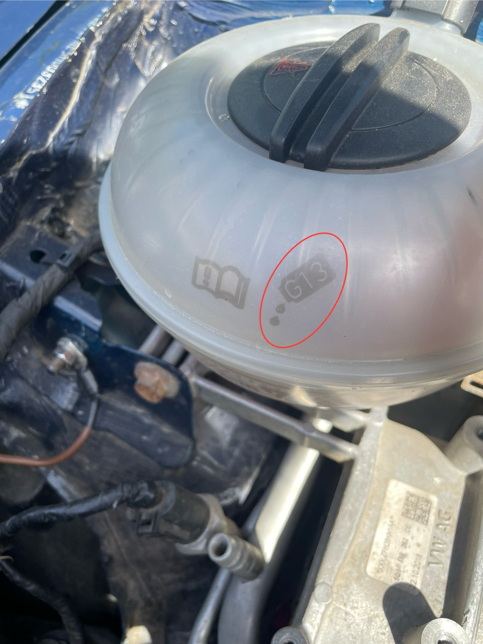

Coolant type
I’m an idiot. The info was in front of me all the time. Is on the coolant expansion tank!!! It says G13. Thanks a lot.
Coolant type
Hi, does anyone know what type of coolant I can put in my petrol Octavia 3 1.4 engine code CZDA? I bought my Octavia second hand and don’t know for sure if they put the correct coolant in the engine. The color is Pink. I tried googling it but no luck. Only confusing comparisons between coolant grades and colors and types and compatibilities. The owners manual and the workshop repair manual is useless. Not saying what king of coolant should I use. Thanks in advance.

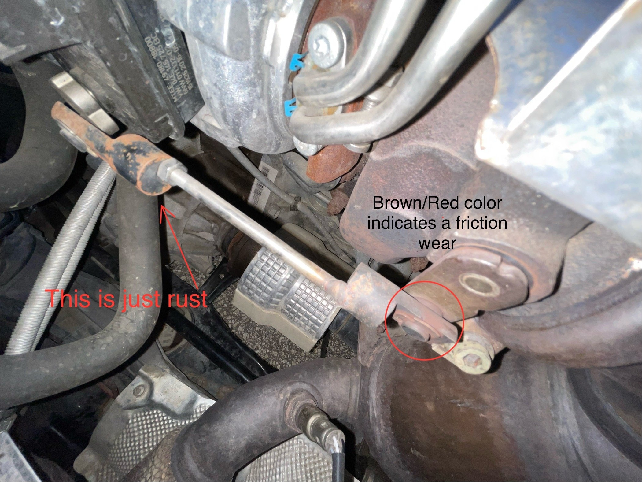

I found the waste gate rod and yes it has a significant play on both sides. I will upload a photo of what am I seeing and a video sample. (See here) My guess is this is just a normal wear of moving parts. This is expected from this type of designs. Now, the fun part is how to resolve this with least effort possible 😁. Any thoughts?
