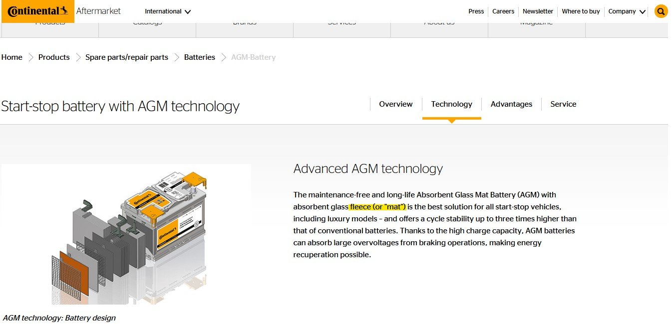

Ok. So the info i shared from a manufacturer's official site about AGM battery is correct or not??? Because for me it's the only official info that i could get that clearly stated that AGM stands for Absorbent glass fleece or mat. At least you can tell that the AGM and fleece is the same thing. Now for the Binary-AGM i'm not sure. The question is how you can tell if your battery is just an AGM, or Fleece or Binary AGM or it's all the same? Does manufacturers label their products with these distinctions? Because if all these labels and types of AGM batteries are different things then there should be a clear distinction between AGM technologies and should be labeled accordingly in the product. For example: BOSCH S5 A08 70AH 760CCA AGM, or AGM-Fleece, or Binary-AGM! I can't really understand how your reference can answer these questions, just because it's from just another forum, from a youtuber and from a yuasa manufacturer ,which by the way in your reference on bullet 2 does not specify the difference between AGM batteries technology itself, just comparing and explaining the difference between AGM and Standard led-acid batteries? Please excuse my bad English. I'm not a native speaker.

Found some sort of information on how manufacturers describe AGM battery technology. Pretty much they stated that AGM= Absorbent glass matt or fleece. See screenshot from the Continental's website: Here is the link as well: https://www.continental-aftermarket.com/en-en/products/spare-partsrepair-parts/batteries/agm-battery

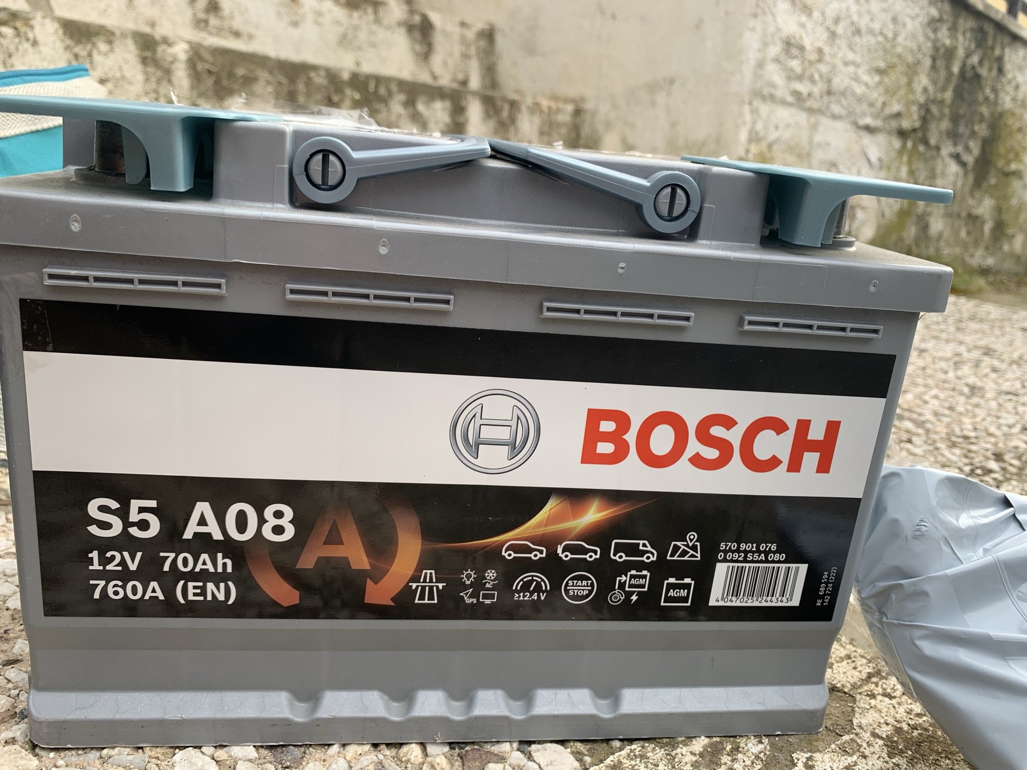

Done! Adaptation accepted. Can you tell what's the difference between Binary-AGM and Fleece Battery? In drop down menu i get also battery type "Binary - AGM". My battery is BOSCH S5 A08 70AH 760 CCA AGM rating. It does not say Fleece. I selected the Fleece option though.

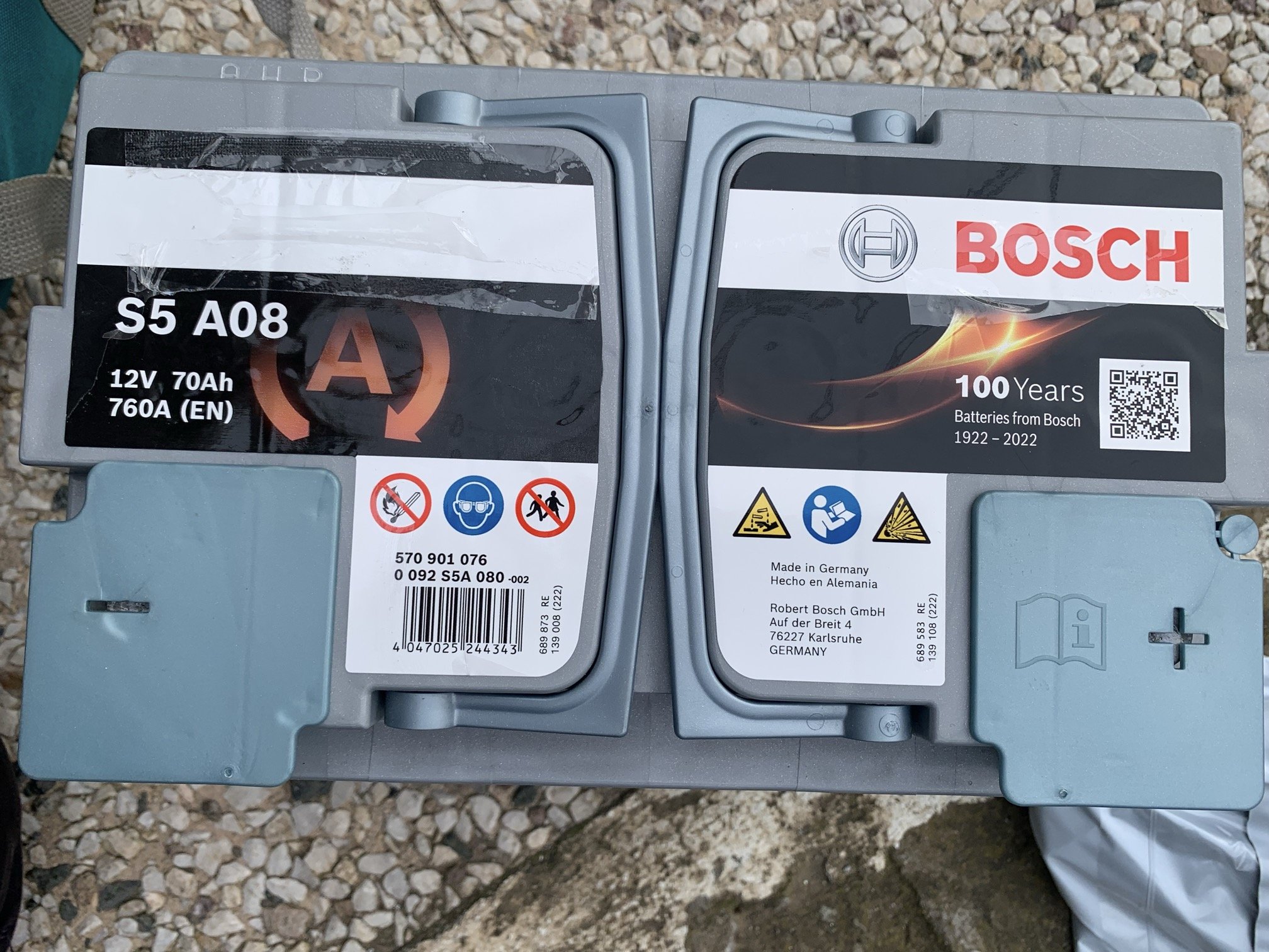

Not yet cuz i cant really understand which one is the serial number on the battery. I will upload 2 photos of the stickers that is on the battery. If you can recognize which one is the serial number please repost. Thanks.
