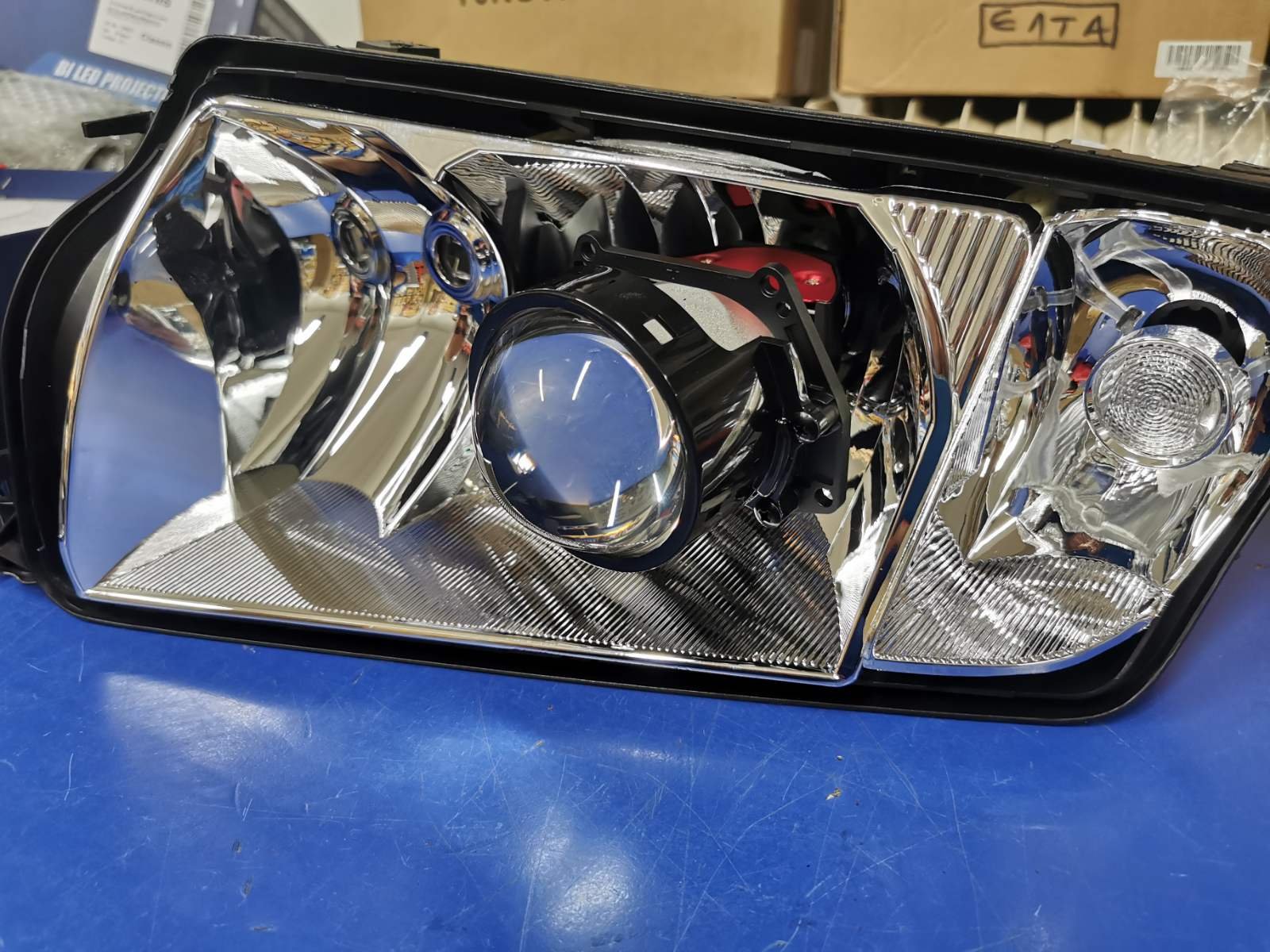

  1. Dear Phill.. I think i something wrong here.Your car before has xenon headlights?And after repair,they put Halogen headlights for low cost? If your headlight take H7 bulb in main beam its not fit other type of lamp like the last photo.You need to buy a universal ballast with H7 xenon lamps. My Fabia is 2001 sedan, and i cut the back of reflector and i put the bi-led projector with screws.Is a very dificult procces. This photo,i put the projector with H7 bracket to drill holes for aligment.After i cut all the back of reflector,to going more deep because no space to close the headlight.
  2. I dont understand,you have projector with h7 socket.How you put ds1 bulb?with adapter? In fabia yes he has medium and High beam.The high beam is open inside in projector ,when takes 12v from high beam. Look at this photo.I have installed only the left headlight fort test..In right is headlight with halogen h7.
