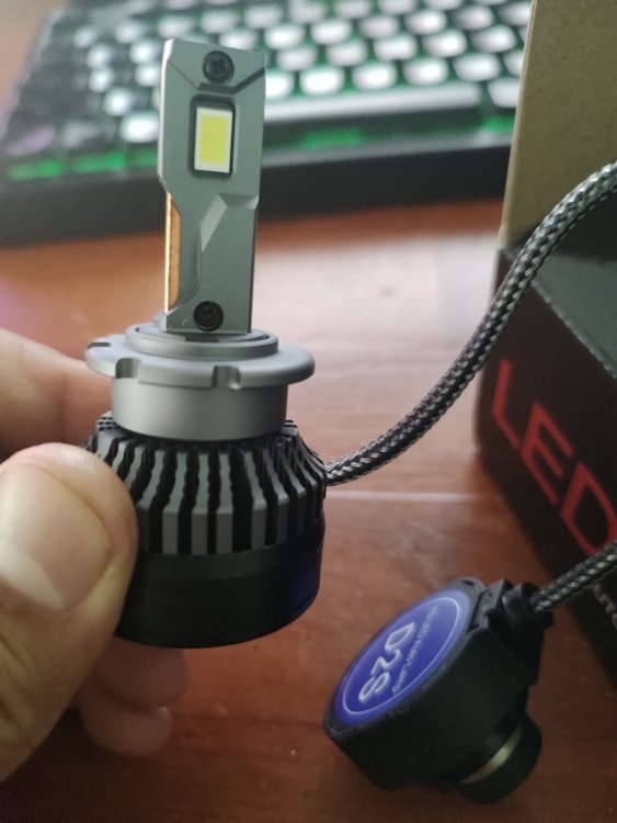

Everything posted by Techktonik

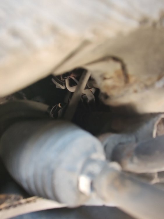

  6. So today I layed under the car and checked the cables for the lambda sensor, covered the good ones with insulation tape and the rest two as well separately. The best solution might be to cut off the cable and re-solder it, but anyway it fixed my problem. Despite the fact that it was a little struggle, connecting disconnecting I also cleaned some cable plugs with contact cleaner in the meantime. So I wanna thank you guys for your help appreciate it @Breezy_Pete @Crasher 🙏 🙂
  7. Ok, will check it thanks, Do you have some schema to find where they're connect to unplug them for example could be the one on top of the engine not under the car

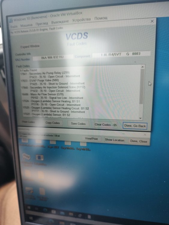

  9. Ok, tried dissconnecting the charcoal filter purge valve and same story Need to check MAF sensor or most likely this secondary air inlet valve (by lambda sensor heaters I don't know never got a sign for it)
  10. So I've went out in the morning to drive a little bit and without the relay again the fuse blown, but I noticed it when I started the air conditioner and few minutes later it blow it so will continue testing the rest parts by disconnecting one by one.. Charcoal filter purge valve Secondary air inlet valve Both lambda sensor heaters MAF sensor.
  11. Today with a friend we opened the seconday air relay and tested it looked okay in terms of measurement. But we also saw some dark spots on the relay box like dust left and he suspected this relay. So we removed it and I drove the car for about 30 minutes and the fuse had not blown, guess it could be that one or else I need to test with the relay inserted to be sure? On the VCDS only relay j299 was shown as not working and on the dashboard this sign for ASR was shown. I'm planning on purchasing a new relay and see if the problem will be resolved. Other than that car is running normally even I pushed it a little bit more and no check engine

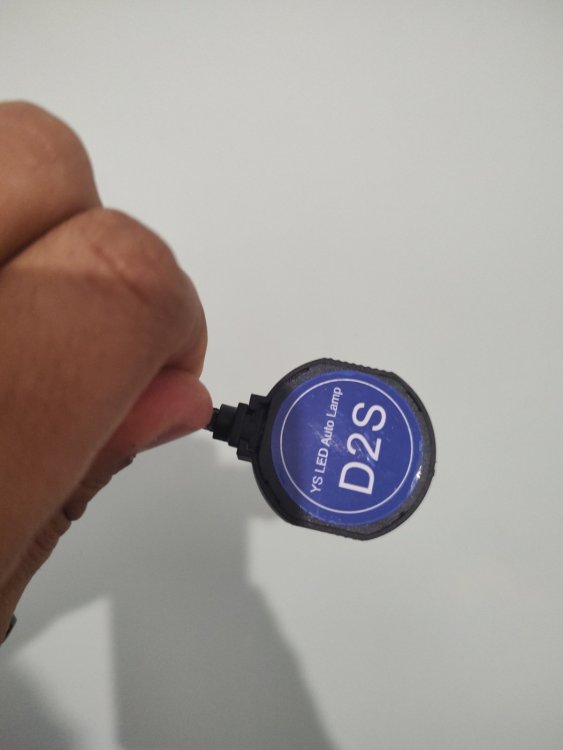

  15. here's link to the product: https://www.aliexpress.com/item/1005005244903986.html also the car is Octavia 1.8T 2003, thanks in advance
  16. Hi Guys, I'd like to ask if somebody successfully replaced xenon bulb with led bulb. I've bought these for direct swap, but when I try to start the headlight it turns off automatically. Also I haven't cut any cables or so, just replaced the bulbs by using the original ballast. I guess I might be supposed to some other changes or buy another workings bulbs. Any help appreciated!
