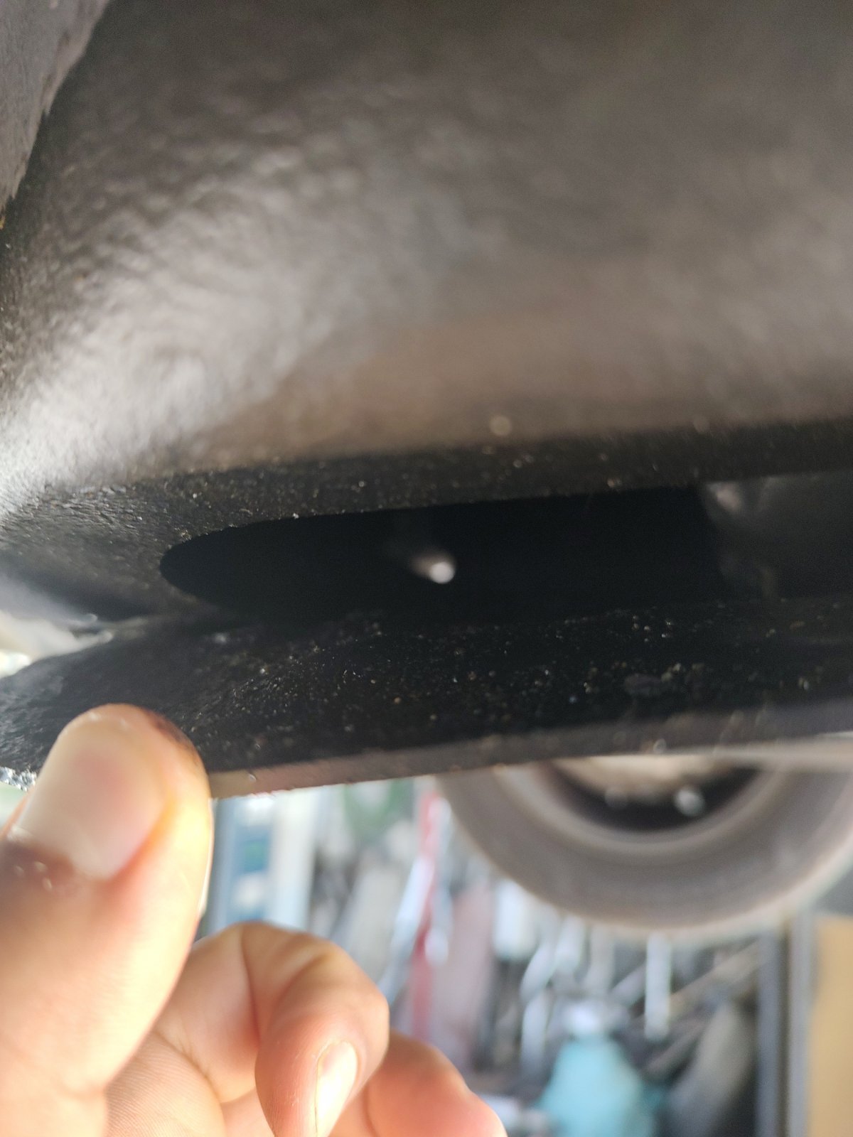

  4. Hi guys, It's me again, couple months ago I've replaced the rocket cover gaskets on top as was having oil in the spark plugs. However I've noticed still I have to put some oil in the car for example 100-150ml per 500-600km. I've inspected the spark plugs and top of the engine no oil leak. But on the bottom side will have to remove the plasic cover under the engine, but on the right side it seems to me like the leak. Any suggestions on this? I drive with 5w40 oil, but push it from time to time when accelerating Also no smoke while driving or on starting, what I have noticed is that when the car is warm, sometimes it struggles to start from the first or second try (it has an lpg system) but when hold cranking it longer it start Thanks in advance!

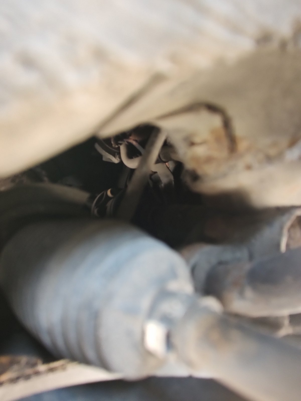

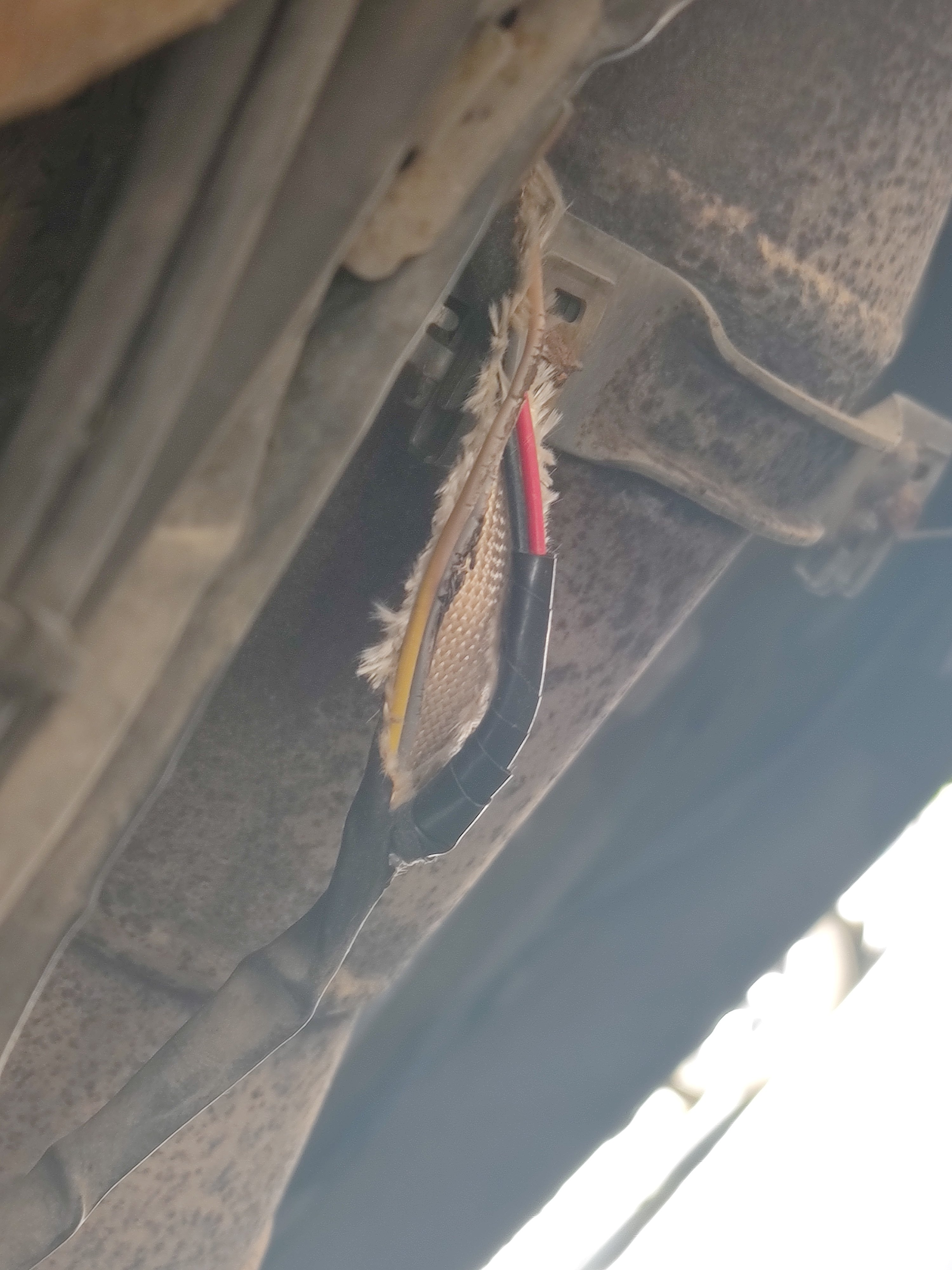

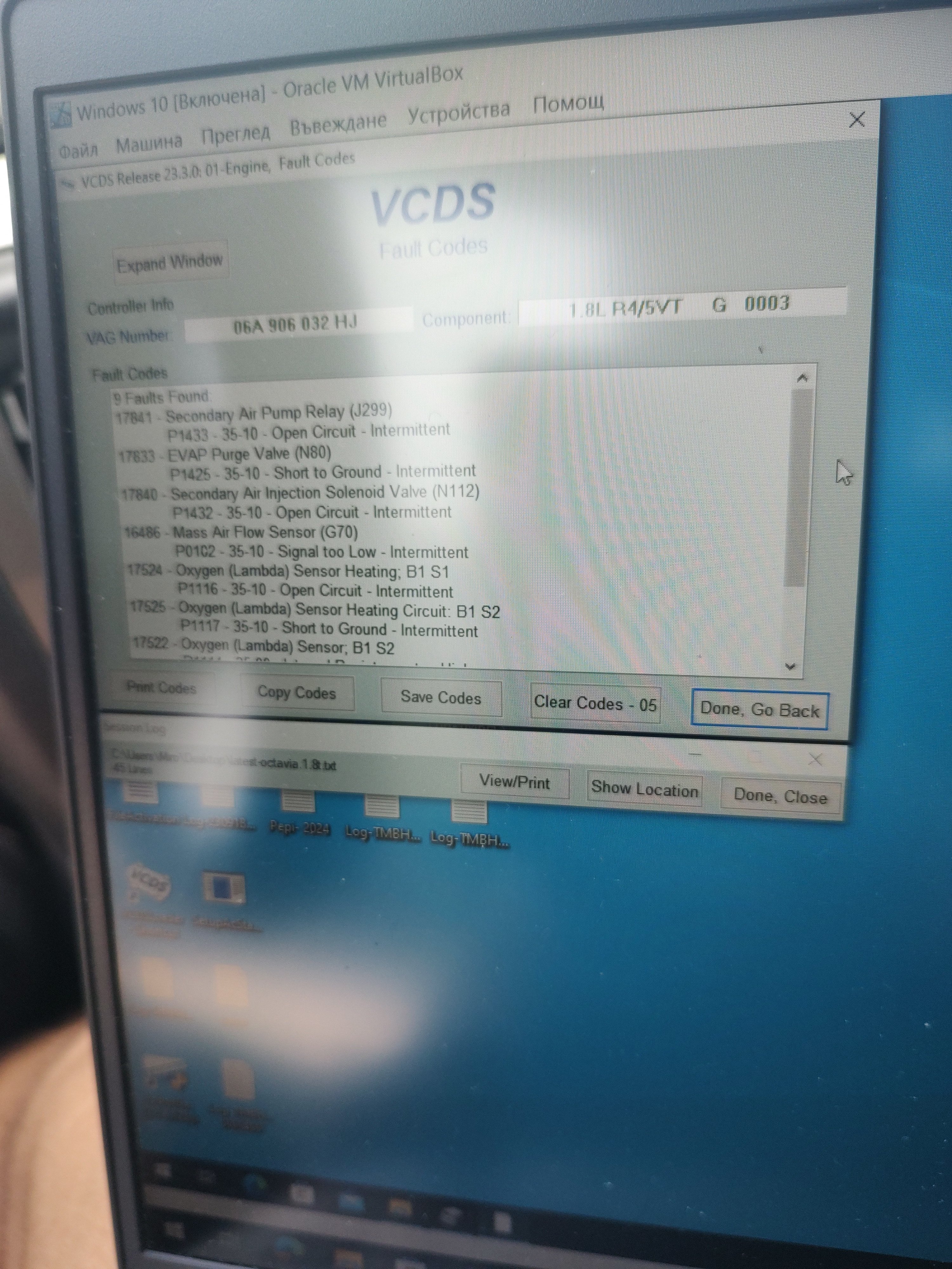

  6. So today I layed under the car and checked the cables for the lambda sensor, covered the good ones with insulation tape and the rest two as well separately. The best solution might be to cut off the cable and re-solder it, but anyway it fixed my problem. Despite the fact that it was a little struggle, connecting disconnecting I also cleaned some cable plugs with contact cleaner in the meantime. So I wanna thank you guys for your help appreciate it @Breezy_Pete @Crasher 🙏 🙂
  7. Ok, will check it thanks, Do you have some schema to find where they're connect to unplug them for example could be the one on top of the engine not under the car
  8. Pff this is strange, disconnected everything except (lambda sensors) started the car started A/C and the fuse again blown maybe I have to look for a technician
  9. Ok, tried dissconnecting the charcoal filter purge valve and same story Need to check MAF sensor or most likely this secondary air inlet valve (by lambda sensor heaters I don't know never got a sign for it)
  10. So I've went out in the morning to drive a little bit and without the relay again the fuse blown, but I noticed it when I started the air conditioner and few minutes later it blow it so will continue testing the rest parts by disconnecting one by one.. Charcoal filter purge valve Secondary air inlet valve Both lambda sensor heaters MAF sensor.
  11. Today with a friend we opened the seconday air relay and tested it looked okay in terms of measurement. But we also saw some dark spots on the relay box like dust left and he suspected this relay. So we removed it and I drove the car for about 30 minutes and the fuse had not blown, guess it could be that one or else I need to test with the relay inserted to be sure? On the VCDS only relay j299 was shown as not working and on the dashboard this sign for ASR was shown. I'm planning on purchasing a new relay and see if the problem will be resolved. Other than that car is running normally even I pushed it a little bit more and no check engine
  12. Oh, in that case I'll have to measure those things. When I first start the car while fuse not blown yet, I hear the auxiliary heater for a minute and then stops. But when the fuse blown its like entire car shut off for a second and come back. I wonder how can I found where exactly is the problem but guess can buy some shortcut tester and try with it. Thanks 🙏
  13. Hi guys I have a weird problem. When I drive the car for about 20-25mins it blows number 43 - which points to engine management. It's strange that it doesn't blown straight, but after some time driving and it drives me crazy. Any suggestions on how to fix it?
