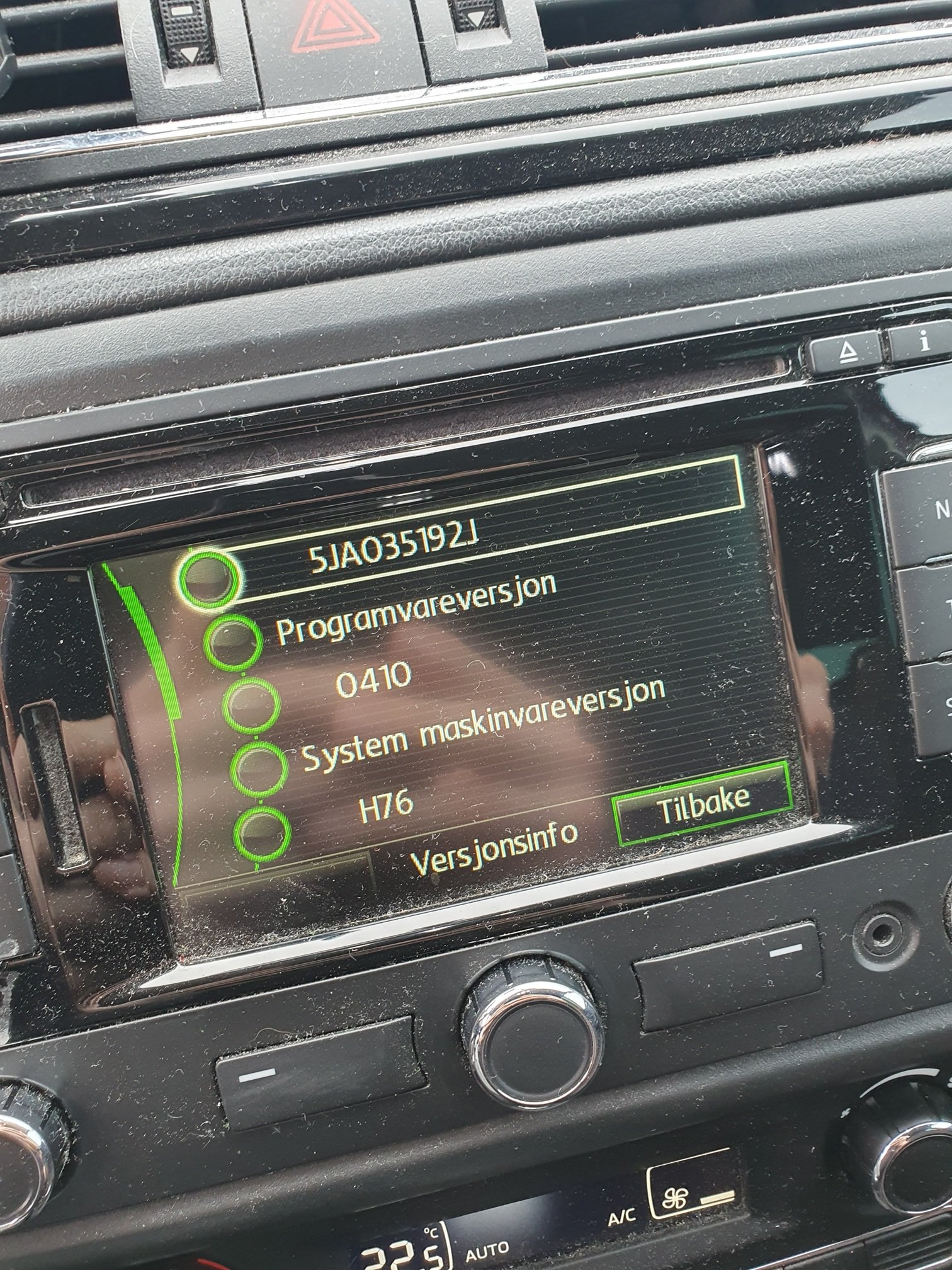

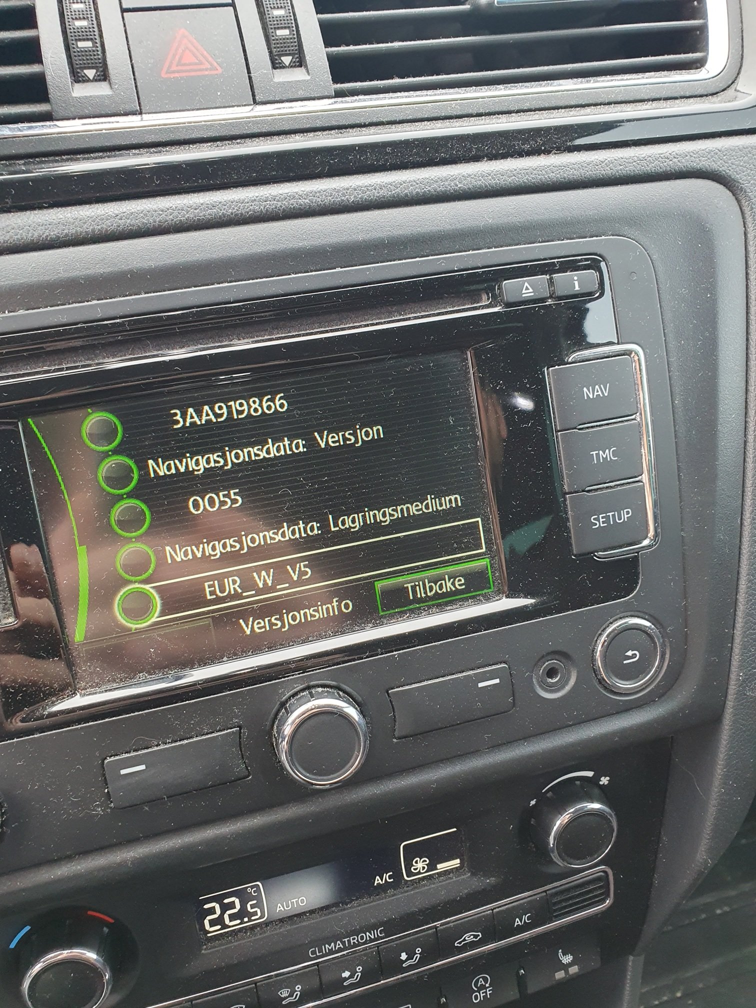

So. I've been looking around, trying to input any of my info on MIB-helper, to find newer software for my Skoda Rapid. But i think this is not a MIB-system? The radio has a few Bluetooth connectivity bugs, and i suspect it might be on original software. Hoping an update can fix it, but i simply can't find any information on this for my system. My system language is norwegian, sorry, see attached photos. This is the info in the photos: 5JA 035 192 J software version: 0410 System firmware version: H76 Nav Map version: 3AA919866 Nav data version: 0055 Nav data media: EUR_W_V5 I think this is the Amundsen (+ ?). Is there any places to download newer software, if available? Maybe there is a guide, or any info on this system somewhere on the internet?
