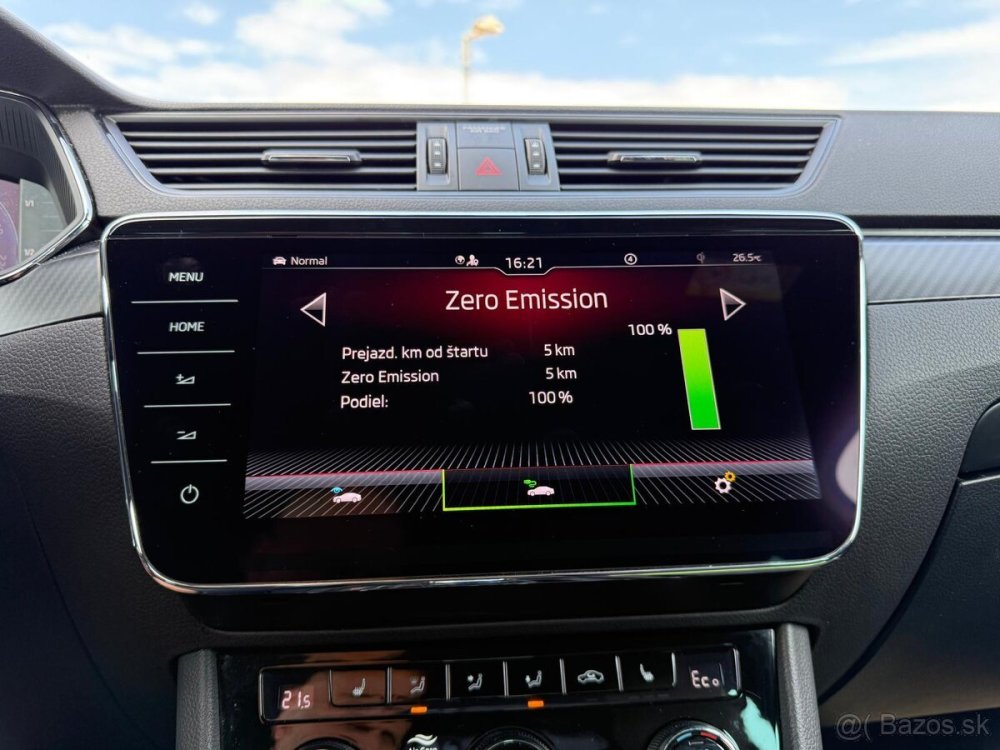

I also recently updated the OCU to 0143 and the MIB from 270 to 332 (gradually - 278-308-330-332). VCDS does not show any errors, but the zero emission item disappeared from the "range monitor" menu (similar to the one in the photo, I miss it). Has this happened to anyone else?
or ideas on how to get it back? I compared the current adaptations of the 5F unit with the statement after buying the car and I did not find any differences...
PHEV 2021
Edited by wirer
Yes - the Zero Emissions screen has gone for me as well
Has been mentioned elsewhere too - looks like its part of the update to one of the later softwares

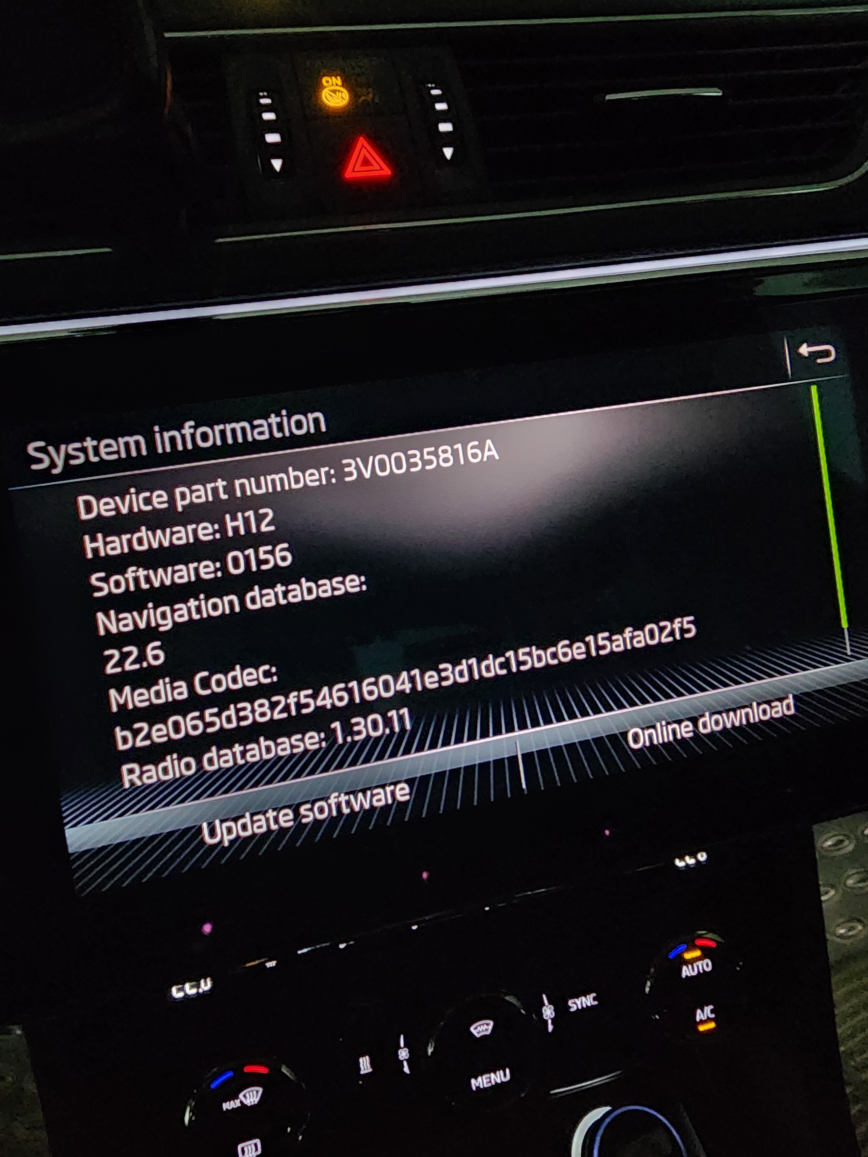

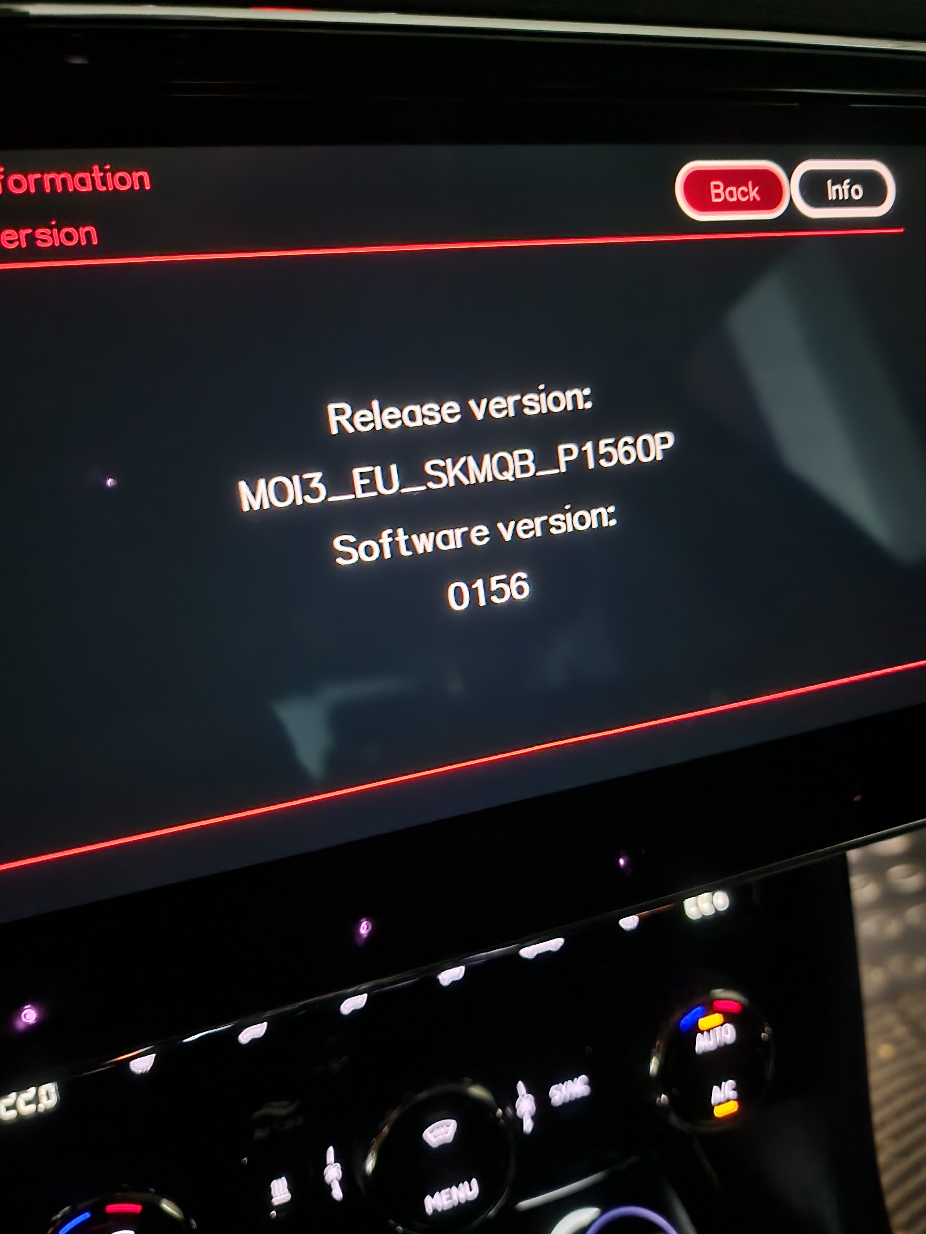

Hi can you help me update my superb iv 2021 mib3 my navigation dosnt work in my country i want to update the mib3 map the car is from cezech only eu map i need middle east . How can i do it do i need a swap code dont need can i download it . Do i need a obd
Update version please to what number what do i need to do
Ok that’s very very old software. 332 is the current (and possibly won’t be updated past that tbh) but it went (I think from what I’ve seen) 156 236 270 276 278 306 308 330 332.
The one you’ll absolutely need is 308 but you may need something before. The other thing is there’ll be FEC codes needed too. Tbh whilst you can do it, I’d say best to get it to a dealer, explain the situation and ask them so they do all the associated work to it as well.
