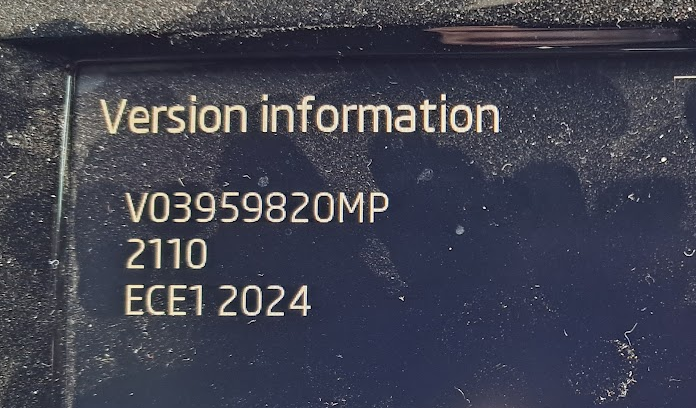

I've loaded the updated version - as expected this has not solved the problem; I still cannot see village names. I am still trying to figure out why Warrior193 is able to see the 'Blidworth' village name on Ver. 5L00051236DH - ECE AS 2024, which I think is the all Europe map: Does that ECE AS 2024 map contain more information labelled in a different way to ECE 1 2024 (I would give it a try but I only have a 16GB SD card) - is it worth me trying that card?? Could it be that the MiB2 firmware I have in use is the problem, and an upgrade will sort the issue? Can most people see village names - is it just me with the problem?

I will have a look at tomtom for interest, however the real reason I wanted village names is for when we are going on long trips - so not much use if I have know where I am going and have to add the names a year in advance😀 However that does not explain why Warrior193 is able to see them on Ver. 5L00051236DH - ECE AS 2024, which I think is the all Europe map: Does that ECE AS 2024 map contain more detailed information than ECE 1 2024 (I would give it a try but I only have a 16GB SD card)? Does the MiB2 in use have a different firmware version? Thanks Steve

Thanks for your help The map version number looks different to what I have, which I assume is ECE 1 2024: I downloaded this from: And this is the mapping I am getting, as you can see, a name for Ravenshead, but no village names for the two villages on the right (Blidworth and Rainworth), the villages are not labelled at any level of zoom Is ECE AS 2024 something different?
