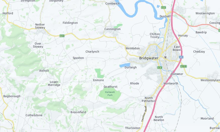

Also,  MapCreator is a product of "Here" maps.  If you go over to Here maps at https://mapcreator.here.com/ and look at the maps - voila - the villages are all there.  Assuming it is "Here" they are talking about then its not the maps its the conversion of the maps to the VW format that is the problem.   Probably a blasted entry in an XML file to toggle village names on / off or something as simple and daft as that.   The XML file could be on the SD card we all have or it could be on the application that VAG map folk use to generate teh maps from the master map.
This is the here map of a random place in the UK. notice all the lovely little villages:
Yes, since no sane person would decide to exclude the names, it must have been a mistake made during the update process. What is simply daft is Skoda's refusal to investigate and solve the problem.
Maybe you could get back to them and explain that they have not properly understood the issue.  From their reply it seems they think you are complaining about a place or road etc. missing from the map.  This is not the case (as we know) but its more a case of the names are just not dispalyed for any village under a certain size at a particular (probably all) zoom levels. They just didn't get that at all.  If you explain that the villages are there in the database (i.e. you can search for a village in the address section) and then also show them an image of the older maps showing the village names and the newer maps not showing the village names at all then they might actually get what the real problem is.
I have the new maps still installed on my unit so if you want I can pop over an image of a certain area "not showing the village names" and you could then so the same with your older maps showing all the village names.  For comparison you could also send them an image showing all the village names of similarly sized villages in France or somewhere where it is working correctly.  you could also clarify with them that is is in fact "Here" maps they are talking about and show them that the data is on the master map as above.
If you guide them slowly through the actual problem then they will eventually understand it and will then be able to pass on the "actual" problem to the developers.  they will then have a chance (the developers) to address the issue, if not now then at the next map update. I'm sure they will - they just don't yet actually get what the problem is.  The MapCreator program they talk about is for anothr thing entirely.  that is to correct the names of roads or inform the mappers that a road junction is wrong etc.  it is not to get all the smaller places show up on the map.  Wrong tool for the wrong issue.
