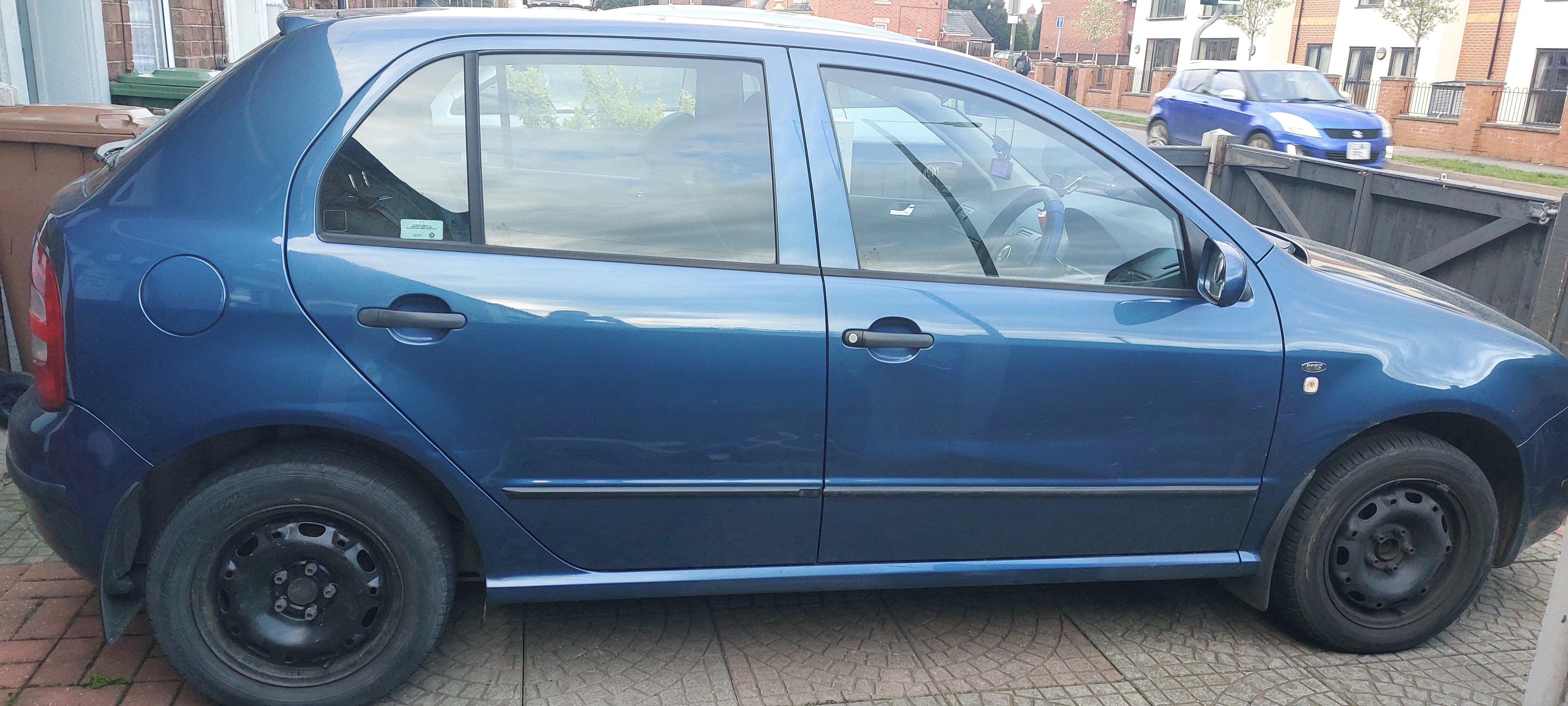

  10. Hi there I have a skoda fabia comfort 2003 for several months the power steering light has been coming on for shorts periods of time steering was still fine but as of the last week it has pretty much stayed on, the steering is OK upon having to make a sharp turn or turn around it becomes heavy. I have charged the battery fully, and that seems OK. The light was still on. I've also checked the level, it was slightly low. I have topped it up and checked it daily, and so far, it's still ok. So what I've read it could be connections, battery, or the pump itself, does anyone have any input on what it could be or advice on where to start looking. Thanks 🙂
