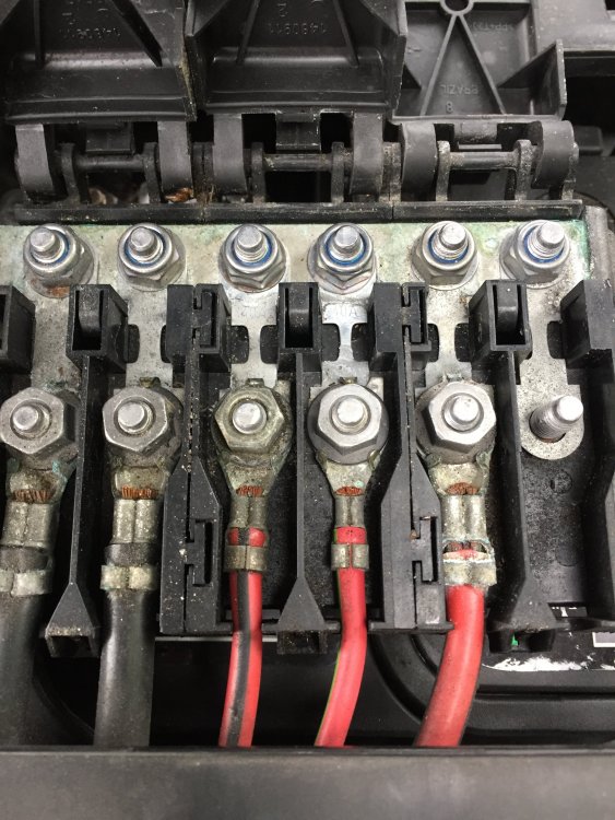

    Try to get (and post) a nice, sharply-focussed photo of the strip fuses in the holder above the battery. Sometimes a near-invisible hairline crack in the power steering one can give such symptoms.

No, the all-metal strips that the four or five thick wires connect to, nearer to engine on that fuse board. It's not obvious that they are fuses, at a glance.
  • Sponsor
These. I think power steering is the fifth one from left. Thicker of the two red/black wires goes to it.
  • Sponsor
That's them. Looks like some previous bodgery at  positions 5 and 6 with wrong-fitment fuses, but your power steering one looks to be in position 3 from left.  See if you can get a sharper pic of just that one. I think I can see a hint of a line across it very near the middle of the necked bit.

Yeah, good pics, but still can't really see if there's a crack there.  May be worth getting a pack of assorted fuses from Halfords, which will include a 50A one which is correct for there, and hopefully a couple of 40A ones which would suit where the two ill-fitting ones have been put.
Halfords Assorted OTO Strip Fuses 30>60 Amp (FUSE133) | Halfords UK
Could use a 30A one for  the fans which is position 5 on your fuse board. Looks like there's only one of each value in the Halfords variety pack.
On second thoughts, leave the bodged ones as they are, if there's no problem, don't fix.
