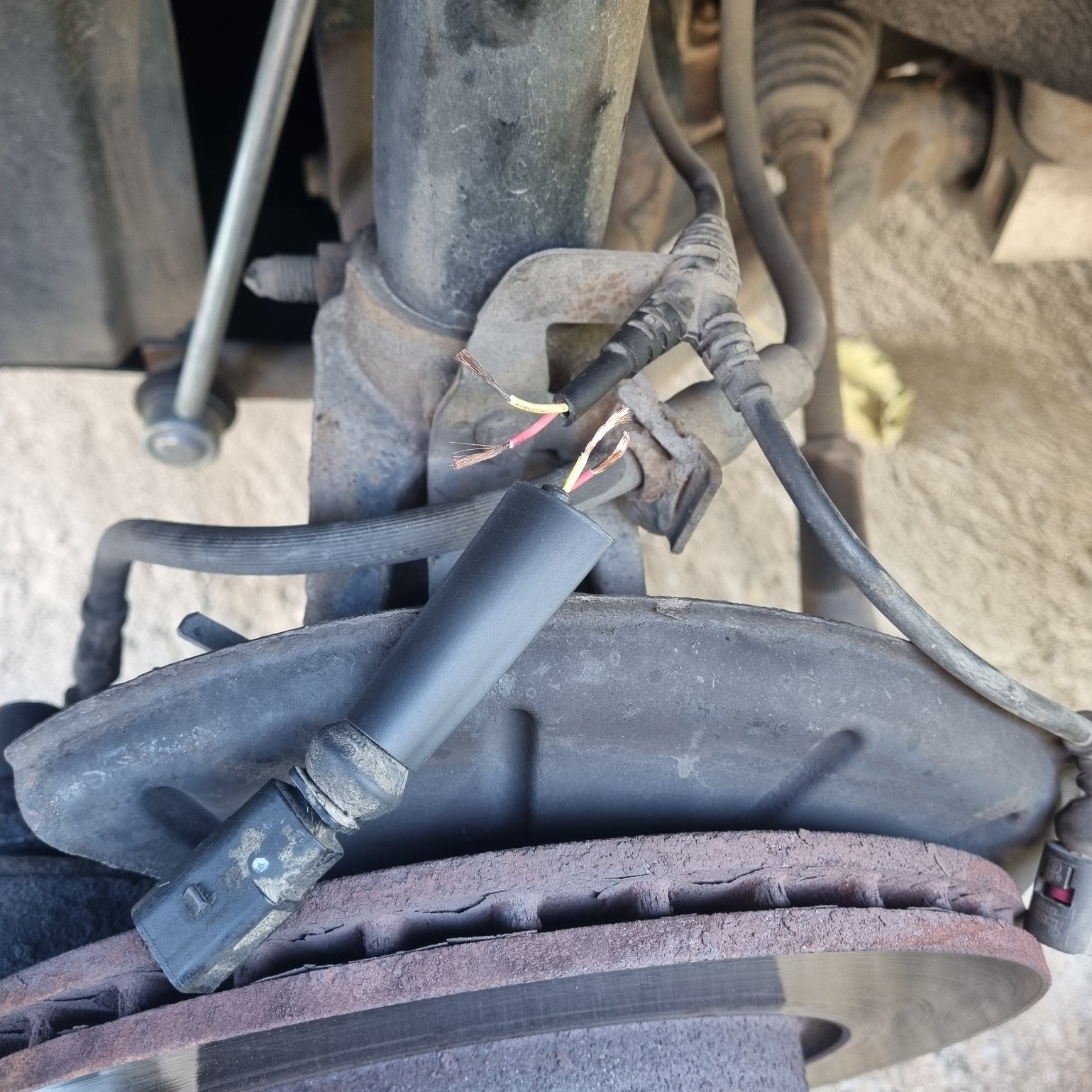

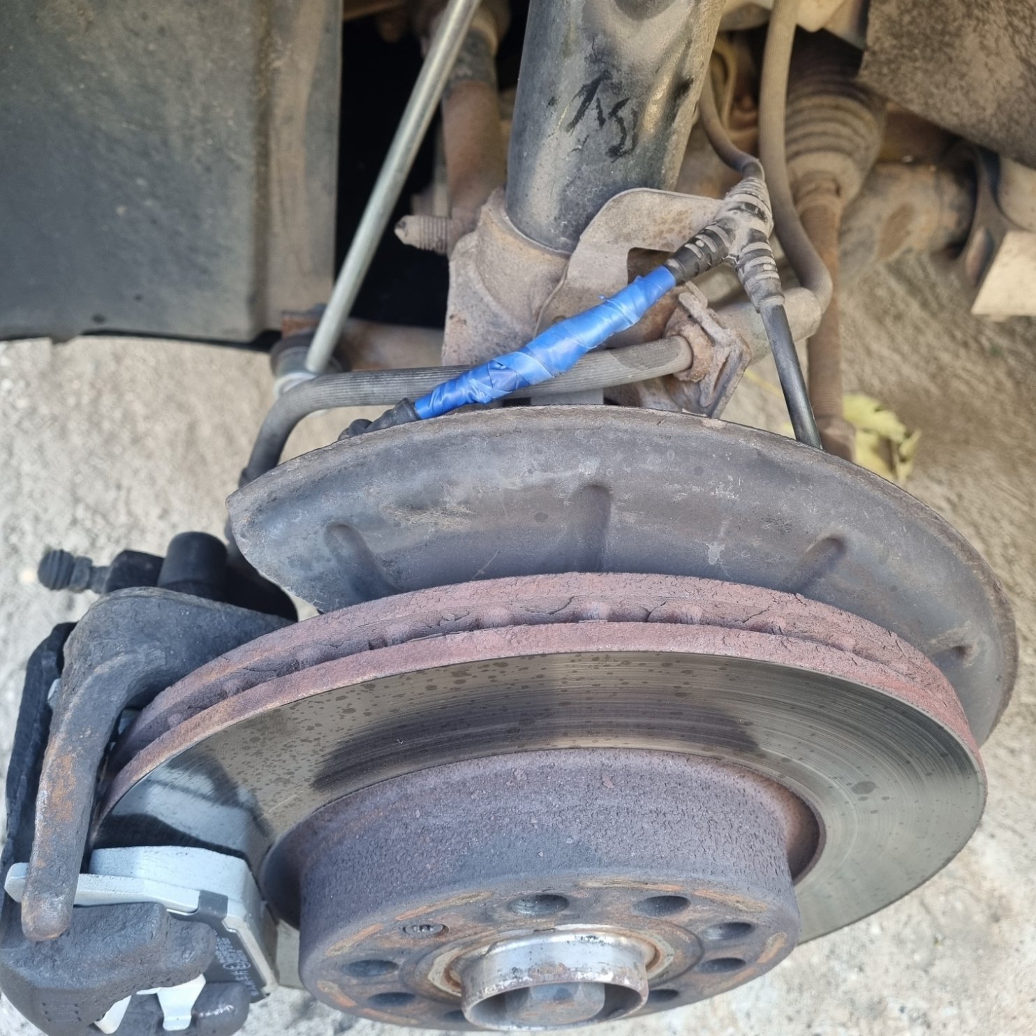

  10. That's what I did, lil bit of flux, heat up the wire, coat in solder, wait to cool, insulate. The wires themselves seemed fine though, I thought the 'corroded' part you saw was just glue residue because it was sticky, cleaned with isopropyl and looked brand new, orange copper.
  11. Well.. that's kinda what I did I bought something similar to the second link but used, from a parts octy, since I can't find new in my area Twisted them wires together, added a bit of solder, rubber.. shrinky thing on top, heat up, add some electrical tape as well (didn't have black color, hope that's not why it's not working), better safe than sorry, no change 😞 Ignore my crapped out disk, it'll go to the bin soon enough
  12. Octavia 2 Facelift The previous owner decided it's cheaper to just cut the cable of the plug for the brake pad wear sensor and glue it together than to buy new brake pads. Fast forward to today, I stole a plug from a crashed octy and tried my best soldering the new plug onto the old cable. Fresh brake pads, contact, oooo no error light. Drive a bit, damn light popped it's head up again. Now I'm wondering, maybe there's some way of resetting the brake pad wear sensor error thing? Because the other alternative is that I'd have to hire an electrician to do a proper solder job for the plug and my wallet wouldn't quite like that.
